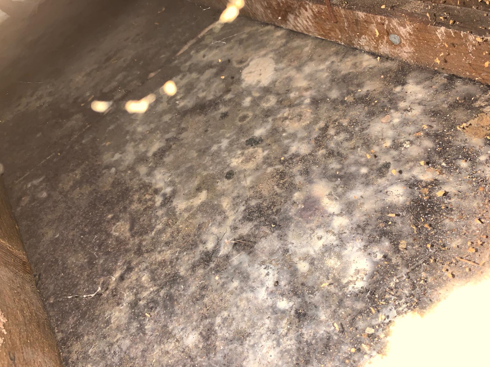

Hi
Having my house rewired at the minute, the electrician has lifted floor boards and in one room and there is mould visible on the plasterboard below.
There’s no visible signs of any water leakage and it’s only in the one room (rest of house looks fine)
The house did have a slight smell but we assumed it was due to the previous occupants dogs
Any idea what it could be? Being a weekend not been able to get a hold of someone to come and look just yet.

Possible to be a previous water leak?
Failing this it could be a condensation issue, but wouldnt be first guess due to location - is it towards an external wall?
that's pretty bad, and enough mould to look like long-term damp rather than a one-off overflow.
Is it near a bathroom? Or radiator pipes?
Bay windows can leak, as can downpipes and gutters.
More rarely, a disabled person may have a commode or other device, but you would notice the smell.

Trying to find out if there has been leak previously
yes it close to an external wall and near a bay window
I thought that, just awaiting some mould and damp guys to call me back
It is next to the bathroom, was unable to look in there as all the tiling will need to come up to look under the boards
It’s close to a radiator and the bay window
There is a urine like smell now however we didn’t really notice it until about a month ago but with the flooring up it’s horrid
It is next to the bathroom...There is a urine like smell
pretty sure to be a leak on the WC or soilpipe then. You need a plumber, not a damp man.
The tiling will have to come up, and the floor beneath may need replacing.
