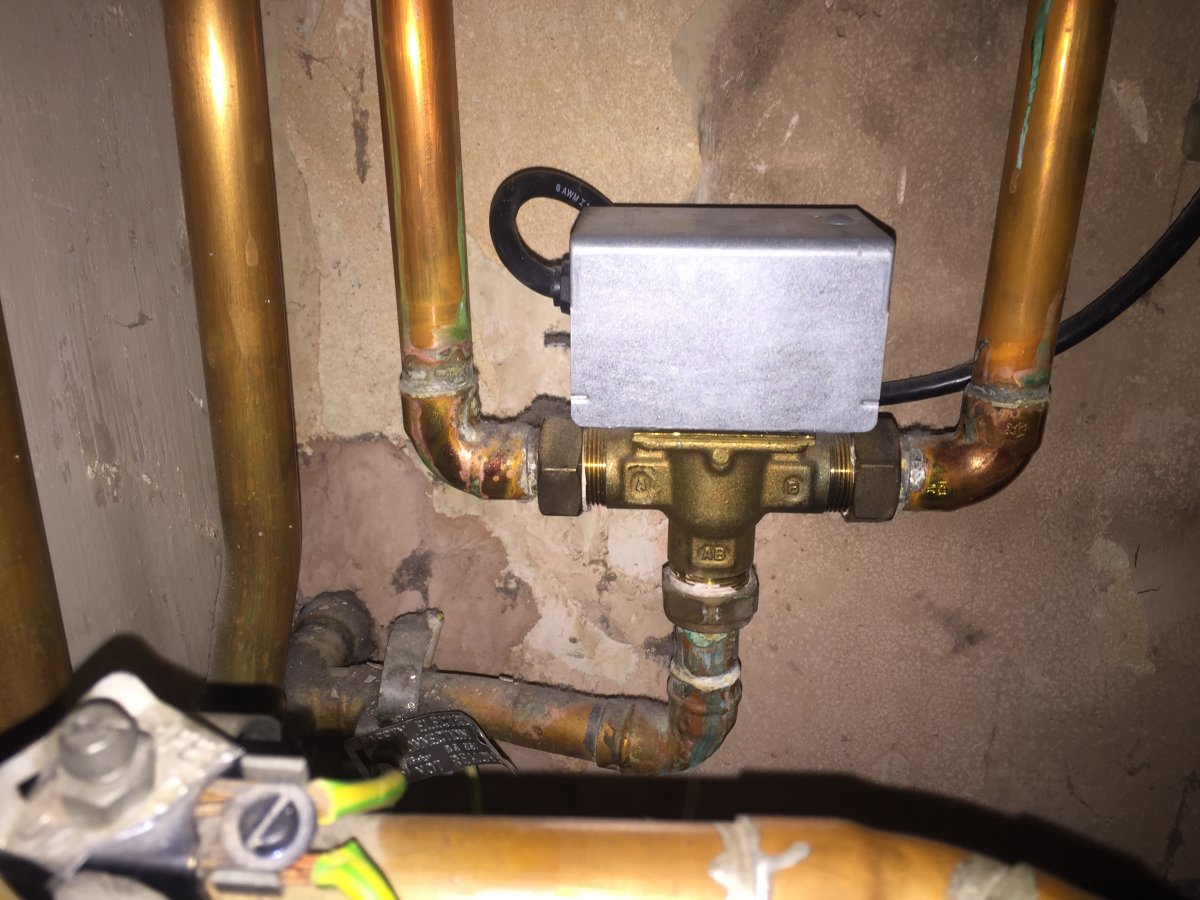

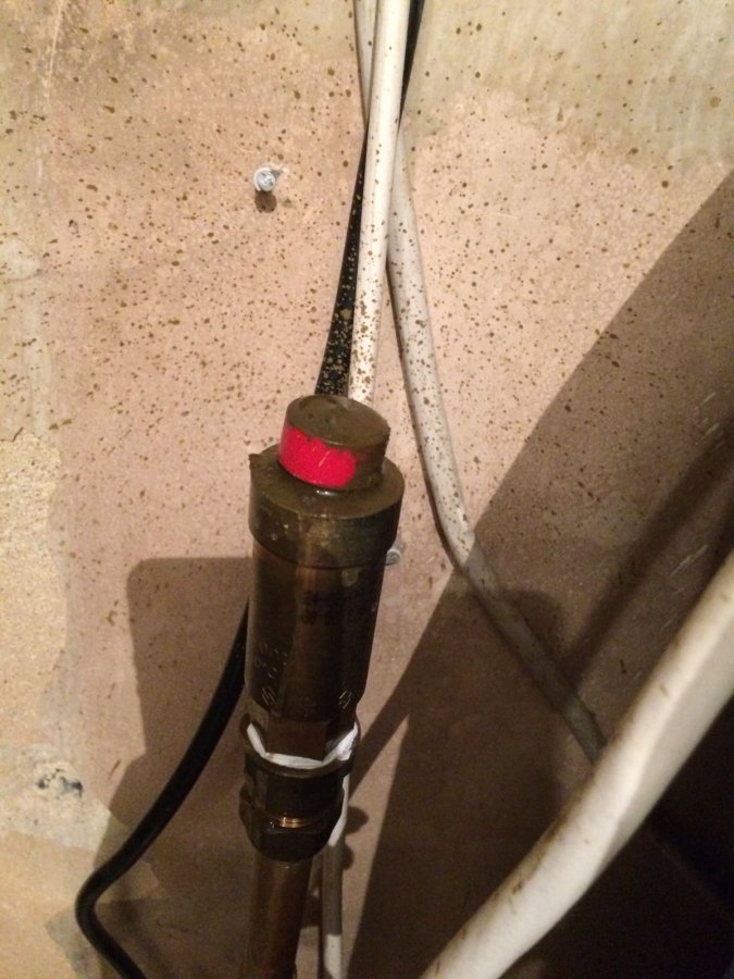

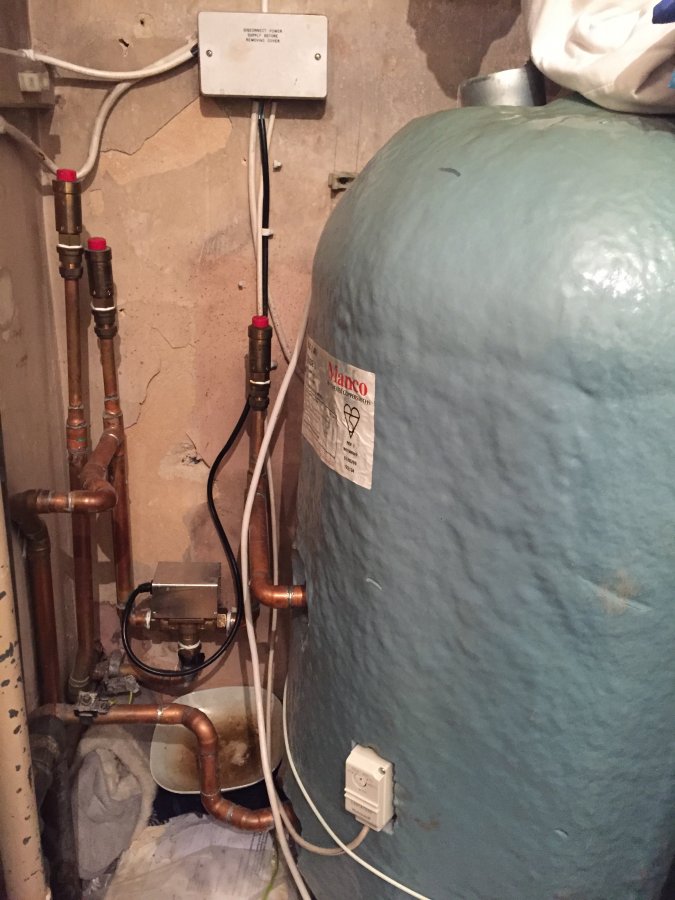

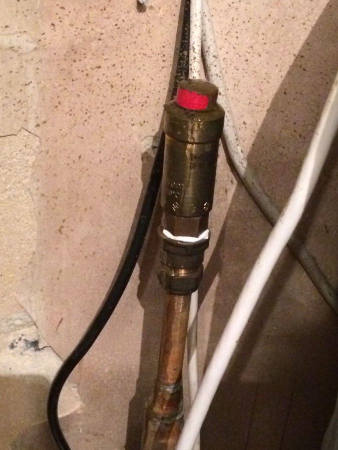

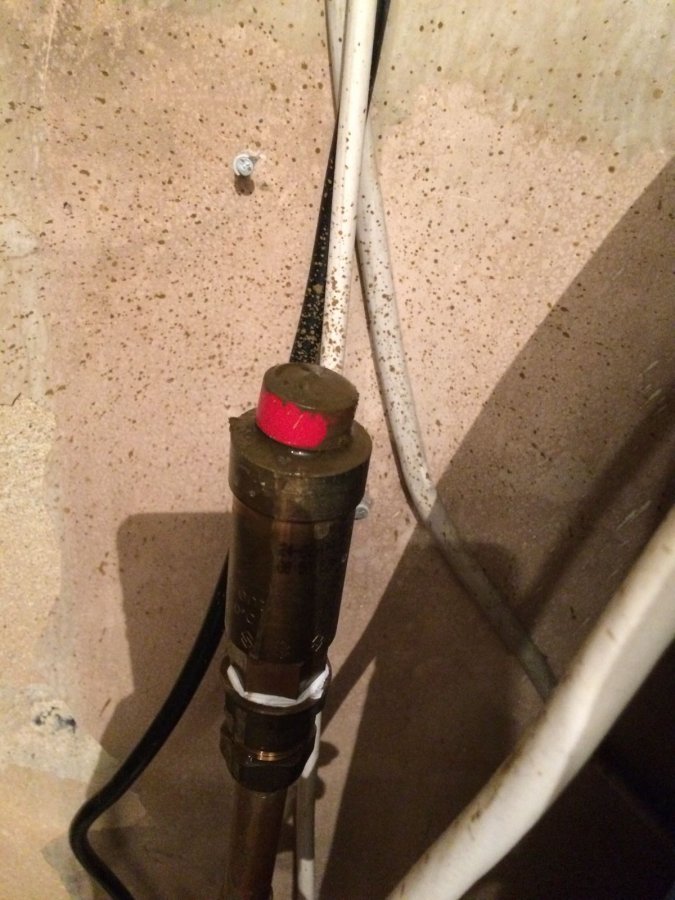

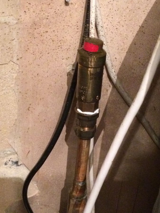

Hello,
I have a water leaking from where the pictures are (pls see photo attached)

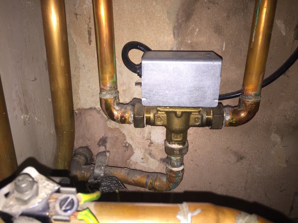

I am at work but my partner mentioned water gushed out earlier from those points. I have had minor leak below the valve what you see in last photo and placed a small bowl below it but last two days I checked and emptied the bowl full of water and today when going to work I told partner to keep checking it and empty bowl if it fills up. So she called in little panic that she saw water gushing out from the pole with the red top in picture and some dripping from valve ( although few months ago i installed that valve and I don't think I placed the white tape well)
Now two weeks ago I started a new thread called water tank not filling up. Well we had a guy come in and he did some repairs to the ball valve of the water container and that meant water started filling up and we could have our pumped shower. So whenever some one having shower we could hear water filling up in the tank.
I hope someone can shed some light, wisdom and experience of such incident.

Before there is 3 pages of going back and forward, the best thing you can do is call a plumber.
Andy

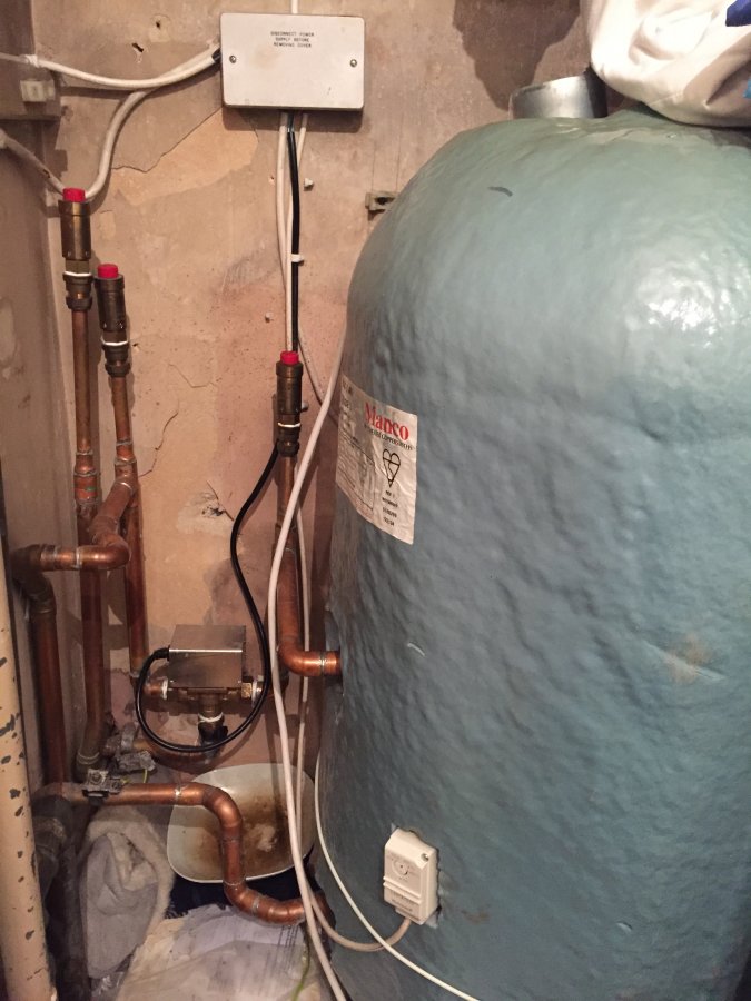

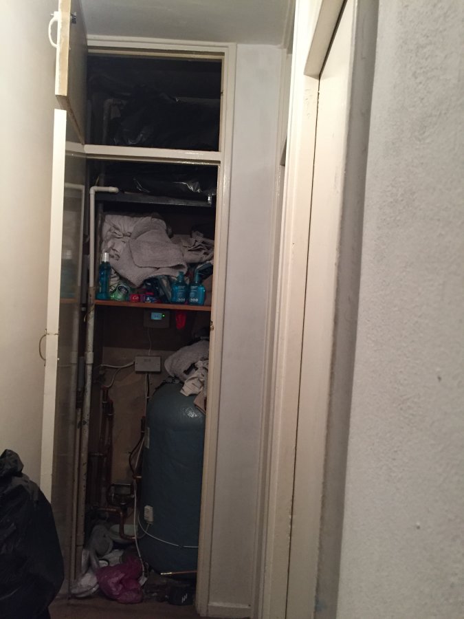

Here is another pic. It's coming from hot water cylinder
The red topped things are auto air vents.
They often leak.
But temporarily can be tightened up to stop the leak until a plumber can conveniently attend.
Tony
