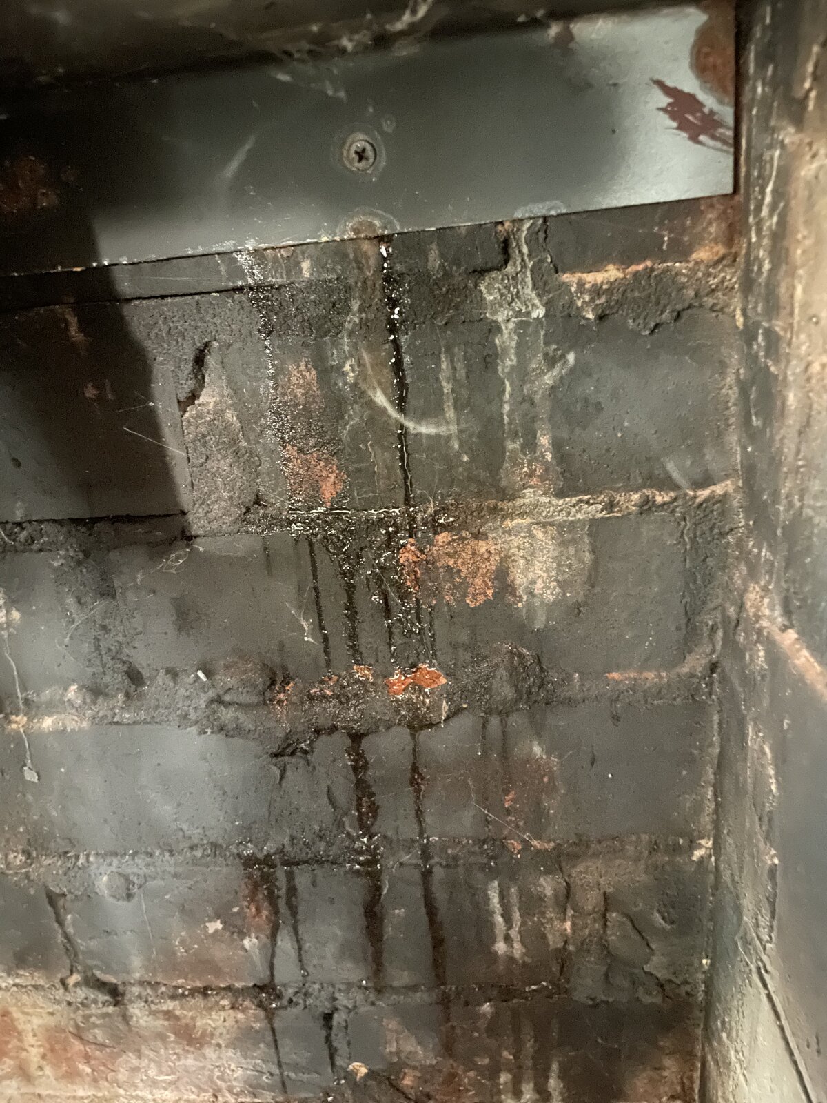

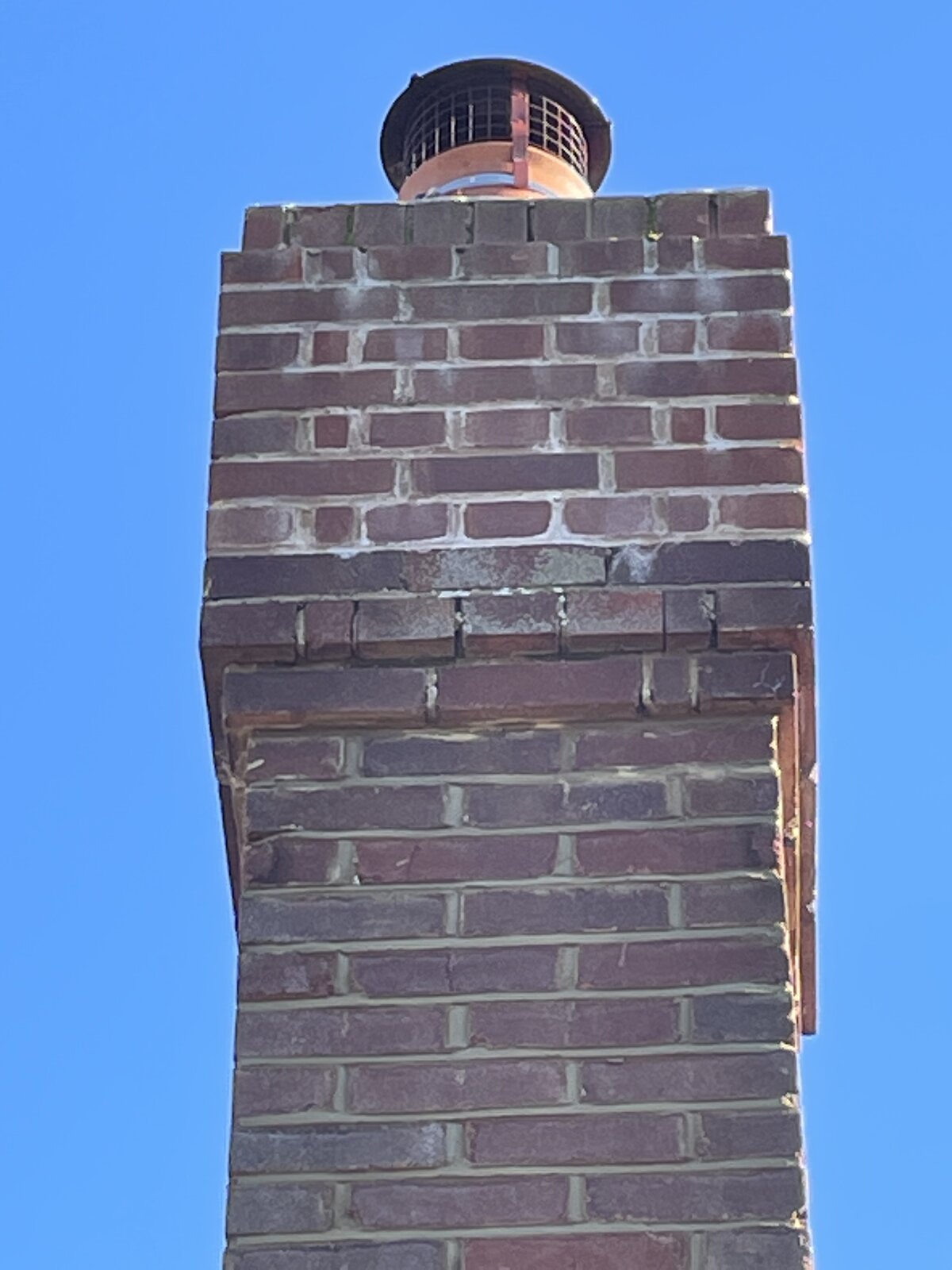

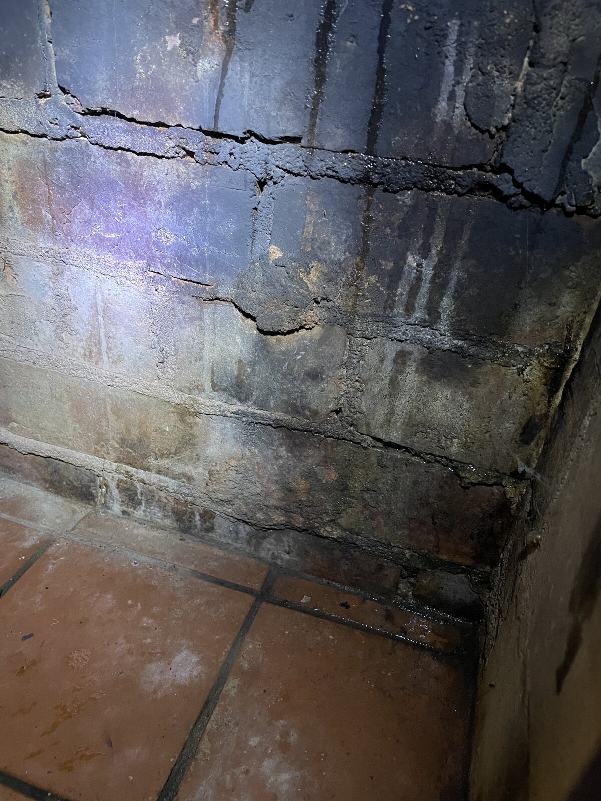

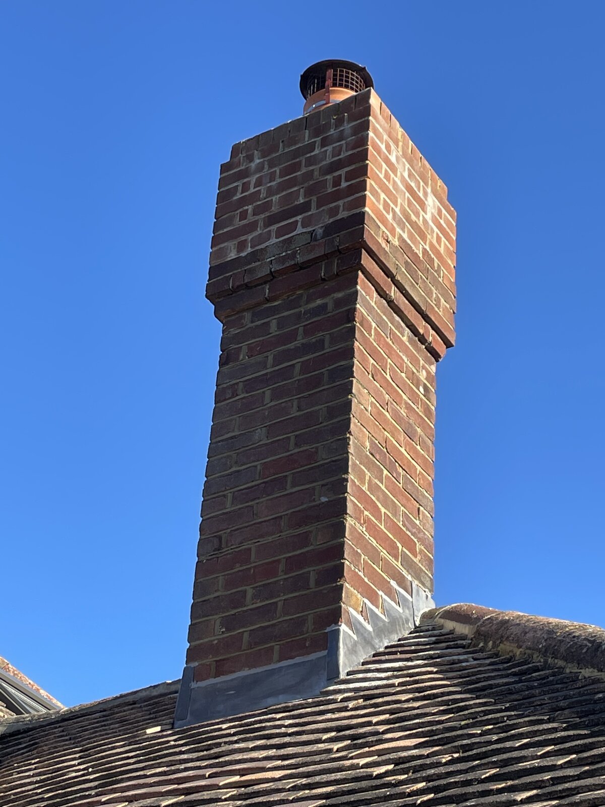

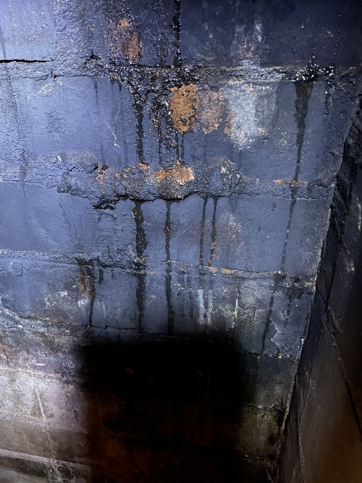

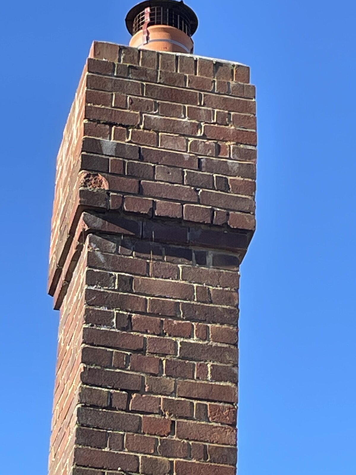

Water penetrating down chimney, HELP!!!!
18 Oct 2022
30

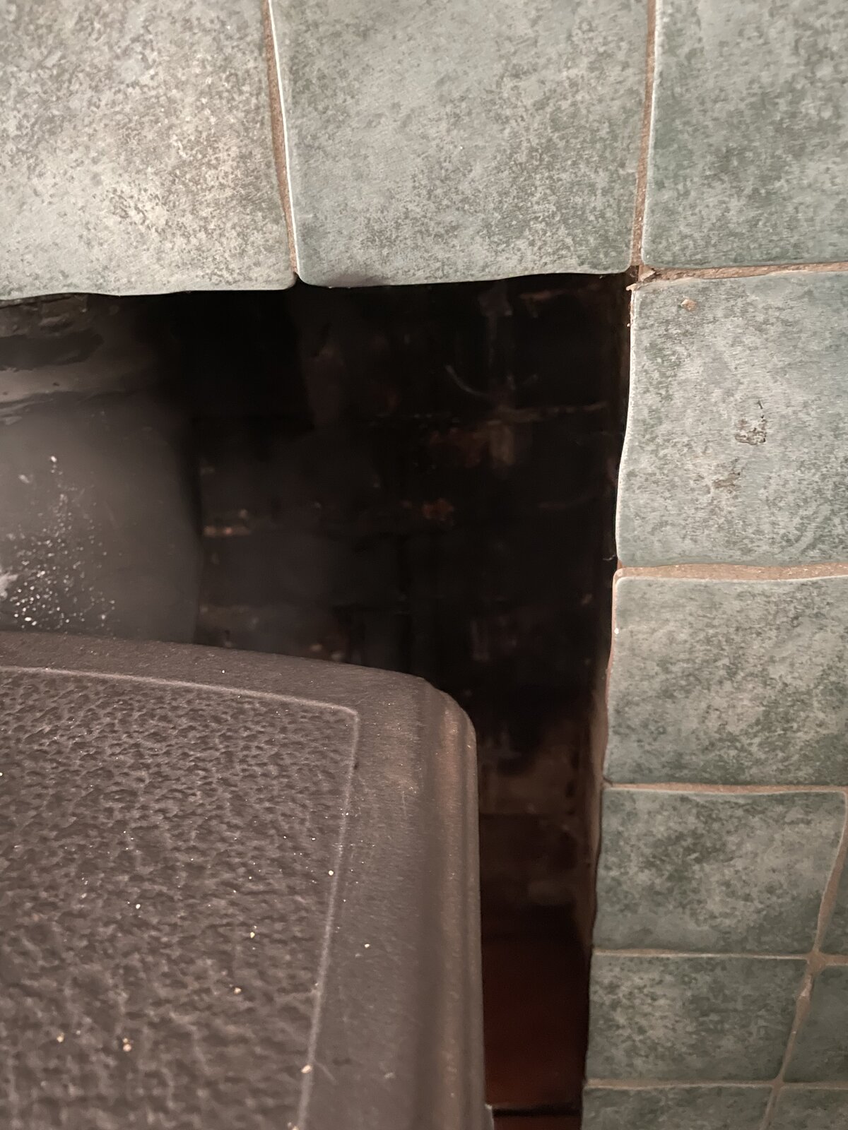

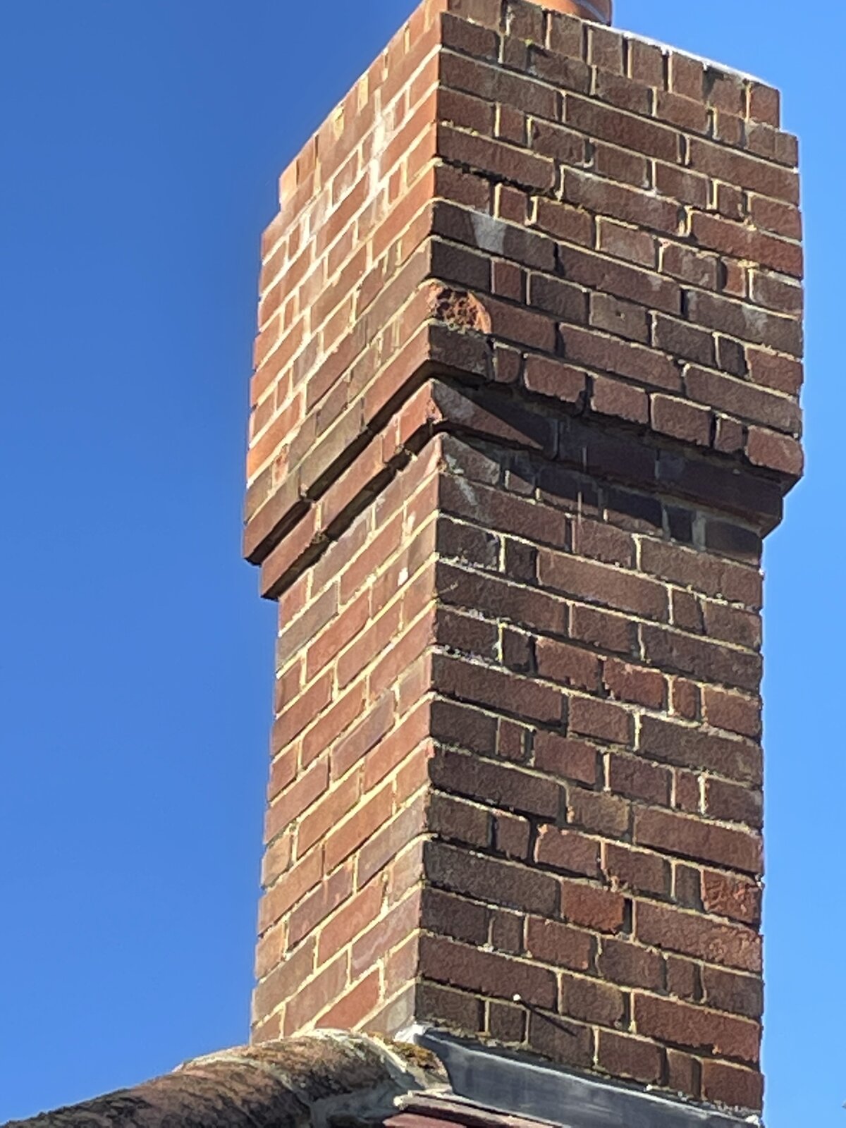

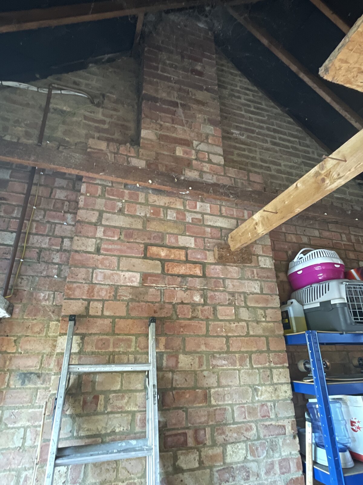

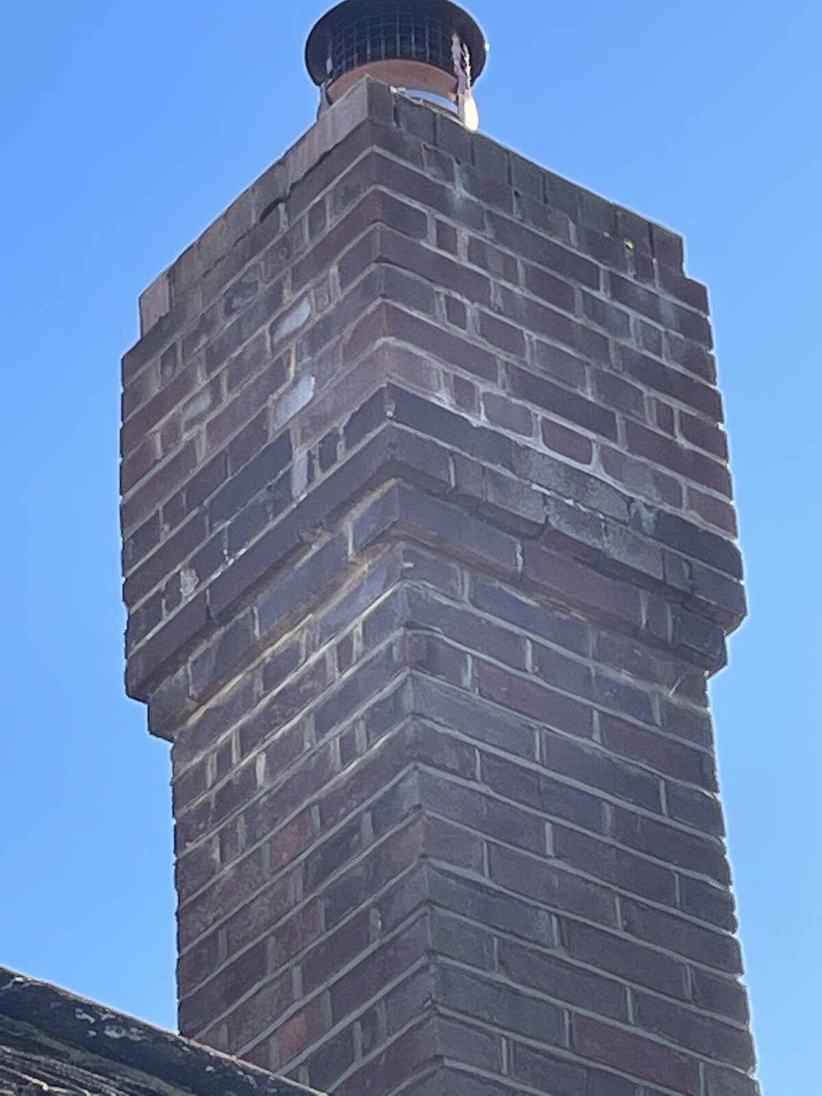

By process of elimination i am trying to identify the entry of this water ingress into my chimney
I have replaced the chimney flashing & also had a new chimney pot installed (which seems to have stopped water to inside my burner)
Any thoughts would be appreciated, my roofer has now reverted to suggesting painting the chimney with storm dry.
Will simple penetrating water into brick cause a water drip i am experiencing
Help please??

needs a good pointing that's for sure and re check around the pot
