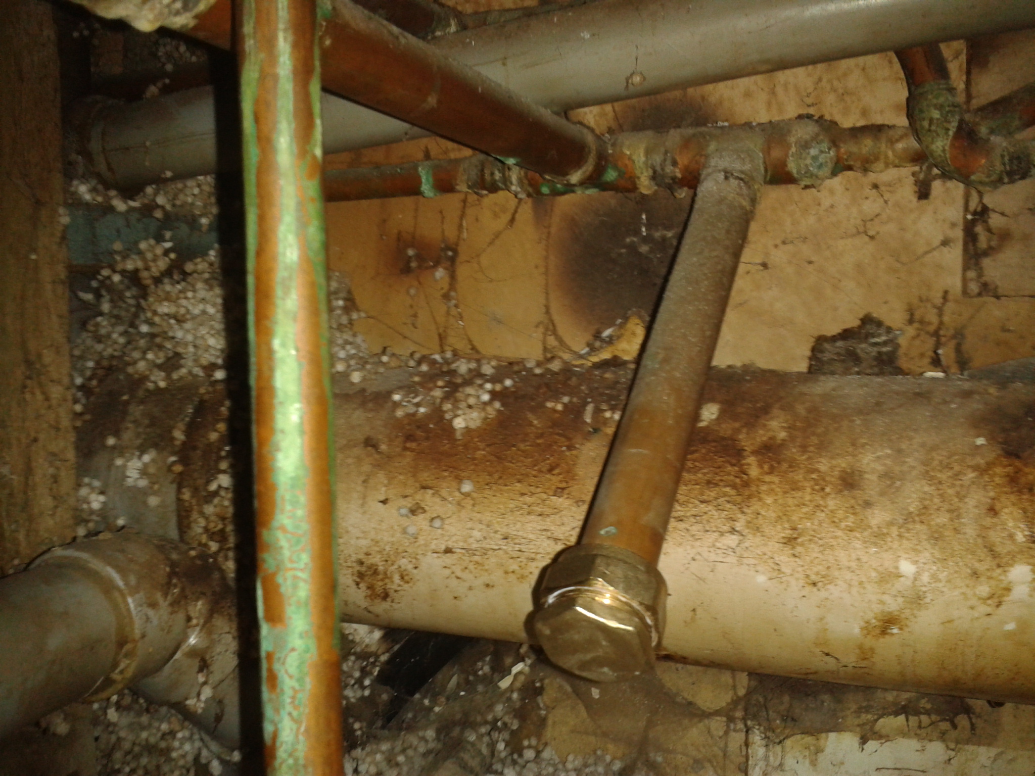

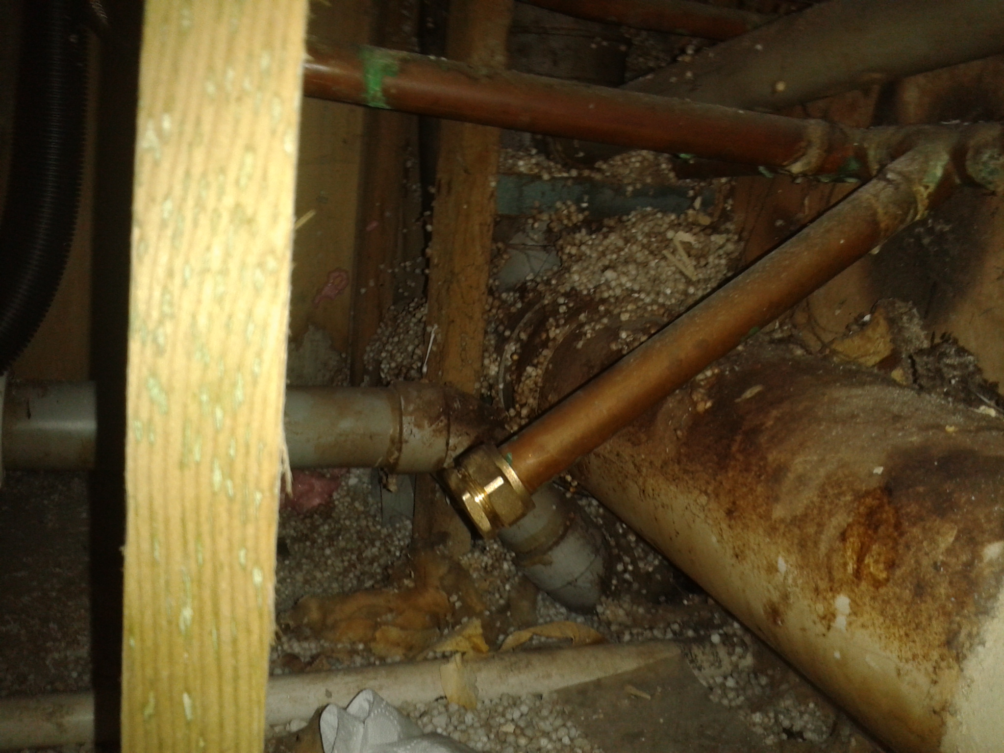

Job is a good'n, i got in on finger tight, held the cap with grips and turned the larger nut till it felt tight. Think ill keep an eye on it for a bit, if it dont drip or no wetness within an hour, would you say its fixed?
I could of got it closer but i wanted to save some pipe incase it went wrong. Thought it was the wrong one when it sprayed out a bit. SHHIIIIITTTTTT.

Nope... dope is good. I use Laco ptfe brush on stuff but I do hundreds of joints! I figured you could do without another £10 to spend! You should be fine... Just don't overdo it!
Give it 24hrs of system usage (pressure and heat on and off) before hiding it all back in the dark (y);)

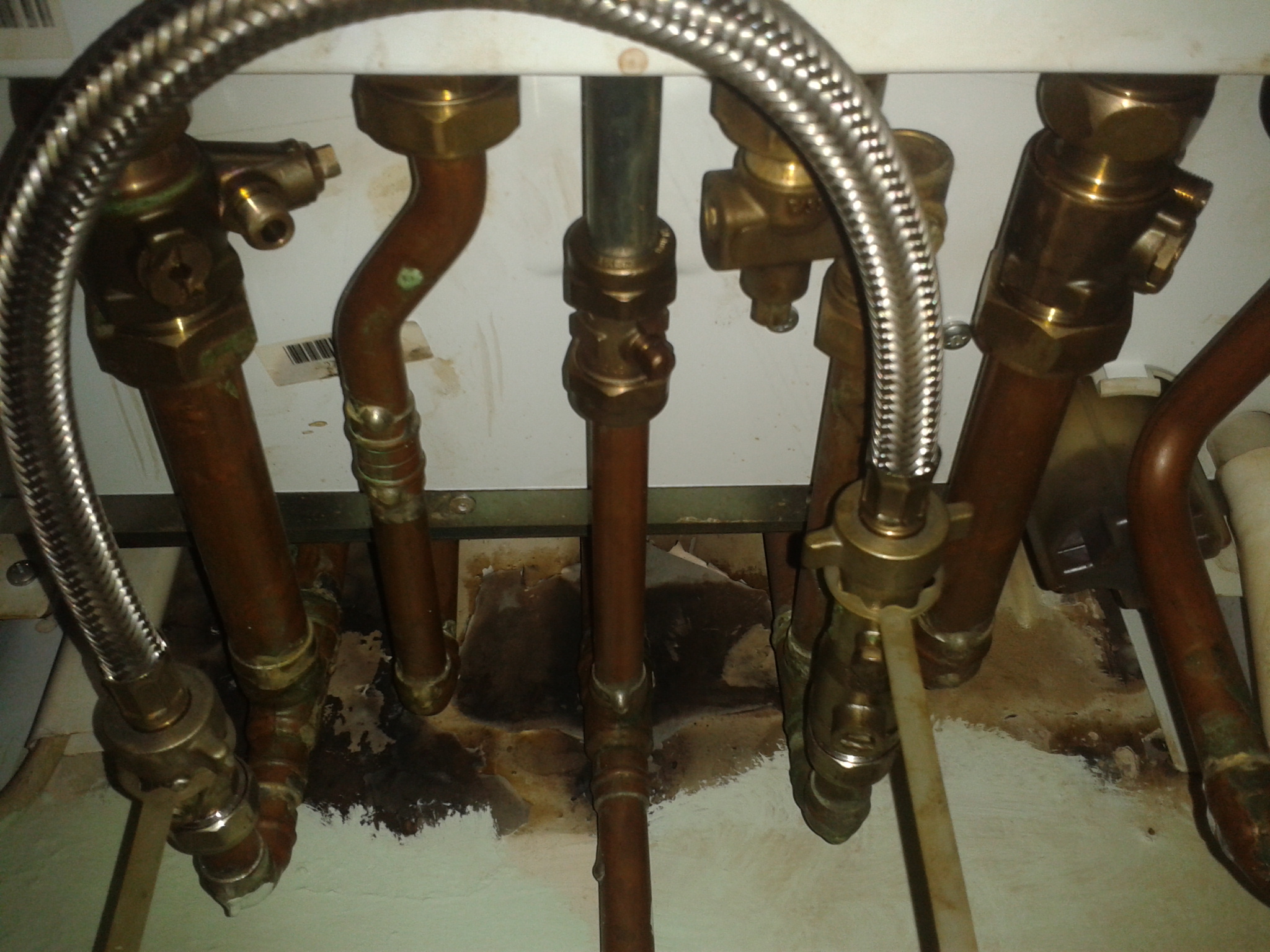

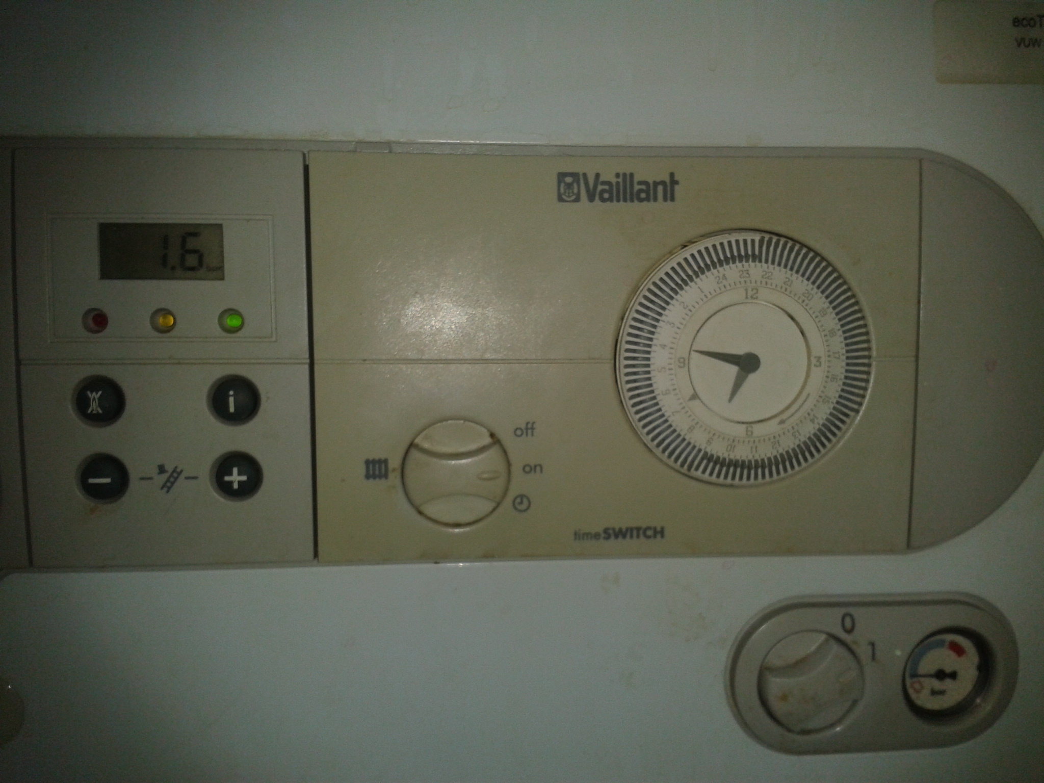

Lets finish this thread off with a topping up the boiler pressure, seems low.
When i lived in another property it had valves with handles, this looks like a flathead job.
Problem is, i dont know what to adjust. I hope the pipe picture is ok, sort of looking up at the boiler.
Be great if someone could download the picture and draw on which ones to loosen of 1st.
And of course, how much boiler pressure do i need.
Get a flat blade screw driver on the valves connected to the braided filling loop. Turn the slot so it's in line to turn on and as it is to turn off.
