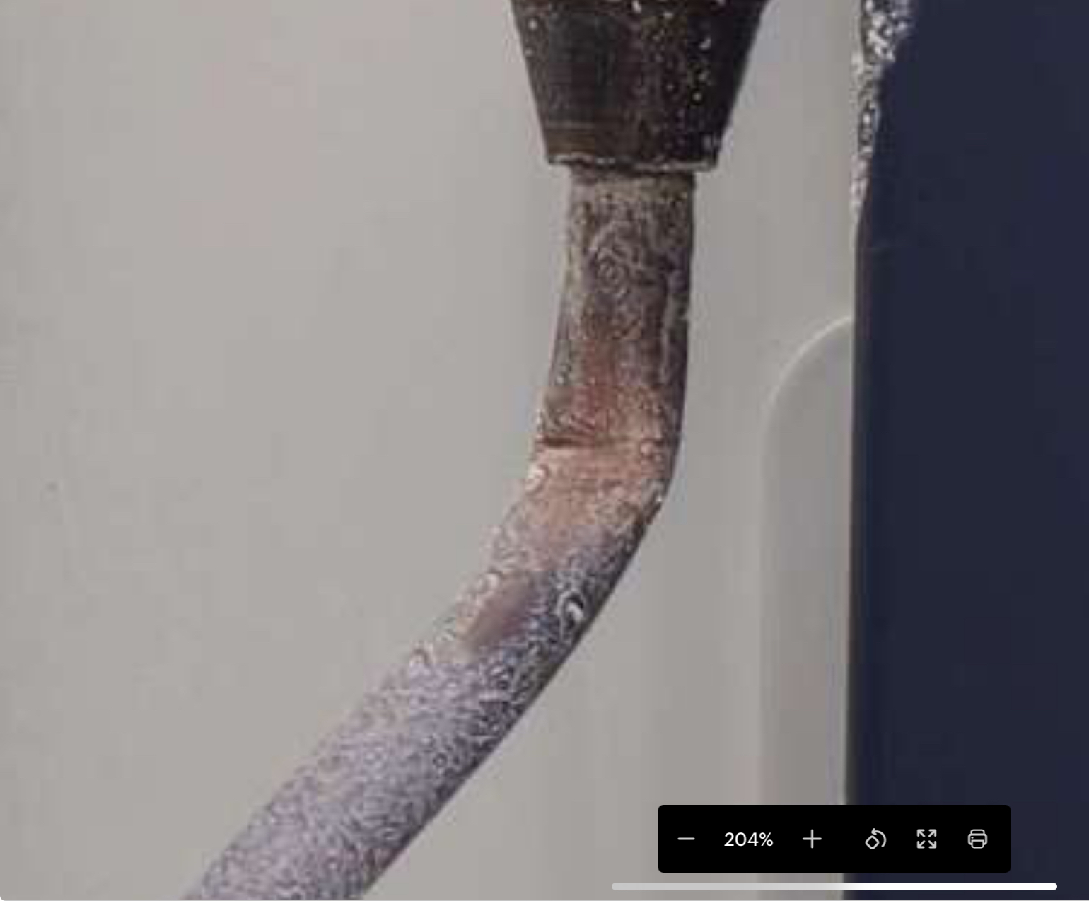

Hi all,
I hope someone can help me please & yes it's been an ongoing saga hence the details. LOL
I'm in Mexico right now & no one here knows what they are doing. Even locals say that.
Anyway, this rental I moved into has had NOTHING but plumbing problems, so cosmetically it looks nice & large, but everything else is crap.
It took months for me to get the landlord to bring in a professional (if you want to call him that) plumber to fix the water leaks in the toilet & sinks & two of them even caused new leaks. I paid full price & never got the 3 functioning bathrooms until after 3+ months.
Then the pilot for the hot water heater outside kept going out because of the heavy winds. Finally a neighbor recommended his plumber friend. Turns out he's NOT a real plumber, they all have handymen come here pretending to be electricians & plumbers.
He replaced the thermostat (I assume it was that) & the button you press to ignite the pilot.
All was fine.
Then I started to get rocks in the water scratching my face. He spoke to them & they agreed to let him clean out the hot water tank & the water tank on the roof. There were TONS of hard white rocks (I have pics & videos in the folder below)
Then 1-2 weeks later something happened with the water pressure so he came back & cleaned out the kitchen faucet & shower head upstairs with all of the same white guck.
2-3 weeks after that I started to complain to him that something was worse with the water pressure. I would turn on the hot water in kitchen sink & within 1-2 minutes, the pressure would decrease. Video in folder.
Also I was able to wash the dishes with NO cold water on. Clearly that means the hot water wasn't as hot & I checked the dial & it was almost at 100% which it's never been before so it's on very hot.
They all wash their dishes in cold water here, so me using hot water is foreign to them & they didn't understand me.
I also told him the hot water for the shower was now luke warm after a while. I didn't time it, but it's after 5-15 minutes & I take long hot showers & I moved in November 28th 2023 & never had a problem until he cleaned out the boiler & water tank on the roof & cleaned out the guck in the kitchen faucet & shower head.
They don't listen here, so when he came during the day when it was hot with sun outside, he's like SEEEE, there is hot water as IF I was crazy. All he did was turn it on in both the kitchen sink & shower & try to prove that I'm lying. I wasn't happy.
He ignored me about the water pressure issue.
THEN 2+ weeks after that I had NO WATER and I thought it was something he did.
I opened up the sliding door & the hot water tank had fallen on the ground & it was trashed. It had to be replaced. I know, don't say it LOL
I had HOPED this would fix the hot water issues, but it didn't. It fixed the kitchen hot water, I always have to turn on the cold now, but the pressure decreasing after I turn it on is still an issue, & the shower turning lukewarm after 10-15 mins. still means I'm taking cold showers.
And yes the pilot is on.
Please tell me you know what's wrong with both issues. I'm really upset because I even brought in that first so called plumber who finally fixed all the leaks, & he did nothing but look at the boiler (pics in folder) & turn on the hot water. sigh
Even the pressure upstairs in my ensuite is low, but it's always been low even before all of this. They say it's normal not to have good pressure upstairs, but the other hallway bathroom where the shower is does get fairly good pressure. It just takes forever for the water to get hot, at least 5-10 mins. SMH
It's obviously not the hot water tank because I've gone thru 2 of them now.
To recap, even after he replaced the switch/button & temperature dial on the old rusted boiler, all was fine until it started to get cooler outside, but last year it would get colder & I still had long hot showers.
In 3rd world countries they don't insulate their pipes which is why I'm mentioning this.
This area does get tons of white guck which I assume is minerals and or stones.
Another forum that didn't help me in the end said he thinks the stones got lodged in the pipes & while that made sense initally, if that was the case, why would I get any hot water at all? And why do I get hot water in the kitchen?
Now I don't wash dishes for 30-45 mins., 10-15 mins. max, but there's still appears to be plenty of hot water & yes, the boiler is right outside the kitchen back door.
With the water pressure in the kitchen I could see that happening, but if I turn on the water all the way blasting which I never do, the water pressure doesn't decrease & no, I haven't changed how I turn on the water in the kitchen. It's always the same approximate turn of the hot water first, then eventually the cold.
Even in the powder room (main floor) there's a difference from before.
I always got plenty of hot water when the faucet handle was pointing to the middle of the sink, but now it's lukewarm at best & I have to turn it more to the far left to get really hot water.
Maybe the water pressure moved some rocks into the pipes? But again, how does that affect the hot water issues?
https://workdrive.zohoexternal.com/...6b87168b6c04ceb7b89386fbe0348bef56b319aa0b8b3
Thanks a ton for any help you can give me.

Some observations…
- it looks like the boiler gas pipe is severely kinked at the top, which would restrict its ability to operate correctly / heat water.
- it’s likely that after 15mins in the shower, you have used all the available hot water in the tank, the above restriction will likely slow down the reheating of water so your shower will run cold due to both circumstances.
- the ‘white rocks’ look to be limescale, do you get a lot in your kettle too?
- likely that limescale is a contributing factor to your kitchen sink issues
Fixing the gas pipe would be my first priority, then identify ways to reduce the limescale.

I have to go look outside to see if that's a pic before he cleaned the boiler & tank on the roof or it looks like that now. Thanks
If I was only supposed to get 15 mins. of hot water, this would have been a thing the entire time, but it wasn't, & the new boiler size is the same. I made sure they would buy the same size. I think they said 600 L
Also even after he cleaned it, it took several weeks before this started to be an issue, it wasn't instantaneous. I never wrote down the dates he came & what he did. I tried to look back on WhatsApp & couldn't find when he came to clean the faucet & shower head which honestly I can't remember if it was after that or after he cleaned the boiler that the hot water issues started. I do know for sure it was:
1. Change temp gauge & button
2. I started to get stones in the water so he came & cleaned the tank & boiler
3. Came & found limescale in the kitchen faucet & shower head & cleaned those.
4. Replaced fallen boiler
Also remember this isn't just about the shower, even in the powder room I used to get very hot water with the handle pointed in the center, now I don't.
White rocks - I don't use a kettle, I use a pot to boil my water. I have not noticed it in any of my pots & pans or glass pitchers, but I do use a water struturer so the water (not tap) is being poured through that.
But yesterday I went to try & put on a sprayer faucet on the kitchen sink (it won't fit, there needs to be a extra piece attached to it I think - sigh) & for some reason, the way I re-screwed the other one back on, I can now see white stuff on the side of it. I never saw that before, maybe it was on the other side.
I don't know if that's white paint from when he touched it, or it's that limescale.
I think the kitchen sink water pressure & hot water issues started at the same time which was after he cleaned the boiler, because I complained about something with the water pressure & that's when he came & cleaned the faucet & shower head. He never did anything to fix the hot water issues. He just got a bucket, filled it up with hot water from my shower, said SEEE, you have hot water & refused to do anything else.

Having read through your descriptions, I would only be able to advise that your mains supply is contaminated.
I don't know if it's limescale - is this a problem in the area where you live? Or is it unique to you?
How is your water supplied? From a well?
Until you get that sorted with some kind of incoming filter or screen on the pump (if well-fed) then you will continue to have issues with blockages.
And also the kinked gas supply needs to be sorted.

Yes, the boiler will heat the water as it drains and new, cold water enters the tank. If the gas is restricted, it cannot put enough heat in.
Googling Mexico, it sounds like there are lots of water issues, as mentioned above, and after googling, I too suspect the water supply has a high degree of contamination which is causing the white buildups inside your system.
Reverse osmosis filtering was a suggested method to clean a supply in MX elsewhere, that may apply to you too!?
Try to find a local expert who knows what the problem is in the area. They can then direct you to possible solutions.
At the moment, even if you replaced the entire internal plumbing, it’s very likely that the same thing would happen again, if no filtering was introduced.
Pressure issue possible blockage of mains supply. Assume you have 10 bar mains supply pressure when there is no flow. Initially water will be delivered at high pressure until the blockage in the plumbing destroys the mains pressure so you have a trickle coming through
Crimped pipe ( like a hose that is doubled up) will cause similar problem
The white stuff you talk about, may well be blocking the faucets or gauze filters and shower sprays

Again, the issue didn't happen because of the limescale or whatever that was that they cleaned out, but only happened AFTER he cleaned it out within 2-3 weeks or so. Had he never cleaned it out, I would probagly still have hot water for 45 mins.
And the reason I don't run out of hot water in the kitchen is I only wash dishes for around 15-20 mins. & a lot less water obviously comes out of a kitchen faucet then a shower.
Or it may have happened when he first changed the thermostat and button thingy to light the pilot. That was done before he cleaned out the system because I started to scratch my face & eyes when washing my face.
I actually found someone who says he figured out the problem based on the pics, but he's claiming it's the inside pipe in the boiler, he didn't even notice the bend in the pic you noticed. SMH
He quoted a price & I said I think you should come to take a look to confirm everything & as typical here, he just ignored me not once, but twice.
I'll paste what he said just to see if anyone can figure out if he's lying or not, because after complimenting him that he figured it out, I started to question whether he is lying, b/c how can he see something no one else can see because he never saw the tiny crimp in the pipe you saw and some of what he said made no sense to me, especially when I asked about why there's suddenly no water pressure after 1 minute when I turn the hot water on in the kitchen. SMH
Also, I just realized that he didn't remember I told him the boiler was replaced the 2nd time, so how could it be this copper pipe inside that got broken unless they didn't install the new boiler properly AND also broke the original boiler's internal pipe. That makes no sense to me.
Whatever happened must have happened when the old boiler was still being worked on & it is affecting something outside the boiler since it's impossible that 2 different boilers could have the same problem, but that bent pipe looks like it's still the original. I get a smidgen more hot water with the new boiler, but maybe only 1-2 minutes longer.
I still don't understand how that tiny crimp uses up all of the hot water faster than if there was no crimp at all.
This was translated by google
"When I did maintenance, I damaged a part
And it causes the water to mix
It got clogged with dirt from the boiler
There is a tube inside the boiler, it is called a sewer, it is the one that was damaged when I did maintenance
And what they removed from the boiler when they did maintenance is scale and it went through the sink pipe
No, the dent is inside the heater
I have to remove it and place copper tubing inside the heater"
P.S. VA = Virtual Assistant
Thanks a ton
