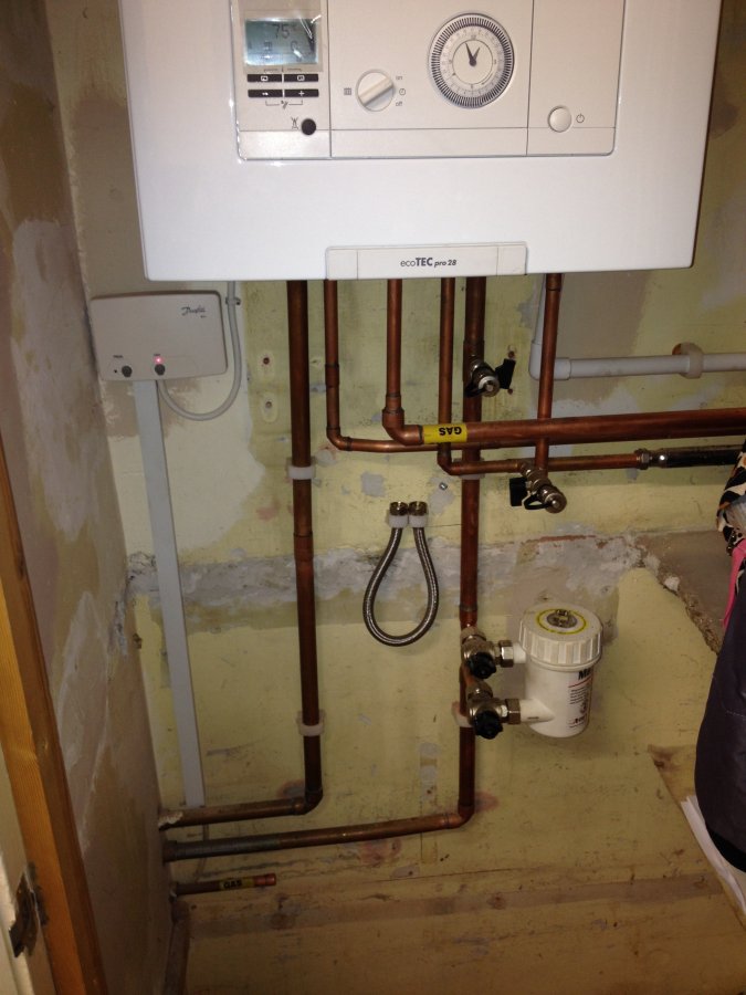

Yes my previous boiler was also a combi & I'm new to this and know nothing about it, here's a photo

Did your installers demonstrate the system to you after it was fitted? Was it working then?
Do all your cold taps work as they should? Is it just the Hot that's not going?

If it was just your hot water not flowing, then I would have been thinking along the lines of a restriction on the cold feed to the boiler, be it an unopen inlet valve or debris caught in the inlet filter!

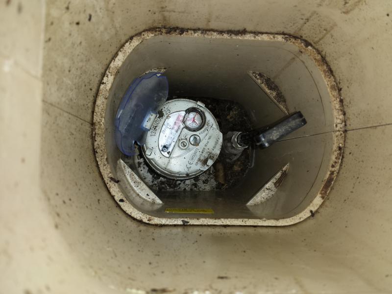

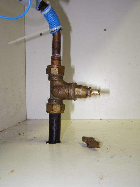

As for stopcocks, try finding the one directly outside your property, small black cover, open it up and you should see a white dial that you can turn 90 degrees, it should be in line with the body it sits on... If you're in an apartment block or it's an old style stopcock - don't get involved, call the fitters. Also check stopcock that's hopefully under your sink to make sure it's fully open anti-clockwise. That's the best I can offer at this distance (y)
In the ground outside your house... This one has a black 'key' on right, which you turn fully anti-clockwise to open.
Internal stopcock under sink - something like this but you should have handle on spindle not lying on base of unit - hopefully:D
