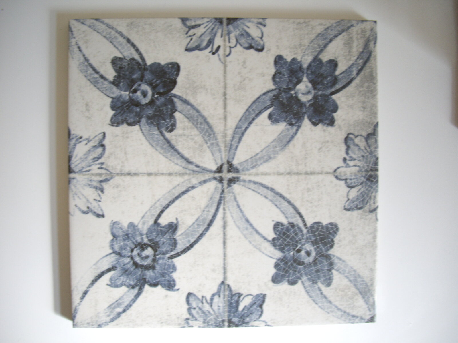

I'm sampling bathroom tiles atm and this one cost £1.50.
A printed design on ceramic. Looks good, lasts for years and impervious to water.
