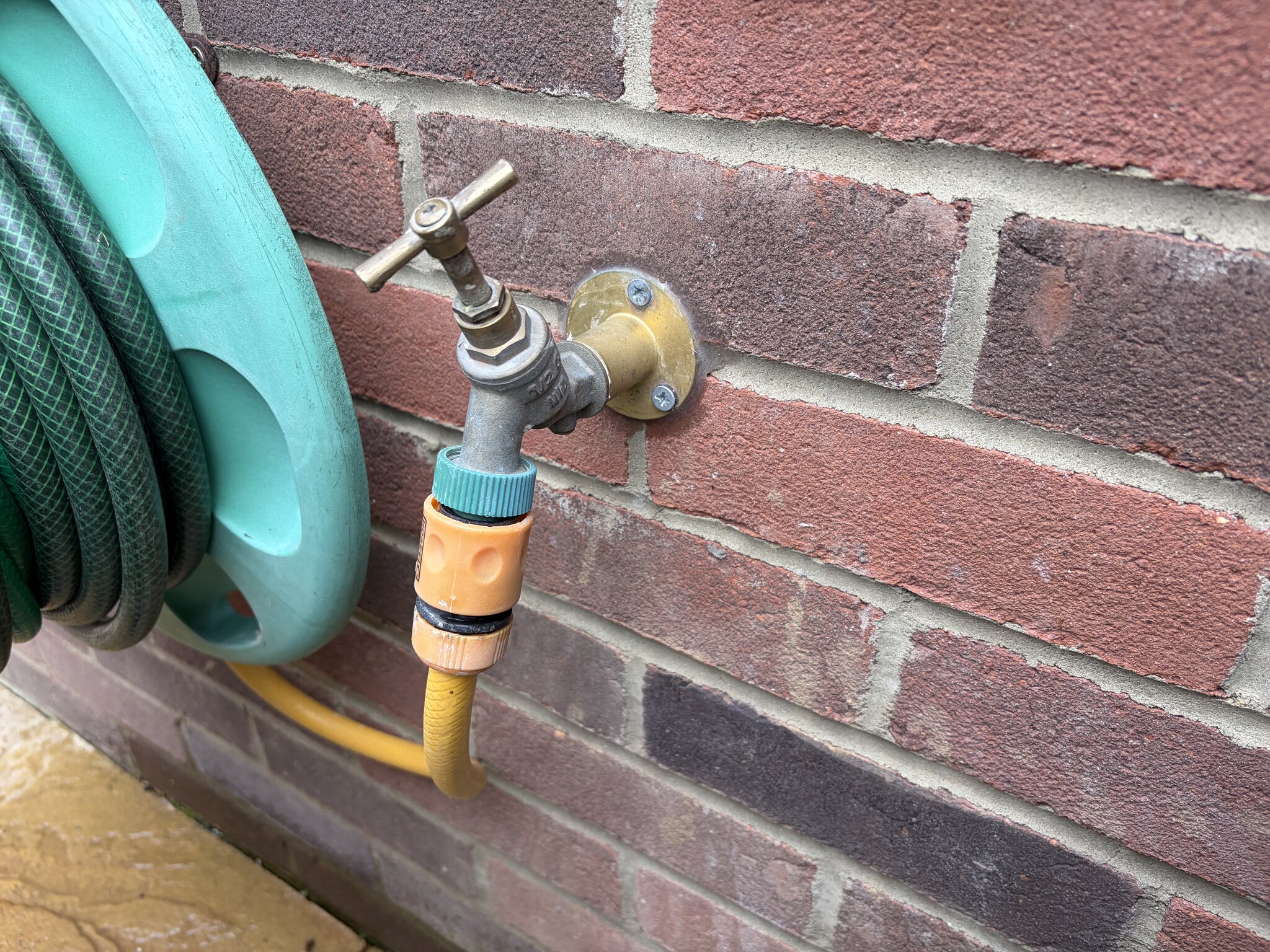

I’m looking to replace my outside tap with two outlets so I can run a pipe into my detached garage. What would be the best way to do this?
