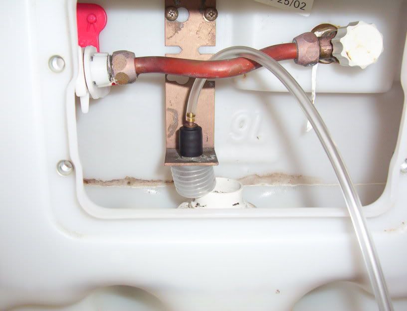

Ok.... hoping you guys can help
First picture is what i believe is the problem.... i dont believe the bellows is allowing the bit of plastic (technical huh) to come back up.

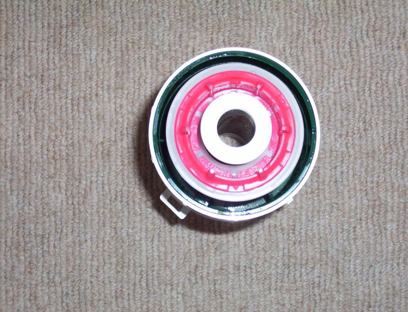

this is the bit of plastic that the bellow presses down and (i believe) the bit that is not coming back up fully.

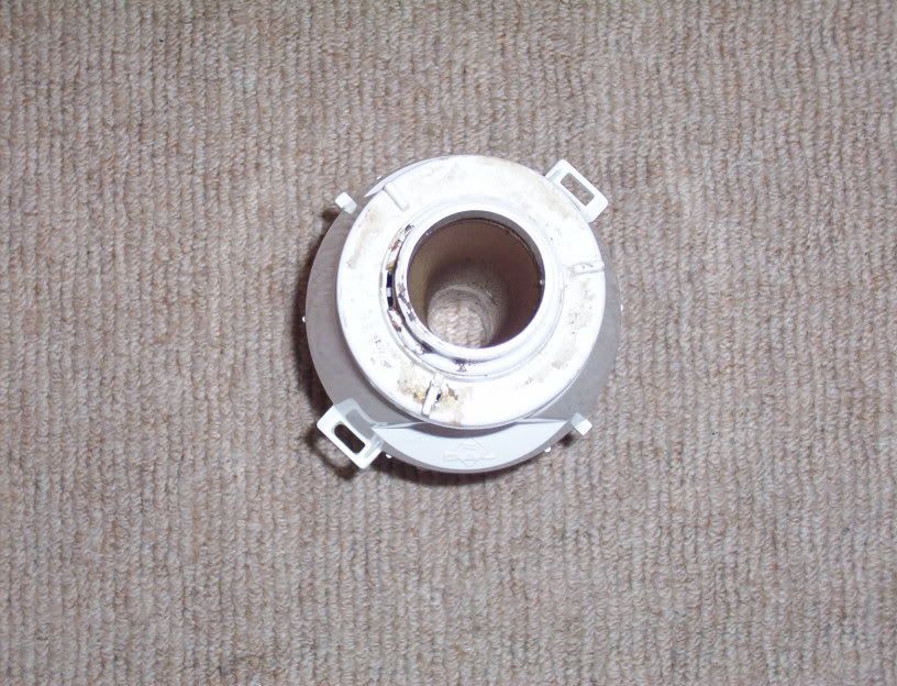

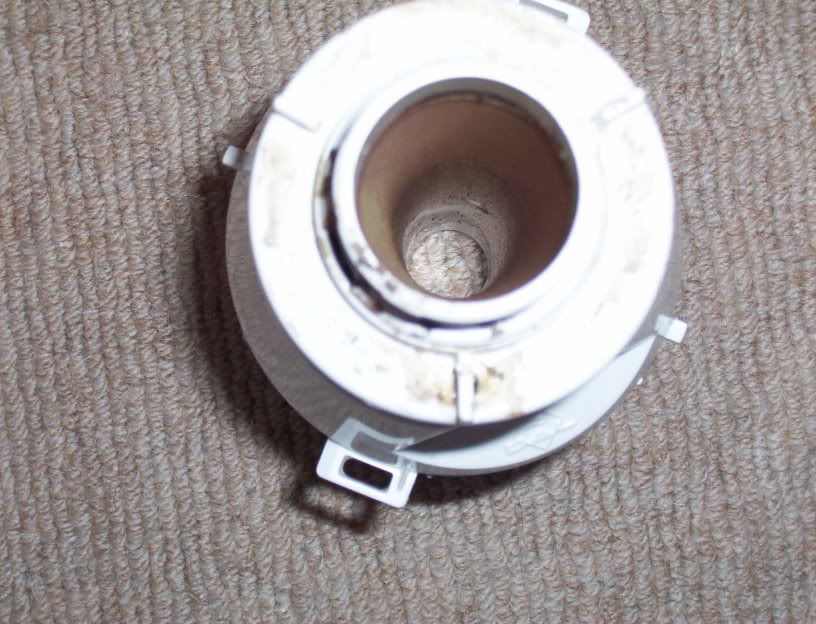

Bottom of the bit of plastic... looks in good condition.

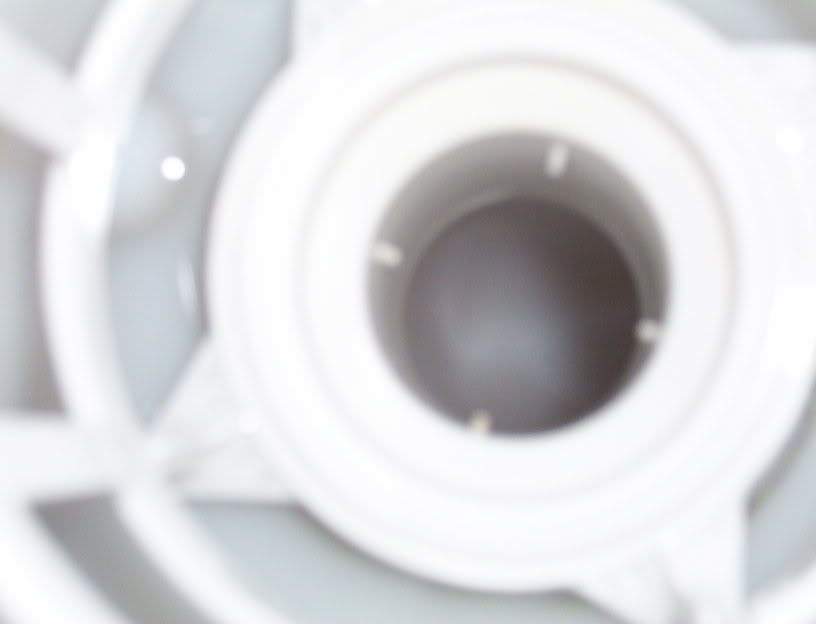

The bit of plastic sits in a small basket to keep it in place and i managed to get the camera inside to take a picture of it...
Anyone have any ideas of what could be causing the trickle? Could it be the bellow not retracting fully? Where can i get new bellows if so?
If not the bellow anyone have any other thoughts?
Thanks all :)

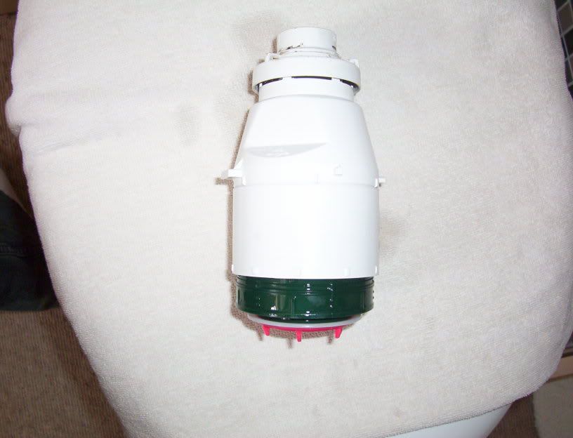

Ok, now i am wondering if this bit could be to blame in that it does not fully seal of the water from getting into the bowl...
Does this sound possible? Where can i get a replacement?
This looks like a Grohe cistern. Grohe are German but you can get parts in this country. See that green part at the bottom of the dump valve? Can you pull it out as a part? If so then this sounds like a problem I had a while back. We fit furniture made by a company called 'Utopia'. They had a few problems with the cisterns like you described and it ended up being a design fault. They sent out a new part - that green section - and it just clipped in place and sorted it out. They have since changed over to another make though. I have called them a few times and they sent out the part no questions. Play dumb and give them a call.

That dump valve is unique to that cistern. I doubt if you will be able to buy any standard parts. If you cant get the right part, chances are you will need a whole new cistern. It looks as though your cistern now is a rear entry ( oohh-eeerrr!!! ), so a bit of extra plumbing may be in order. See what Grohe say and post back.
