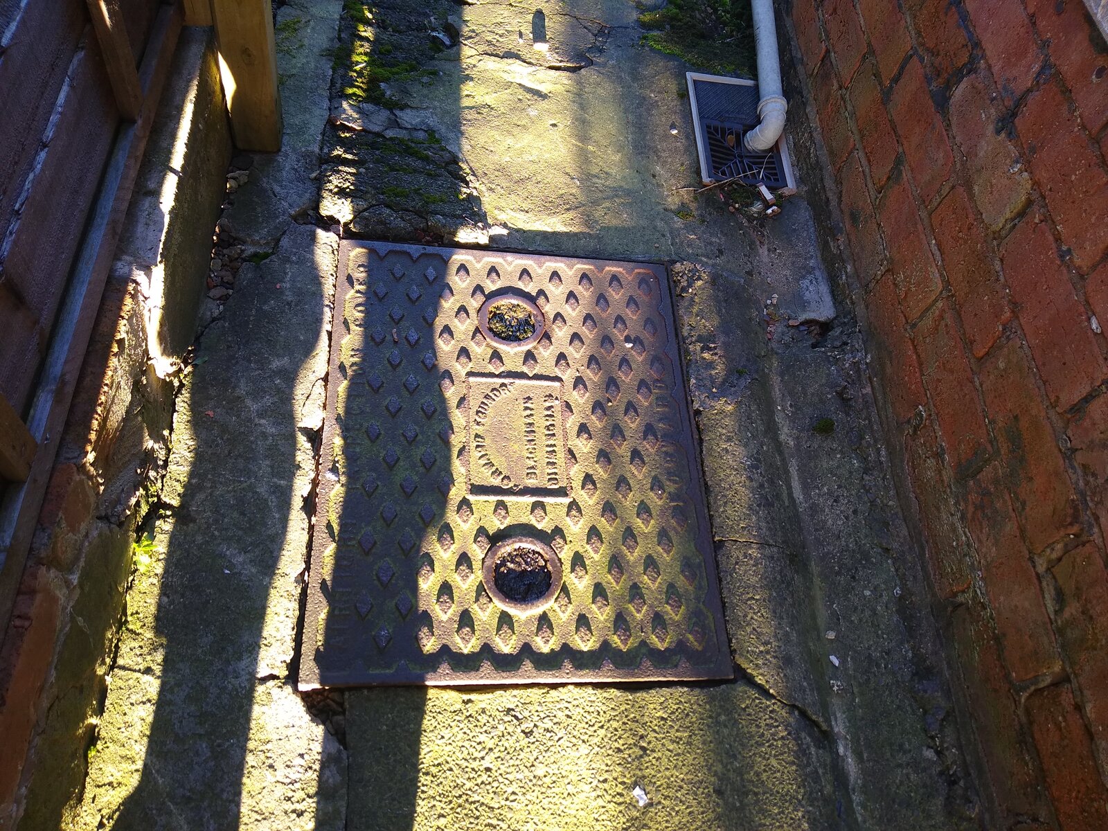

There is a manhole cover in the alley between my house and the next block of 4 houses. That services the drains for the next four houses. I have just been out and noticed my neighbour (on alley side) has her rain water going into a gulley that then drains into that main drain. I will take some more photos. Thank you.

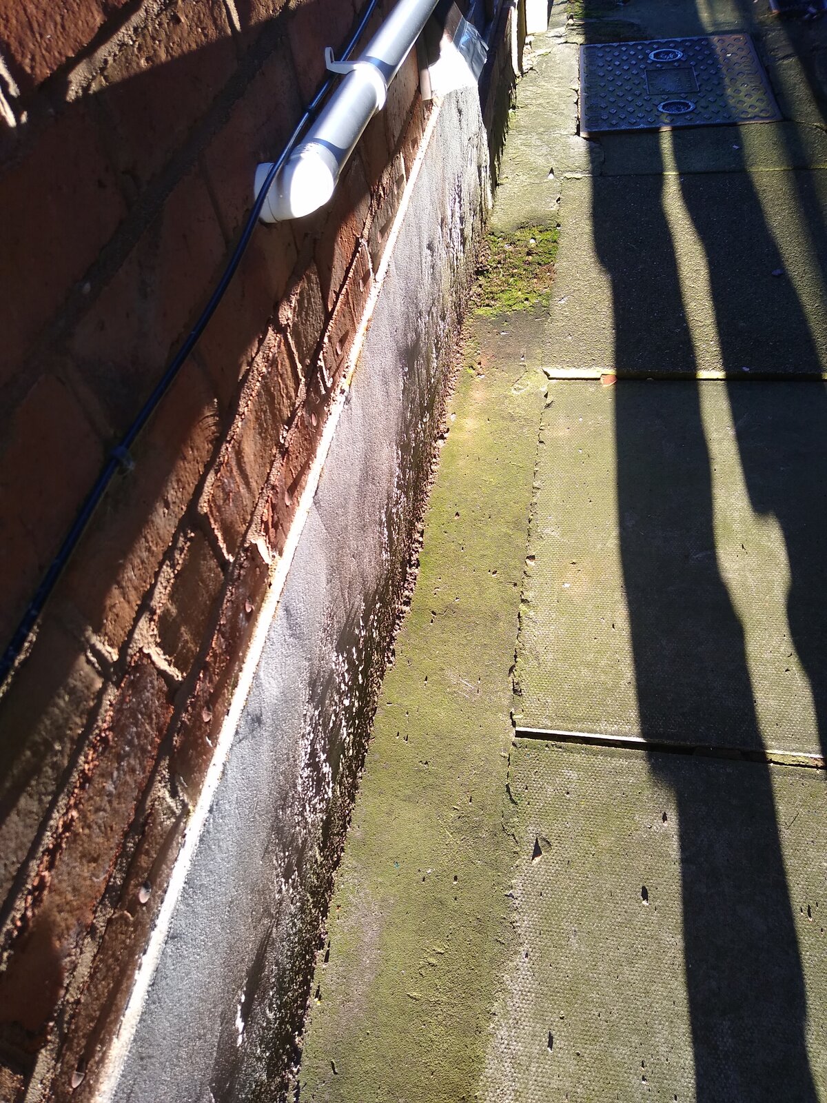

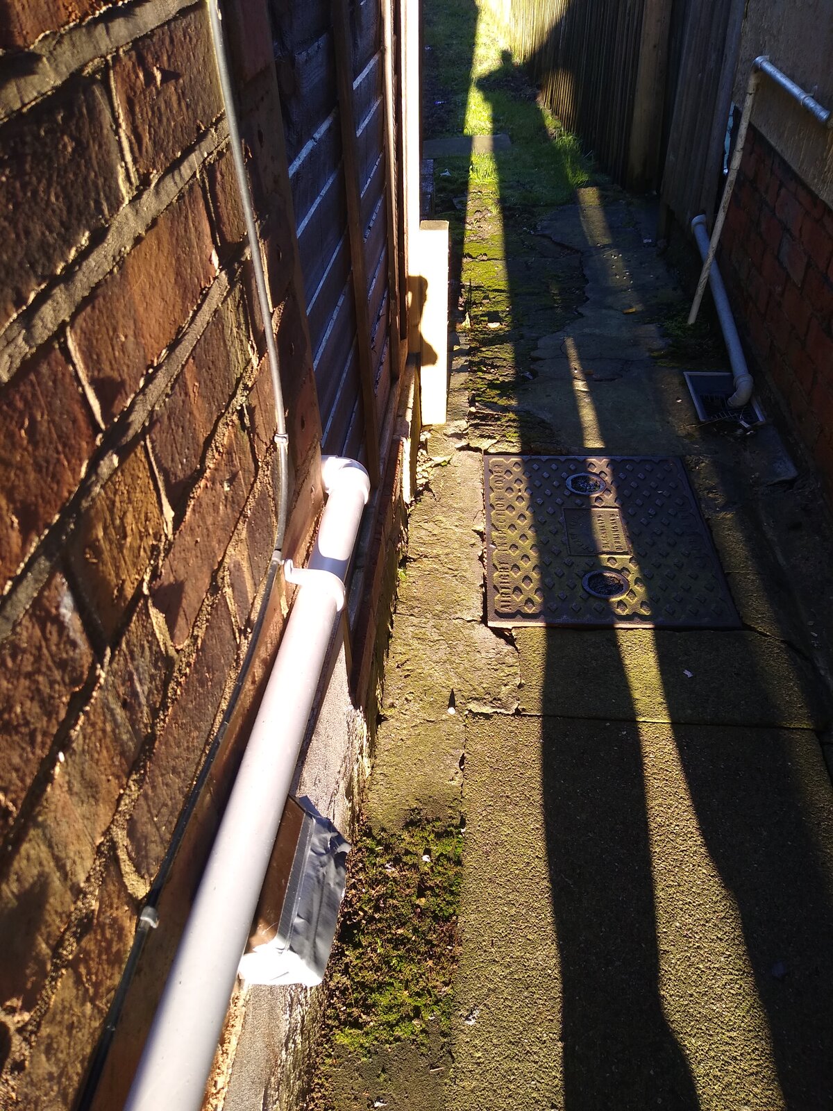

I have some more pics. As you can see in alley to right my neighbour has her drain from kitchen and the rainwater gulley going into a smaller drain at side of her house which I imagine connects to her foul sewer via manhole cover. That manhole doesn't service our foul sewer as that is at other end of the block.

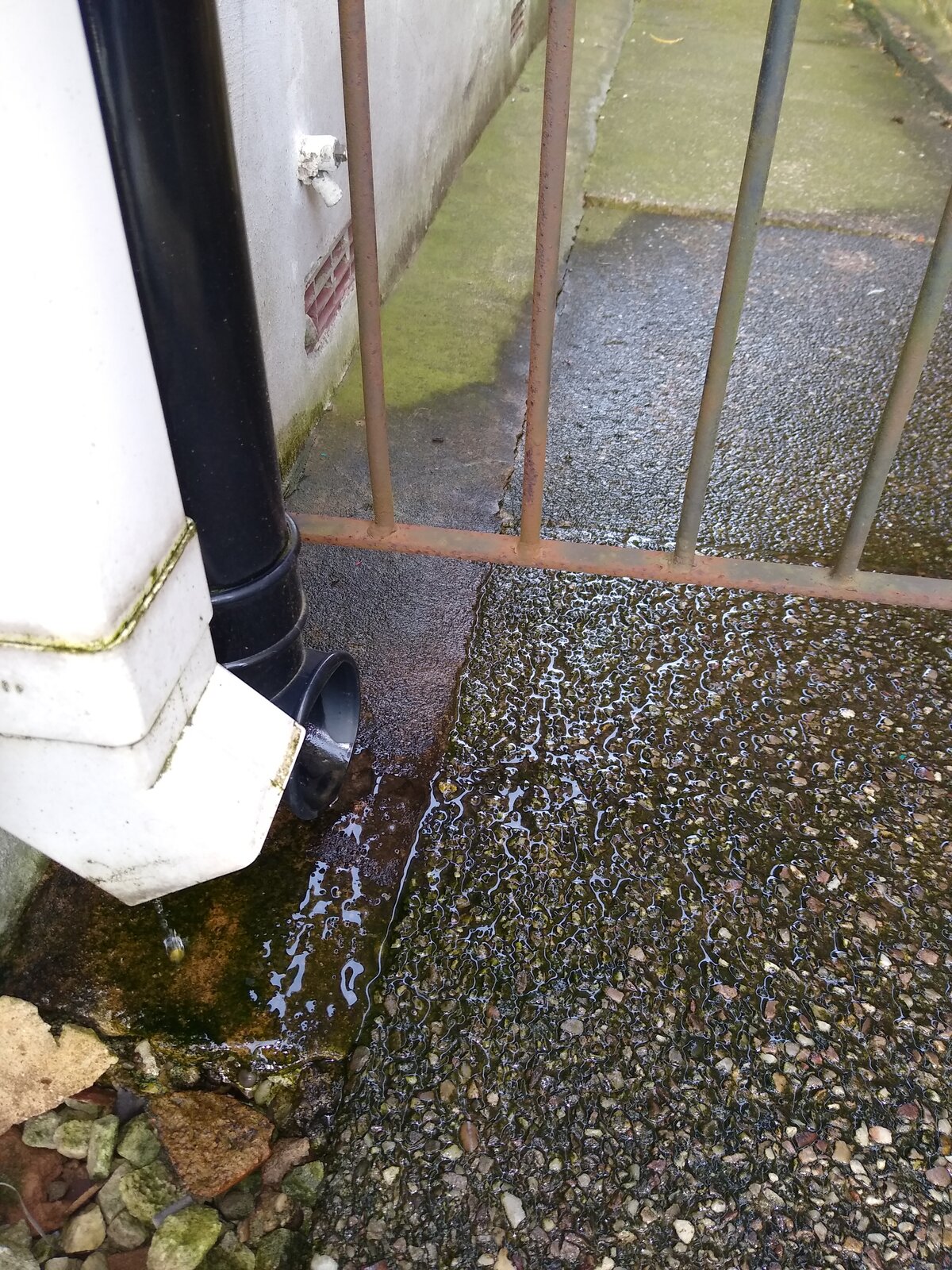

As you can see my rain water has nowhere to go as it looks like gulley has been filled in with concrete and just left to drain on that.
See if you can get that manhole cover off and work out what pipes are in it. I suspect there might be one in there, which originally had your gulley draining into it. It might just be the photo, but your neighbour's gulley, looks as if it is fairly new.
There is a foul drain under that cover servicing her house and 3 others in her block. Her gulley isn't new but the small grid and drain connection look very new. Her rain water is definitely draining into that drain under manhole.
My rainwater has nowhere to go though as I have no gulley or connection to a sewer. If I definitely knew that was the cause of water under my house I would fix it. I need to be certain though as that water is the priority at the minute.
