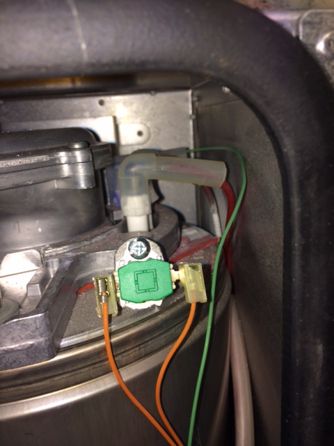

I have a 12 year old WB Greenstar 18Ri boiler which has been serviced by the installer annually. It’s been flushed many times and has always had either Fernox or Sentinel X100 in it. A Salus filter was fitted about 2 ½ years ago.
It’s developed a problem where it would lockout at first firing with the blue light flashing, so nice cold house in the morning! It reset okay, but had to run with the boiler stat lower. My installer came and changed the pump – still same problem. He then came back and changed the three sensors: High Limit Stat, Overheat stat and Temp Stat. - still same issue. Checked flue for blockages and gas valve – all okay.
I’ve run Sentinel X800 for a week with no difference, so don’t think it’s a blockage or sludge? The boiler flow and return pipes sit at the same temp, so not convinced it’s the heat exchanger?
Long story short, it runs perfectly with the boiler stat at what I would say = 1 o-clock position. When the system is hot, I can push that to 2 o-clock, but 3 o-clock will cause lockout within 1 minute and the blue light flashing ON to OFF.
What concerned me was when I looked on ‘youtube’ it would appear that my installer never stripped out and cleaned the burner/heat exchanger in 12 years! Could this be my problem?
If he really hasn't pulled out the burner and baffles in all that time then he's been ripping you off and you should find someone else. After 12 years I'd expect the burner gasket to be toast and the lower baffle to be stuck in there. It'll need a new set of electrodes, bearing plate, trap clean and a thorough hex clean out if the baffle can be removed. I'd get someone new in to have a look at it. Then there's the issue of the lockout.

I had the cover off this morning for a closer inspection (all isolated) and guess what, the burner gasket is perished - see .jpg. It has damaged the electrode cables and insulation's. No wonder the poor old boiler is struggling, all down to ultra sh1t servicing.
I'm trying to get another engineer in to put this all right. Gasguru is correct, my original guy was ripping me off big time.
I'll post again when it's all fixed with an update. Thanks for everyone's help and advice.

Got WB out on a fixed price repair £275.00 all in. They came out really quickly and replaced the Heat Cell and ancillary parts: as it had just blown the board fuse and was now dead, the fan was replaced as well. This was caused by the heat cell red gasket failure and moisture getting into the motor. Proper job done by excellent WB engineer and all problems due to appalling service (or lack of) by "accredited" engineer.
