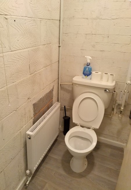

Moved a WC from the garage to the under the stairs room...

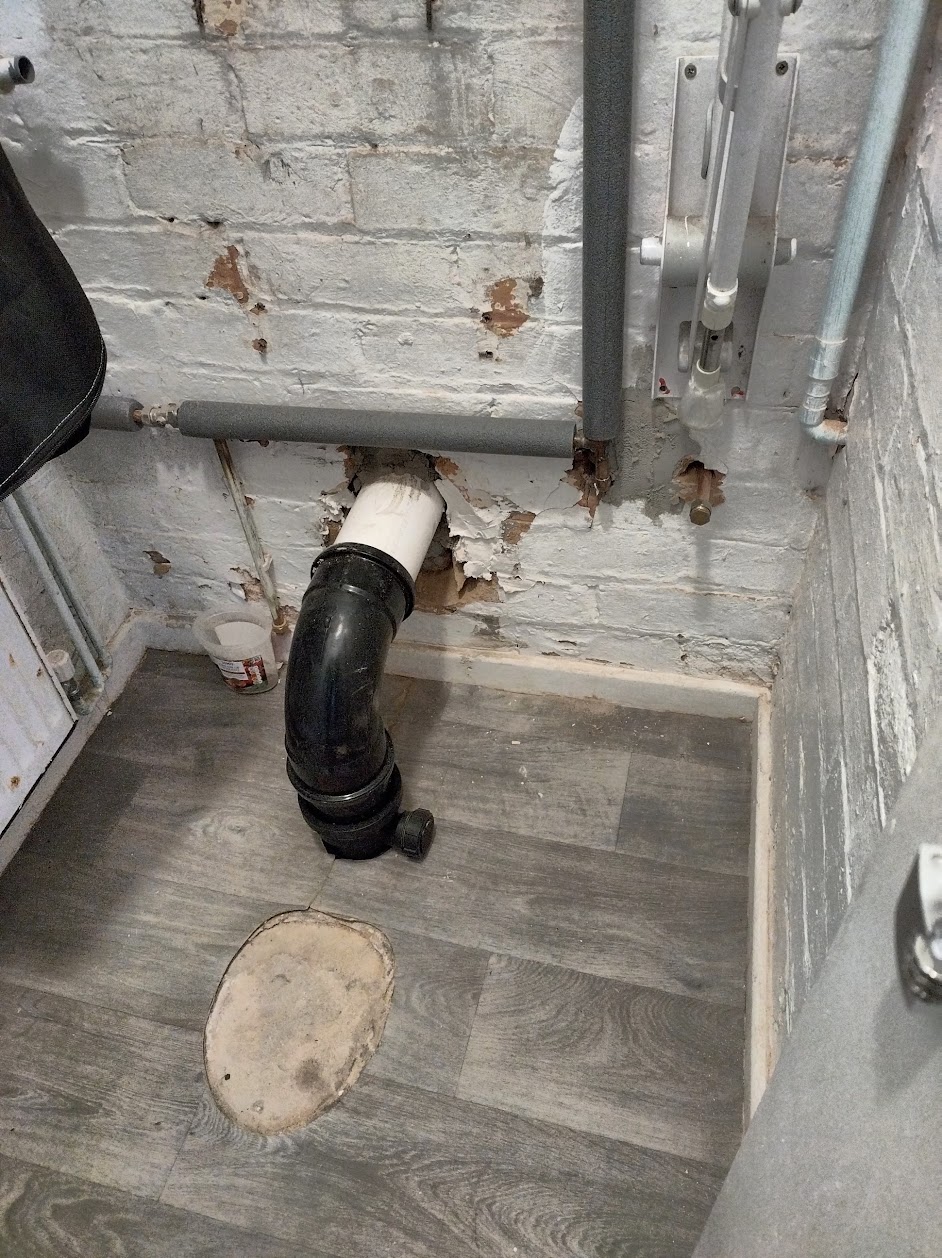

This is the under the stairs room with the new WC soil piping coming above the floor to the new WC...

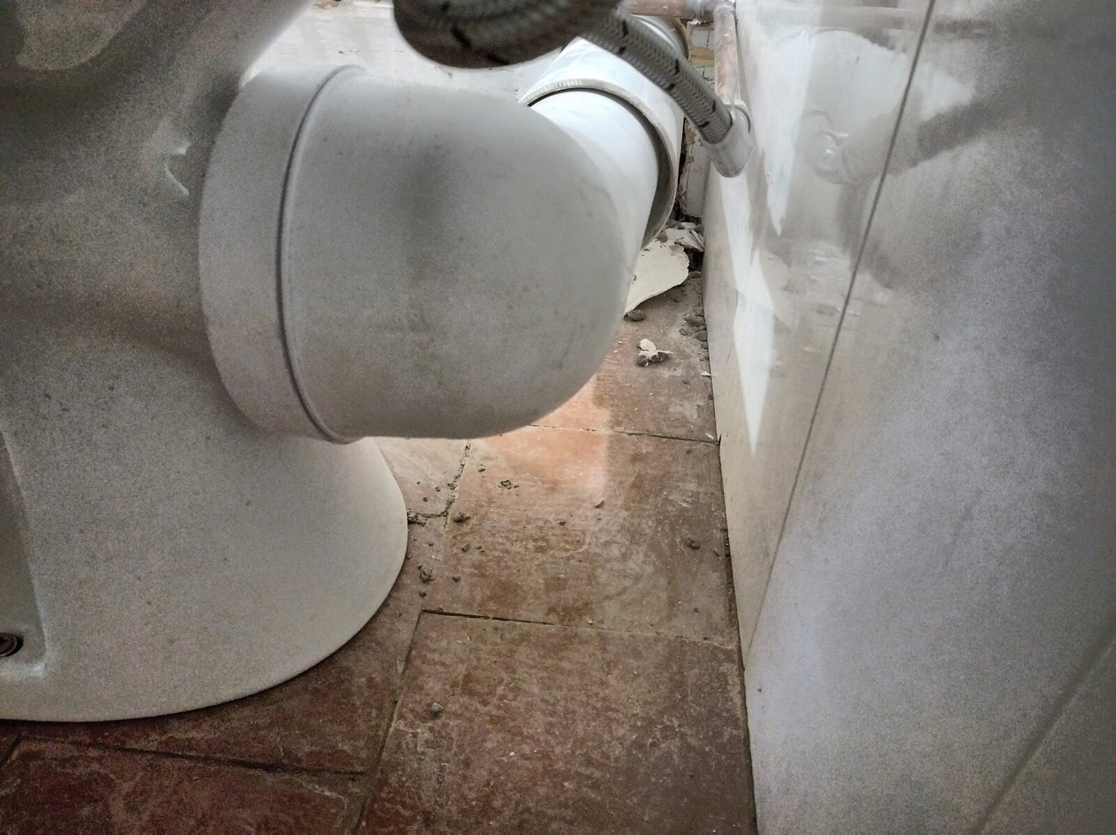

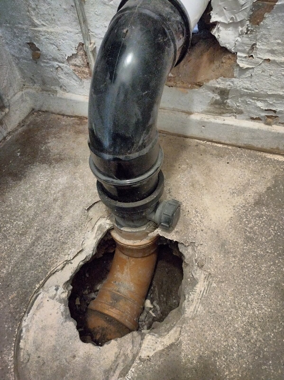

The 110mm piping comes through the wall and connects to the new WC with a pan connector...

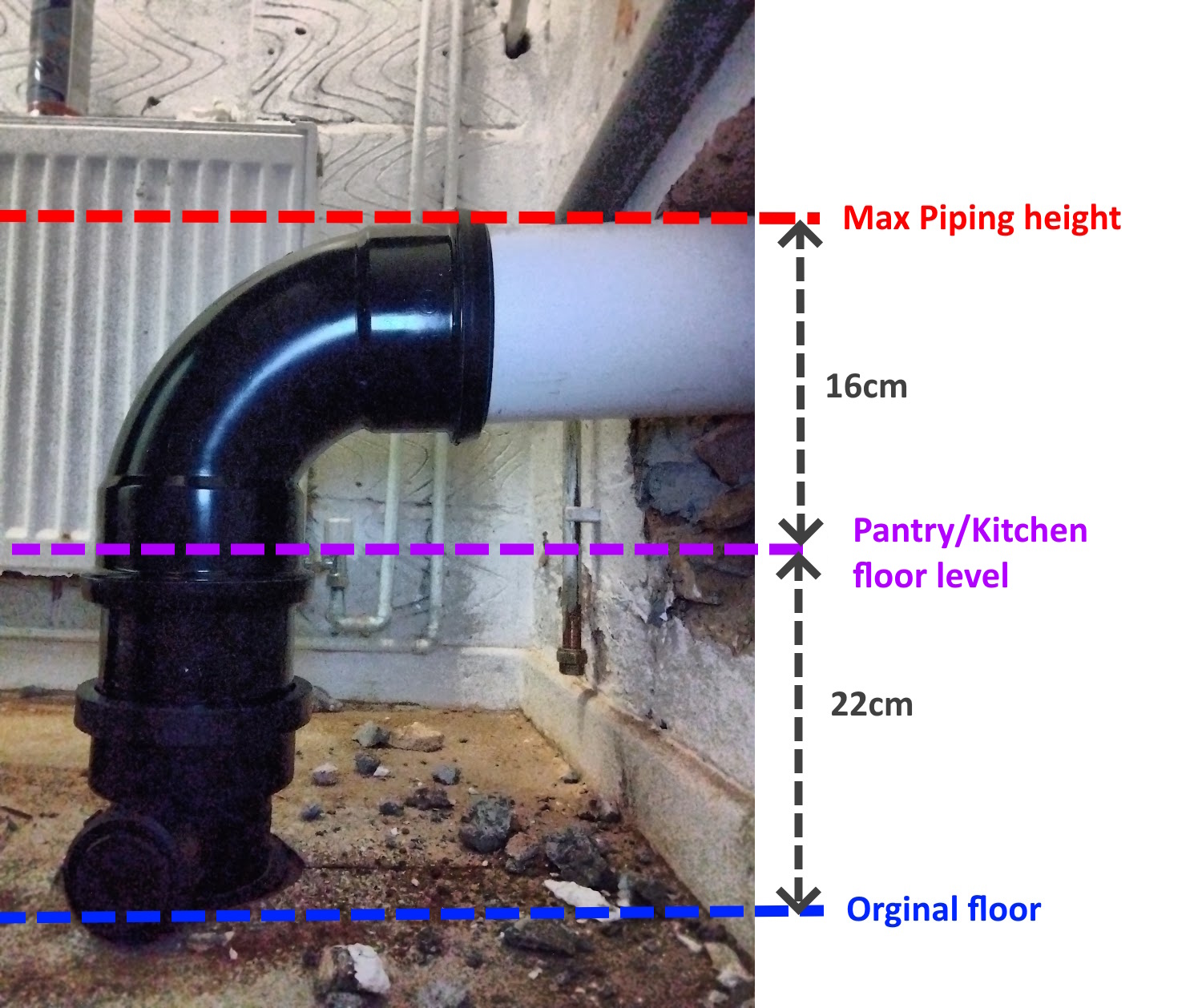

The soil stack is too high in the garage room...
We want to put a floor in the garage room flush with the kitchen floor (22cm high) and put a shower there. Be nice to have the shower on a low pedestal.

I would not recommend such a tight knuckle elbow for a soil pipe connection. It will be a bit of a faff, but IMO the correct way to sort that new height pan connection to your new desired lower point, is to dig up the floor to expose the soil drop and then work your way back up from there. Other connections can then be accommodated before your desired finished floor level. The last effect you want is the shower trap seal lost every time that pan is flushed.
Maybe you could use a couple of 30 or 45 degree bends to offset the pipe to the next room?

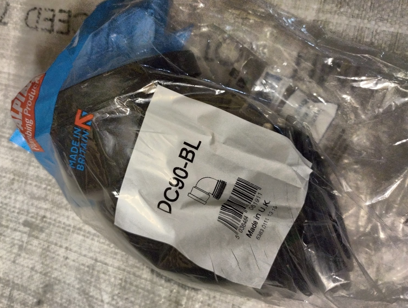

(1) DC90
Its finally arrived ;). I spoke to the tech manager within McAlpine earlier this week - he said that the DC90 was a "get out of jail" solution for these applications. He went on to say that its knuckle angle will work as long as there is min volume of 6 litres within the flush. I measured the Wicks WC and looks like the cistern holds 8,223 cm³ of water (8.2 litres) so it should work despite the lack of fall. A sensible plan would be to get it in, check it works, test it - and rollback out if problems start (by putting the old piping back). A simple option would then be exhausted before digging the concrete garage floor up.

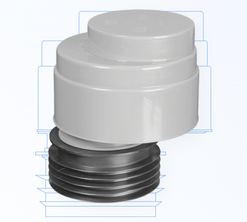

(2) Induced Vacuums & AAV
This does look like an unforeseen issue. I am hearing that AAV's (air admittance valves) are the solution or even on the smaller basin in the WC room an anti-vac trap? I am pretty sure the McAlpine tech said something about them needing to be at the "head of the piping", and I read something about them needing to be 20cm above the water inlet into the WC? I am just trying to work out where a 110mm AAR can be placed by understanding them.
https://www.diydoctor.org.uk/projects/air_admittance_valves.htm
https://assets.publishing.service.gov.uk/media/5a80cf9ded915d74e33fc8ae/BR_PDF_AD_H_2015.pdf
Ideally would be great if an AAR can be fitted on the 110m piping section in the garage (the plan was to make a stud wall to hide garage shower piping) and wonder if it could be put there?

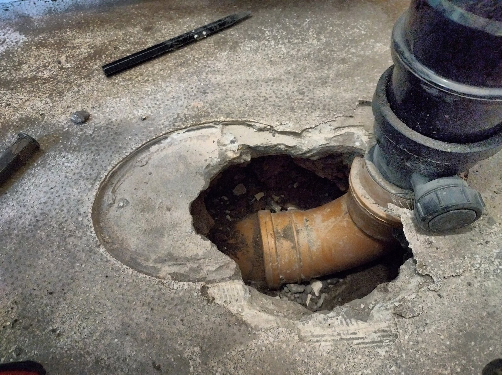

Think I have come to the conclusion that they may have had a point about digging up being the only option.
This is what we have at the moment...

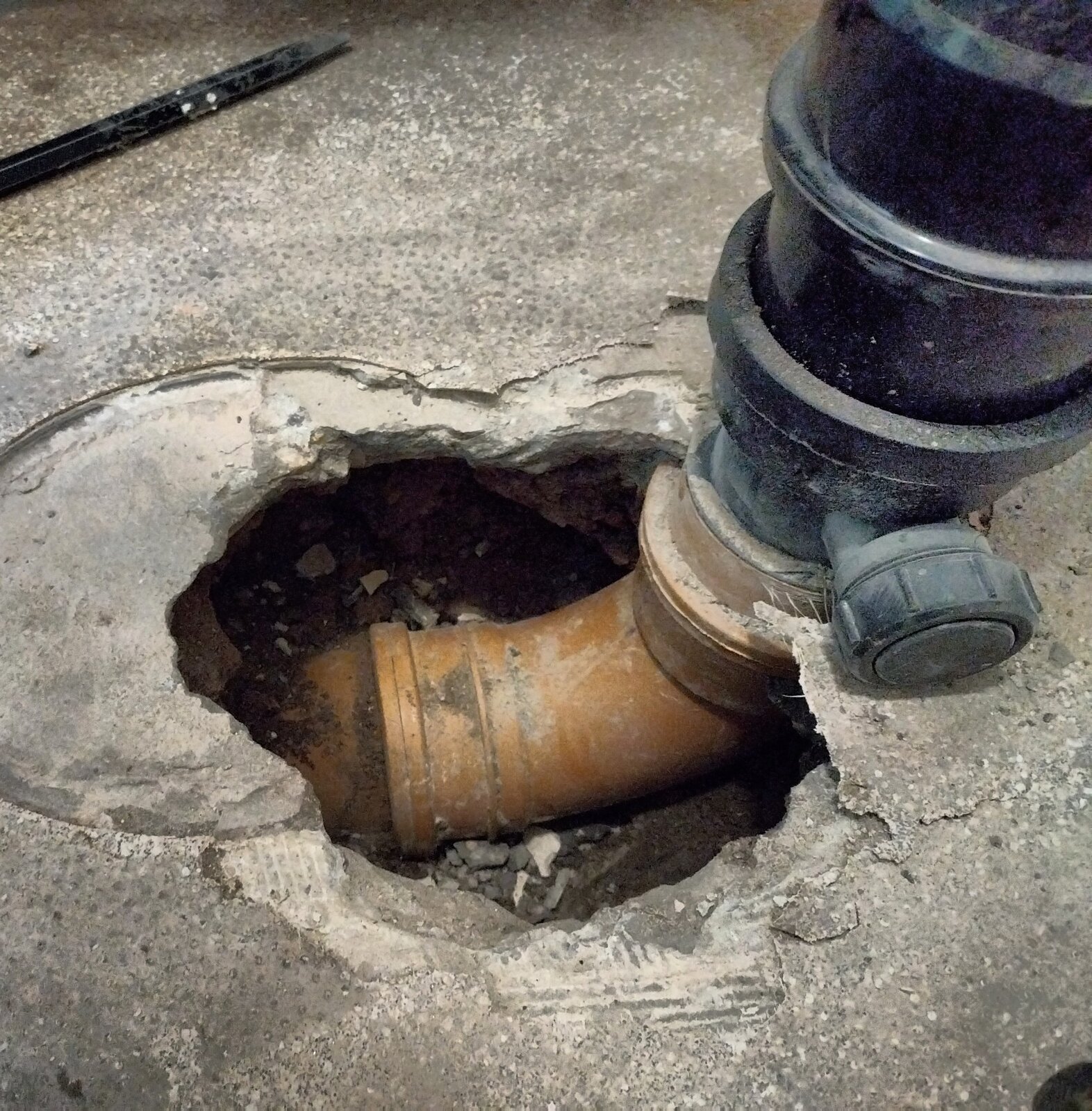

I reckon I can get that white 110mm pipe down to the floor level and that will probably be good enough to get a shower 22cm above this floor (level with the kitchen floor). Just have to work out how to connect to the below piping.

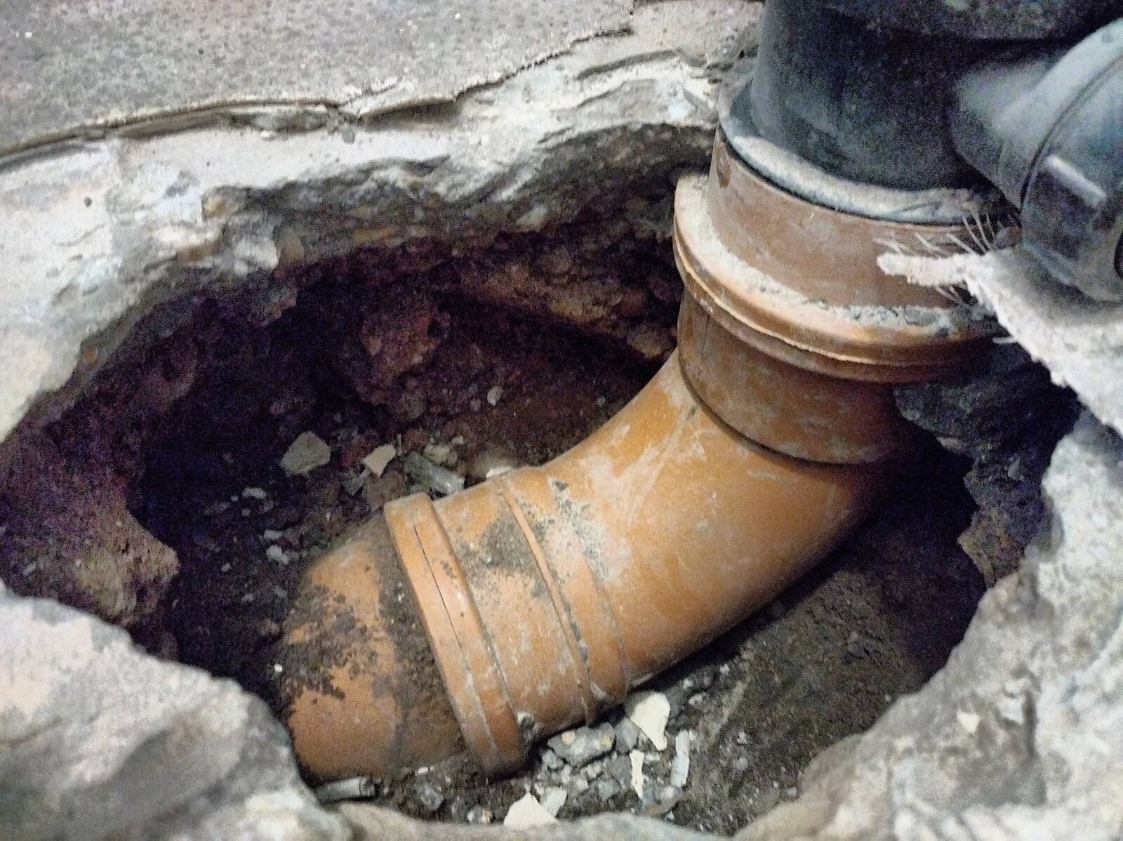

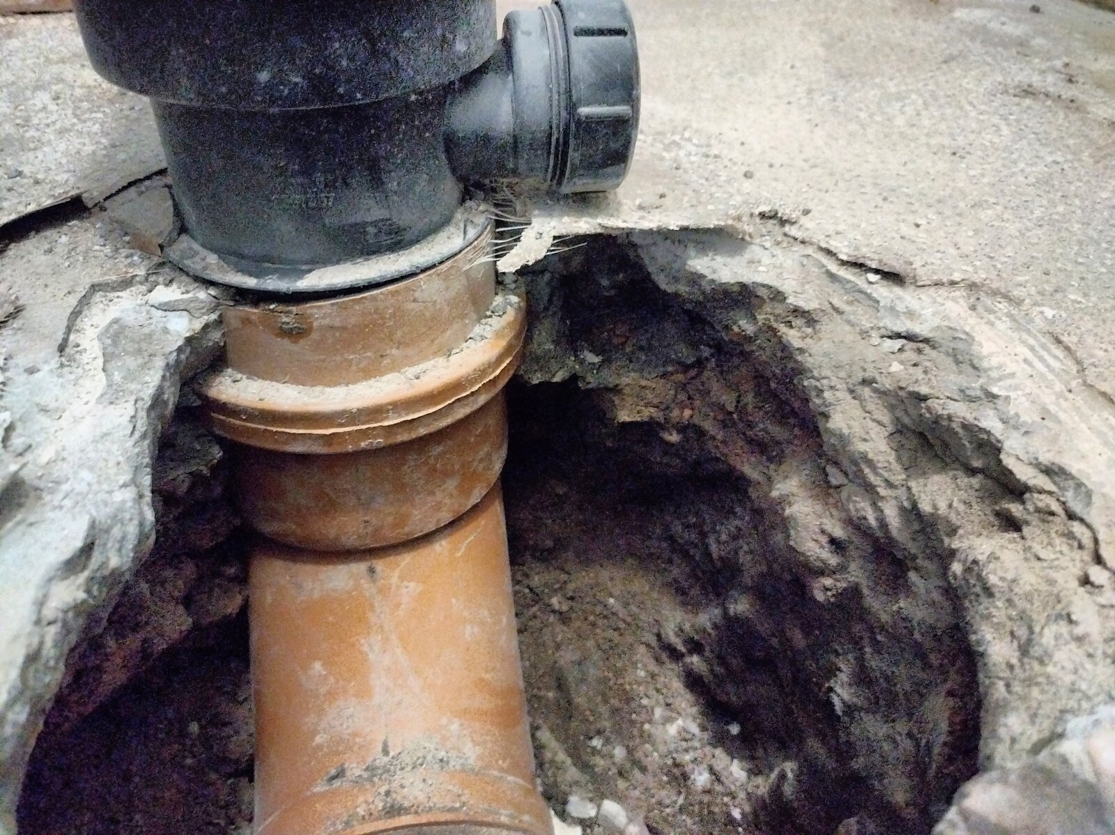

Digging up I see this...
Looks like a plastic brown swept elbow soil pipe which the black connector plugs into...

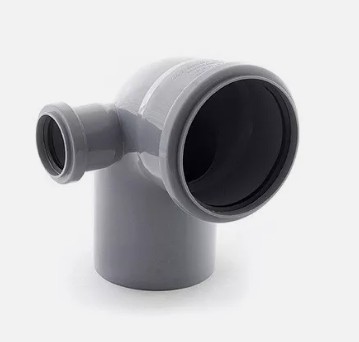

Could I instead use this grey elbow and connect its grey spigot end to the brown elbow?...
It has a boss which I can connect the shower waste and sink waste. The boss would hopefully be at floor level which gives good clearance for falls. Something like the below...
(1) The current large soil stack which is 38cm high and 16cm above the stud floor which would be put in to be level to the kitchen floor. The shower pedestal would have large step onto it (26cm and above).
(2) The previous solution with the DC90 McAlpine connector which does not have a boss inlet, was still a bit too high to get strap on waste connectors on the 110mm pipe for shower and sinks and therefore would have minimum benefit.
(3) Suggested grey Elbow connection lower down onto the floor. This grey elbow has side inlet (hopefully can sit just above the floor) and be used for the sink and shower waste. A coupler would permit a 110mm pipe to run along the garage floor and into the adjacent floor underneath the quarry tiles and to up to the WC. I assume the grey elbow spigot end could not be above ground and as the 110mm end may not slot into the current under-the-ground brown elbow 110mm pipe?
...This sound like a plan and any other ideas for connecting to the brown plastic underground elbow?

I'll relent, and give my take on what to do, given you've now done what you were told to 12 months ago...
Dig some more out so you can run the 110mm across to the wall under the floor. The bend will need to be replaced anyway now, the seals will have hardened and it will leak if you try and reuse it. Remove enough material to expose around the bend, and remove it from the end of the horizontal run. Fit a Coupler and continue the pipe to the wall, before putting a new bend on the end to bring you upwards.
A short Boss Pipe in the bend coming up may get you the waste connection you need at the right height, then ideally from here, come up, fit a Junction to accept the WC from the other side of the wall, then come upwards a bit more from the junction and fit an AAV. This can be boxed in as required, fit a small vent in the boxing to allow airflow.

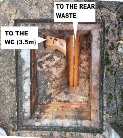

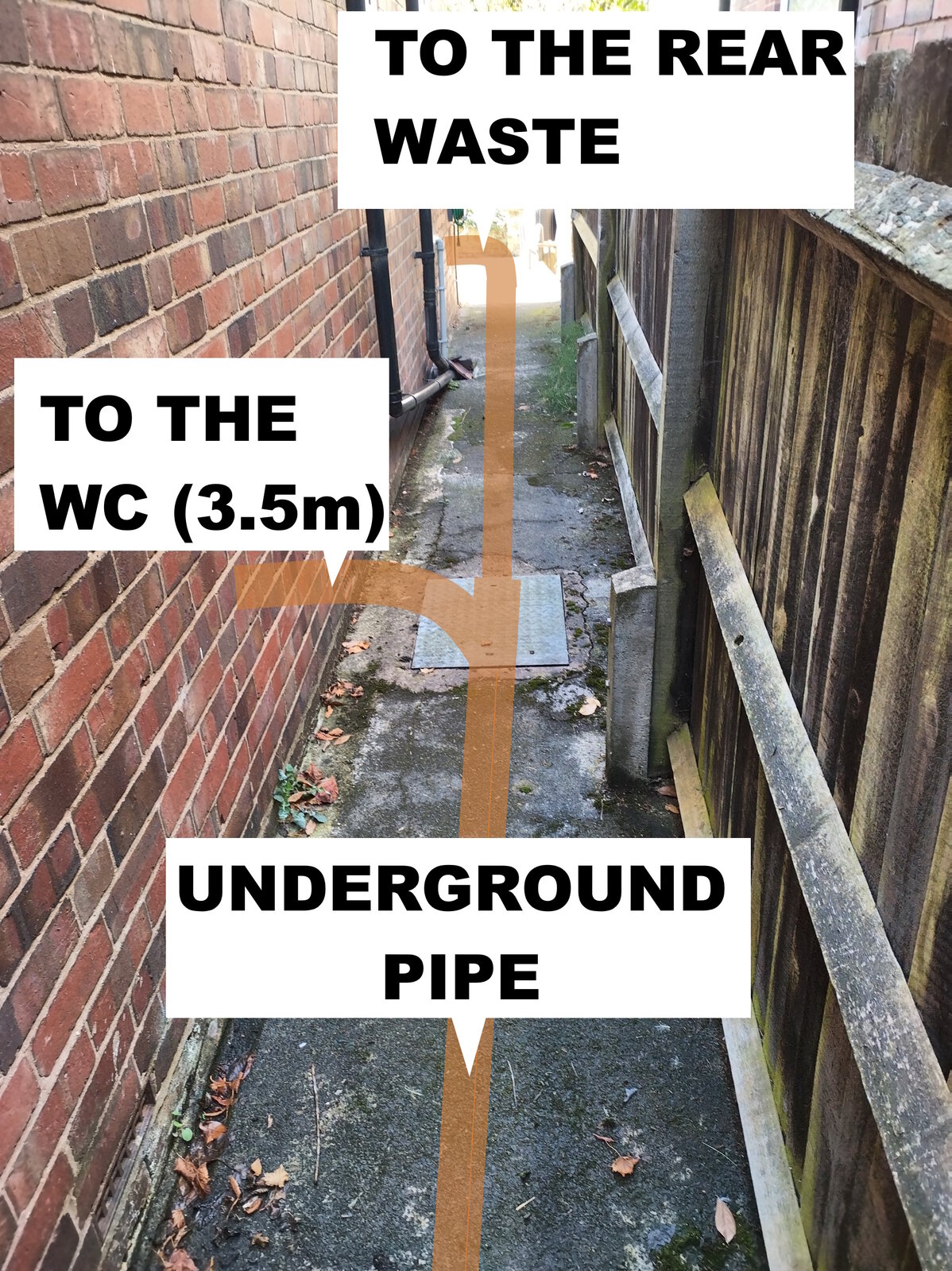

Hi, good to hear from you and thanks for feedback.
Had confidence to dig it up as found plastic piping in the manhole outside to the downstairs WC.
I think I get what you are saying about the connections. Some quick queries...
1) Is the AAV necessary if there is only a 3.5m distance from manhole to the downstairs WC?
2) And would a smaller AAV (32mm, 40mm, 50mm) work instead if its a short run?

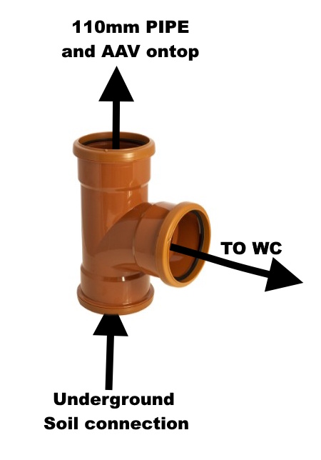

Hi, if you're asking me to do as suggested, would welcome your kind engagement pls to ensure I understand the helpful suggestions.
Is this the plumbing part being suggested into the WC?...
