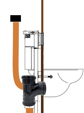

WC Soil Piping needs sorting :-(
4" Through the wall.
Into a branch tee.
Up to durgo in the left hand corner.
Other socket of tee then goes to pan.
Orient branch tee as you can (either vertical or horizontal)
Use Rigid pipe over to pan so you use a multi quick or straight pan con from spigot to pipework - not a flexi pan con.
Your diagram shows a wall hung pan.
You don't need to.
Floor standing back to wall.
Into a branch tee.

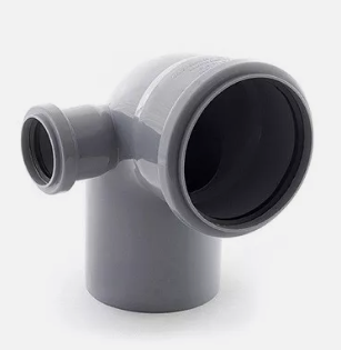

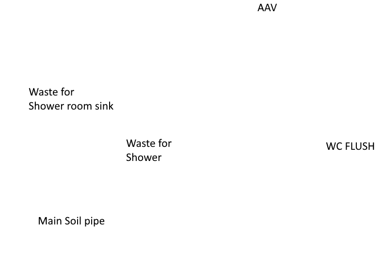

Hi ...any chance it can be stated less technically for us simple folk over here??

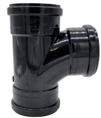

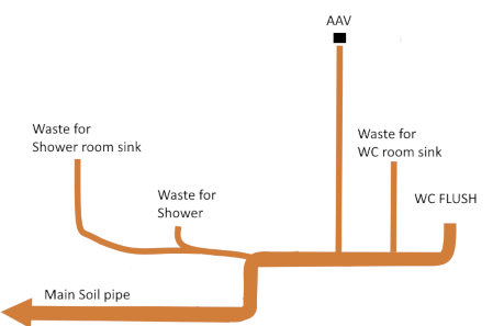

Are you saying, something like this going to be at the main junction?...
Because there obvious issues with the necessity of the stub stack going straight up...

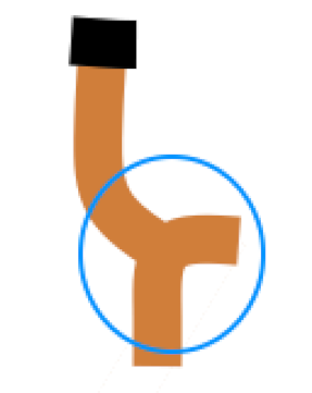

As I do not want to move the WC anymore forward (its in a small room) - is there some kind of junction which has an offset bend going up vertically off the main junction? - to move the AAV backwards...
Or maybe re-word your kind advice, I will try and figure it out.

Arrange the branch so that it point the middle socket up on the left hand side of the cistern and put section of vertical pipe and durgo there.
Continue piping across to go into pan spigot using an m&f elbow if required, then a bit of pipe in the m&f and a multikwik pan con into that

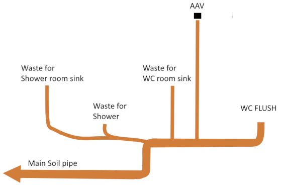

Could you let me know in principle, if the below setups are okay?
(1) The AAV does not have to be attached at the start of the Flush to get air in behind the flush? It will work further away from the flush? (in below example the AAV is before any sink or shower waste)
(2) Would the below AAV example work as well? or does the AAV defo have to be before any sink or shower wastes to prevent siphoning?

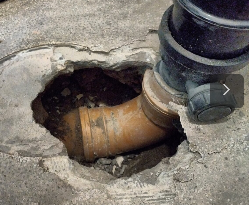

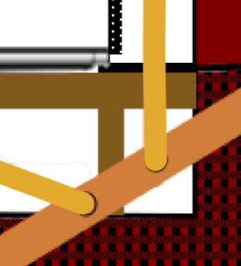

Change this brown 90:
For a 45 or shallower, such that you can go straight to the toilet, rotating the toilet coupler to suit
Use waterless traps on your other devices, to dispense with the need for an AAV

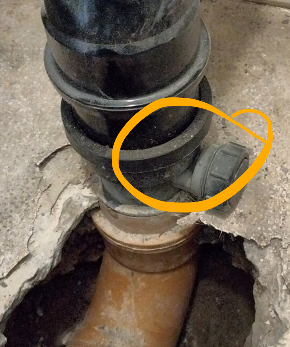

-This grey elbow inside the current 90 brown elbow (or new one) would provide a boss connection on the garage floor - looks easier for waste connections with the max fall...

Just welcome knowing if the AAV needs to be in front of any waste connections so it provide air to the flush vacuum?

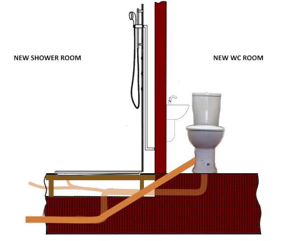

The 45 was just a guess based on the positioning of the toilet in the pictures (it seemed to be more or less just the other side of the wall), you can get other bends, and even fully adjustable ones like Screfix item 77224
Over that distance and that close to the flushing appliance it won't matter about the angle; soul pipes have shallow angles to prevent water rushing past the solids it's flushed with leaving them behind in the pipe. You're supposed to use larger radius bends when going from a vertical to a horizontal, than is presently installed in your location

Boss connections can be made anywhere in a run using Screfix item 82795
Your saying that the falls are not an issues over these smaller distances? - as long as there is some fall, large or small.

A 45 degree bend may be feasible, but some trigonometry is required to precisely determine the pipe's final position. It would save some digging. The setup may involve extending the incoming horizontal run, then using a 45 degree fitting to rise into the WC. The pipe must pass under a stud floor with a shower on top, that is 22cm high, which also should provide adequate space for those strap on waste connections.
Drains have a specific maximum steepness for working effectively, and it's very shallow, nearly flat, because you want the solids to slowly float along at the head of the plug of water emitted by the toilet. Too long of too steep a run, and the water makes its way past the solids, eventually de-floating them and leaving them sat in the pipe. A short angled run that close to the toilet isn't going to be a problem because the solids are going to be at the bottom of the section before the flush has even finished, with water still behind to float them along

Those strap bosses don't have to be installed on the top of a pipe. If a pipe ran at 37 degrees and you installed a boss on the top you'd need a 37 degree bend to come level. If you installed the boss on the side of the pipe, you're already level
Is it possible to install a 45 branch pipe
Like bosses, branches don't have to be installed so the bent bit is face up. You can have a 90 branch on its side on any degree of run and it is innately level to which a 90 can be installed to come up
Installing a branch just so you can install an AAV is unnecessary; the waterless traps are already AAVs. It's your money though!
So the 50mm waste branches can be stap-on connected to the side of the 110mm soil pipe? Doesn't that risk waste getting caught-up on the entry to the 50mm piping, or any bad 50mm-110m connections leaking if the flush water is going past?- whereas if the strap on was at the top - it wouldn't?

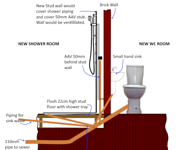

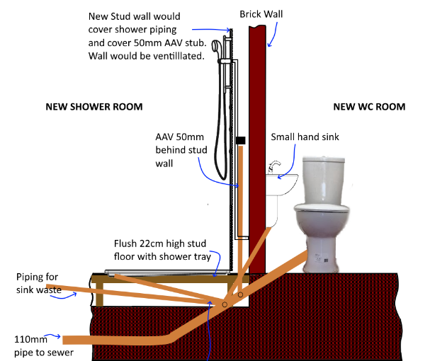

Do welcome being in touch to work out a final design. As long as the angles work out - something like the below with waterless traps?...
(it would be better if the 110mm pipe comes through the current hole in the wall without having to go through the WC room floor)
No, because you do a good job of the cut, remove swarf and smooth rough edges, and don't jam the waste so far into the soil that it becomes a catch point. If you look down the bore of the soil it should appear smooth all the way down
You'll note that the the boss built into your existing bend is also on the side, not the top
so it a bit of extra protection is piece of mind
It would be easier to reprogram your mind to see the lack of necessity for another AAV when you've already fitted three, and don't have any water filled traps that can have the water sucked out of them, but if you insist, why not boss a HepVO on behind the toilet ?
I assume 50mm AAV is big enough to get some air behind the flush over this short run?
The toilet itself also admits air, so the situation is nowhere near as desperate as a multitude of armchair/keyboard warriors may have led you to believe. Why not try without and then fit one after if it turns out there is a problem that needs solving?
Yeah that would work. Not sure I'd bury the AAV in a wall though
