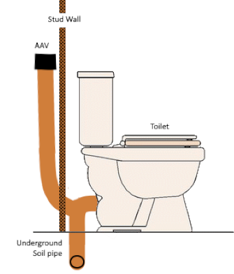

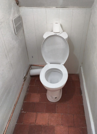

Does anyone know what kind of 110mm connections from the WC can make this piping arrangement (where I can put put a AAV behind a WC stud wall)?...

Hi, thanks for the reply.
Beneath the WC are quarry tiles, then a small 1cm layer of cement, with loose soil under that (maybe ash substrate).
The AAV could be put behind the WC and behind the white stud wall - with an access hatch for maintenance?
Not sure if I could put the AAV on an upright pipe coming of the 110mm white pipe going into the next room (or if the AAV "has" to be at the start of the water flush inlet??)
Welcome anyone's thoughts - can post up a diagram of what I am trying to do if this is not clear.

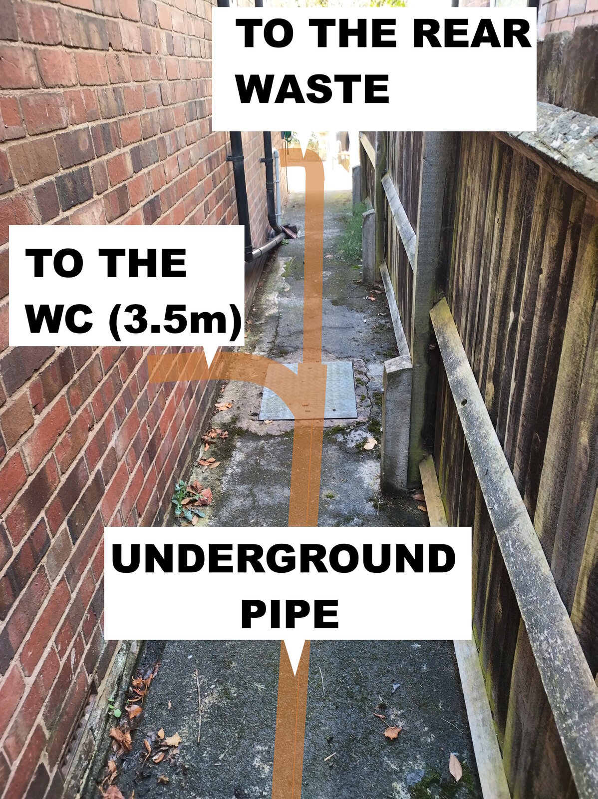

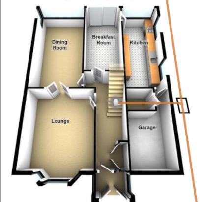

Hi, from the WC, which is under the stairs, to man-hole to the side of the property its 3.5m.
There will be a shower room put in the garage room, this will have sink and shower waste connections going into the soil pipe running to the manhole.
The concern has been that the flushing the WC would siphon out from the shower and sink traps and then allow odours.
Hence a AAV should be fitted near the WC to ensure that soil pipe is vented? Do you think its needed?

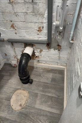

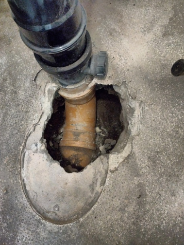

Hi, the soil pipe goes directly into that WC.
Part of it the soil pipe is underground and then it pops up out of the ground into the garage (where the WC used to be) and then through the wall and into the moved WC.
It has been used like this for the last 6m with no issues.

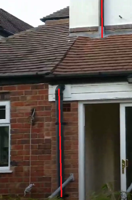

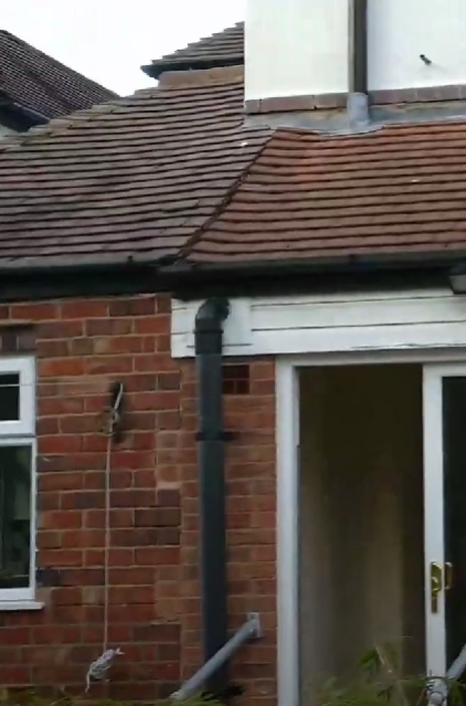

Where is the nearest vent pipe?
There is soil stack at the back of the house - far away to get to from the front garage. That pipe is plastic at the bottom half and then metal top half. The upstairs WC, sinks, bath and shower wastes connect to it and it goes up in the air and is probably vented at the top - I assume this is the vent pipe you're asking about?

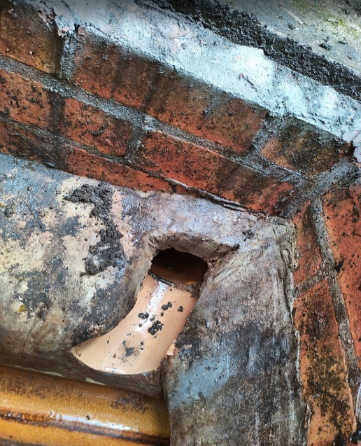

Digging up the garage floor and attaching to the clay pipe lower down is really is going to be a massive faff and I assume raises all sorts of risks if that piping (probs clay piping in old 1940's house) get damaged.
Everyone wants a simple solution, but if that won't work... Guess what!

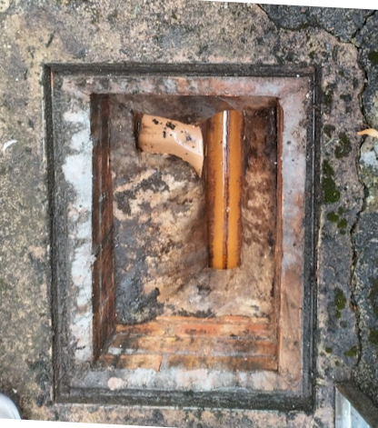

Thanks. Your re-post is about digging the pipe - its not work-shirking its about risk reduction. We've established by looking through the manhole that the pipe is plastic and it has been dug up already to be inspected.

Thanks. 50mm or 110mm AAV then.
I understand that it should be... "at least 200 mm above the highest overflow level of appliances on the soil pipe, usually at the top of the vertical stack, vertically oriented, and in an accessible, ventilated location."
Does that mean it "has" to be at the start of the water flush - behind the WC? - or can it be along the soil pipe close to the WC?
Is the key that is has to be before any strap-on waste connections to sinks or showers? - so it can let air in behind the flush and prevent a vacuum following it?
