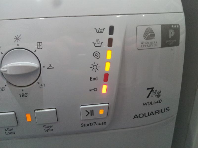

wdl540 error code desciption needed
22 Apr 2013
3
Bradford
Hi there
I can't find a list of the error codes for my washer. It fails during drying after20 mins or so and flashes this
Can anyone help?
Cheers
Andy
Error f15. Dryer relay fault. Check heater and fan going round otherwise pcb faulty.
Is the pcb you refer to the pcb at the back of the dials or the module in the base of the machine
Cheers
Andy
