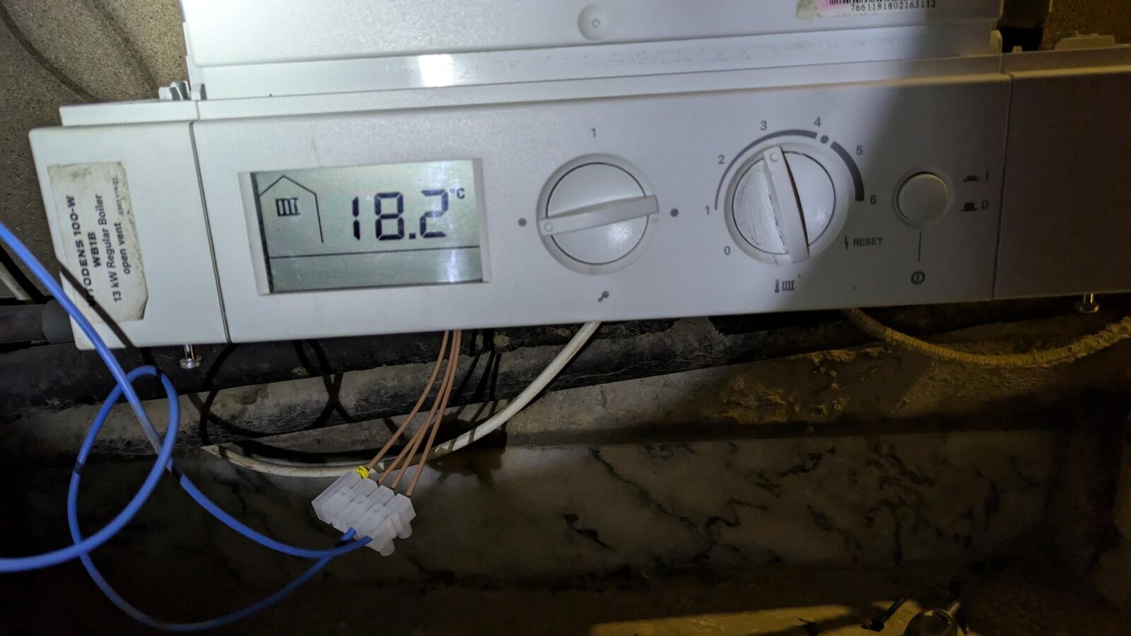

I have the same issue, mine is an old boiler (dial type) see my post on the issue which I posted in Nov25. Haven't been able to sort it out, the sensor is brand new and the resistance values are within range of a working sensor as per MI. Mine just stays that way as per photo, no flame symbol, i have waiting for quite sometime in hope that it will fire but it doesn't. Contacted viessmann tech support but they couldn't help either.

I am wondering if you guys are properly setting up the boiler to use weather compensation.
This video seems to cover the procedure.
Just checked the resistance, getting around 13 OHMs replaced wiring, and back to same problem, temp at boiler fluctuates up up to 30+Deg
Removed weather sensor wire and boiler working normal at 70 deg
So, although the sensor is giving the above resistance I will change the sensor as the connections at both ends looks good, presumed that with the sensor giving a reading the wiring would be ok.
Question, do I need to use a Veissman sensor as the one that was in use appears to be the origional installed with the old boiler 24 years ago
Most boiler weather sensors are about 10k ohms. Thats 10,000 ohms.\
Are you sure you are quoting us the right meter reading?
