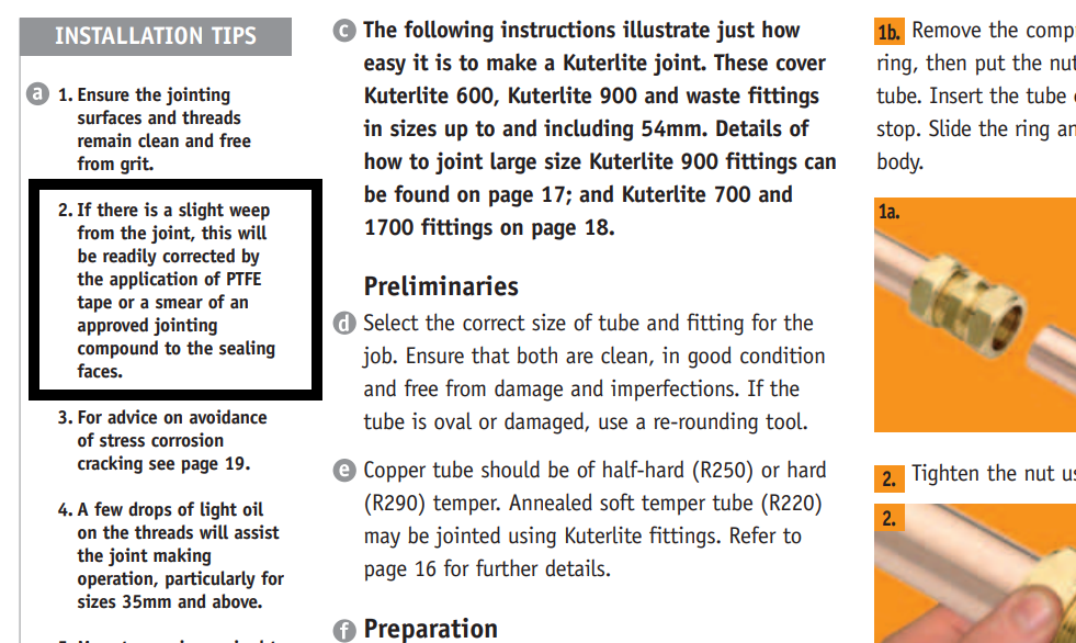

Never used to use anything on compression joints but with the poor quality of fittings these days and the fact i started getting a lot of fittings weeping has meant i now use jet blue on the olives. Since then, all good again.
Reading really does wonders doesn't it.
In the same document Peglar tell you not to add contaminants, etc and to make sure the joint is clean.
Its also noted that unlike the cheaper Prestex range, Kuterlite requires less assembly torque.
Peglar specifically tell you NOT to use jointing materials on the Prestex range, which i think is more akin to the plumbing sector than the industrial Kuterite range.
So, like has been said above, follow the manufacturers recommendations but, you also need to aware of your own requirements.
If a joint is leaking, replace it. Peglar do not tell you to tape every joint, nor would they because that generate system risk. Only as a afterthought should something leak. i.e. a one off.
In a industrial application, you wouldn't get the use of PTFE tapes or jointing compound passed on a MS.
Where fittings leak on pressure test, you would expect it to be replaced, not taped up.
