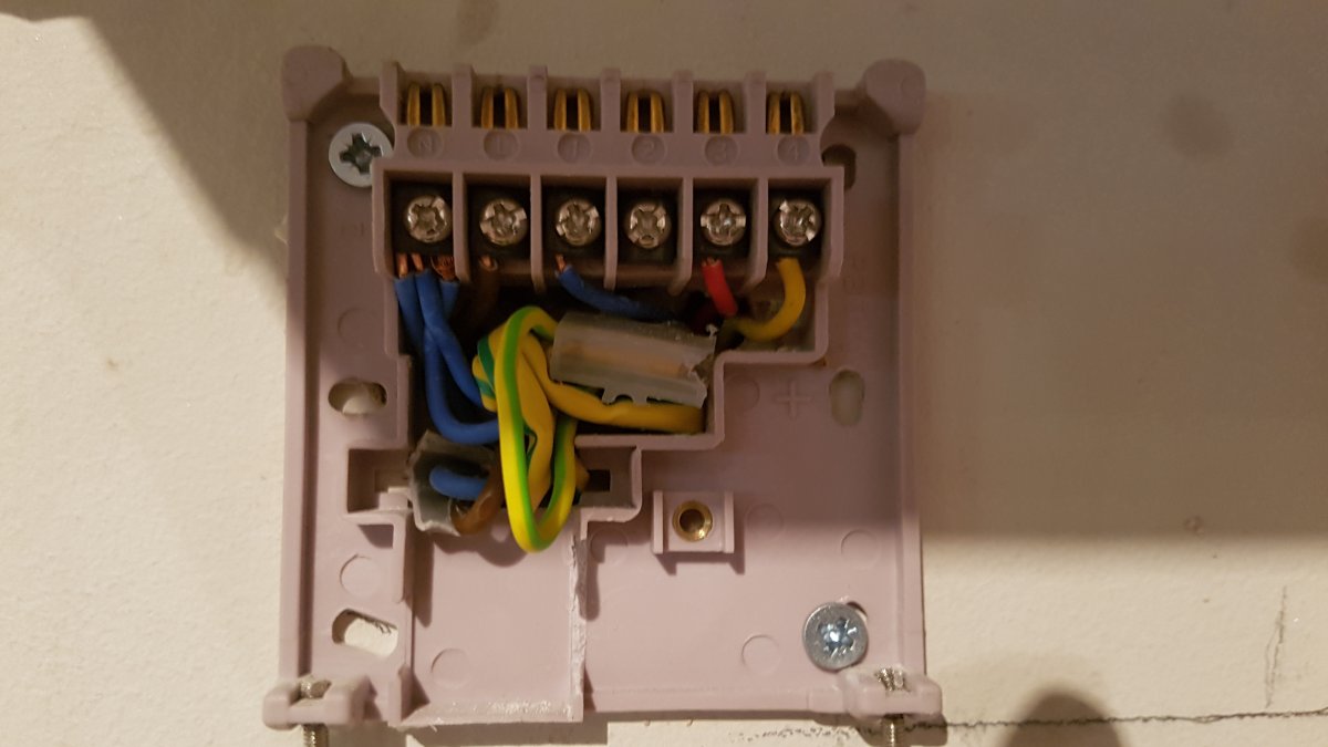

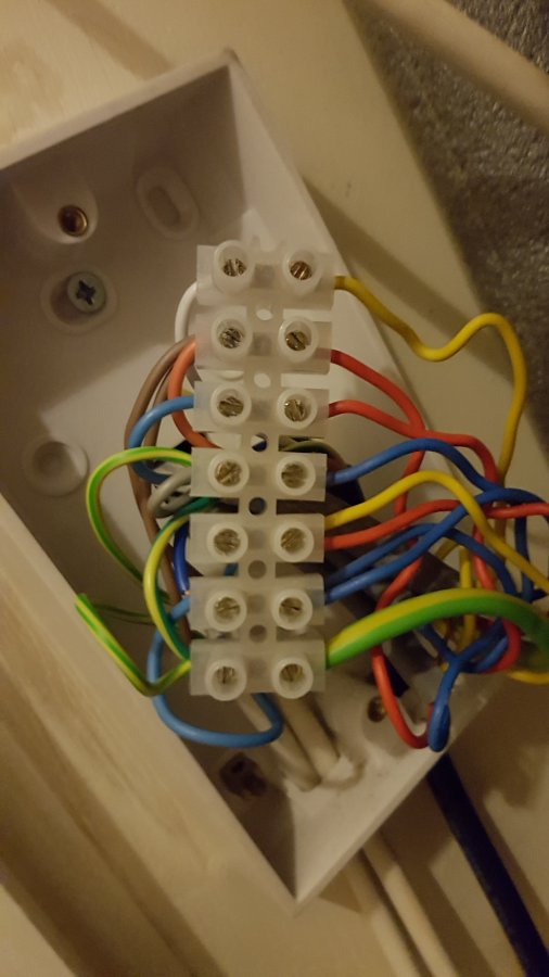

well I have had 3 people out to my boiler now.. long story.
turned water off and ch is on but thermo not calling for heat and boiler fires up and rads get hot. whenever water goes off rads go on regardless of ch setting on controller or thermo setting. now I've set ch and water to off on controller and boiler is still on and rads getting hot.
if I have water and ch set to on on controller (but water is hot) and call for heat on thermo then the 3 way valve just clicks.
see pics

with both ch and water set to off on controller I have 240v on the orange/brown/brown for a few mins the boiler goes off and it drops to 0v.
I always have 240v on the grey/earth combo (why is there an earth jammed in with grey?) the earth is from the boiler tstat.

valve just been replaced, i have completely powered it off already a few time before to no avail. Its a honeywell 4073a, there is resistance and whiring.. and it does go back to auto.
Well from the mass of wires it does appear logically to be wired correctly, even if it is untidy. The only thing I can come up with that would get your symptoms is the cylinder stat being wired wrong, or the valve is faulty.
Edit, if ch an hw are off when you restore the power the valve should stay closed (hw only position) the motor should not run.
If ch is the last to switch off, the pump/boiler should stop but the valve will stay fully open at ch only.
so if water goes off - cylinder stat being wired faulty would cause heating to ALWAYS come on?
any ideas on what wire/s is wrong and where they should go? I did look at some diagrams but with my day job being I.T I quickly felt out of my depth.
it's an ideal ff240 and honeywell.
re hw off... on my controller there is no wire in the hw off... is that a problem? it's on one of the pics
HW off is terminal 1 on the programmer. There is a blue wire in it which should (and appears to) go to the grey wire on the valve.
If by boiler you mean cylinder, then yes that's correct, the wire (which should have a red sleeve) should be connected to the hot water satisfied terminal in the stat (terminal 2)
