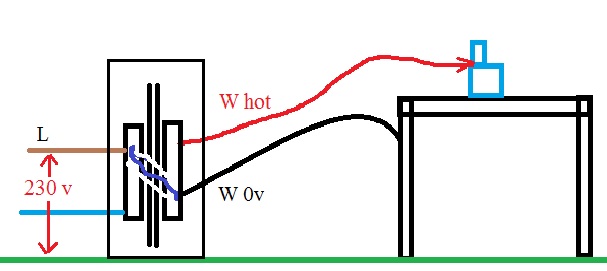

    What happens to the person welding standing on the ground potential floor ( green ) when the transformer insulation breaks down ( purple ) and the bench comes Live at 230 volts above ground.
    If the table is Earthed then the Earth leakage protection will ( should ) operate to remove the 230 supply to the welder before the person gets a prolonged shock.
  12. FrodoOne
    FrodoOne
    Joined:
    20 Feb 2017
    Messages:
    332
    Thanks Received:
    35
    Location:
    Melbourne, Australia
    Country:
    Australia
    Assuming that an RCD or RCBO is installed !!!
    However, if all metal components are bonded together and connected to the PE (and, hence to the return to the source) the Circuit Breaker/Fuse will operate.
    If the "Ground" is a metal plate bonded to the metal work bench and BOTH are connected to the PE, as I discussed, the person concerned will be even safer - since all parts of his body will be at the SAME potential and he won't receive any shock (even if his potential is raised somewhat towards 230 V AC until the circuit protection operates).
