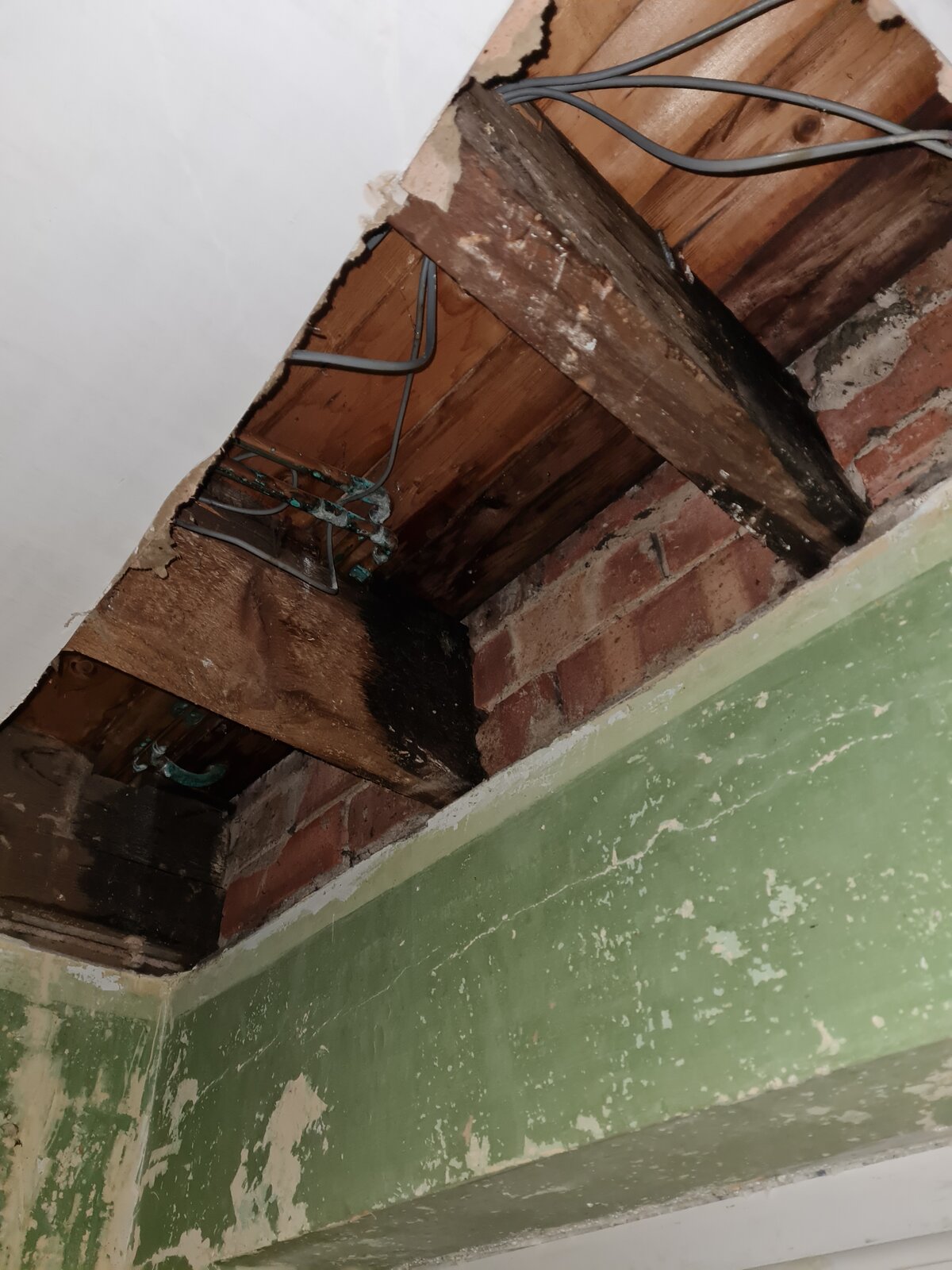

Hi
I had a wet patch appearing on the plaster above my front door so I removed it and found that the beams are wet on their ends.
Does anyone know what could be causing this?

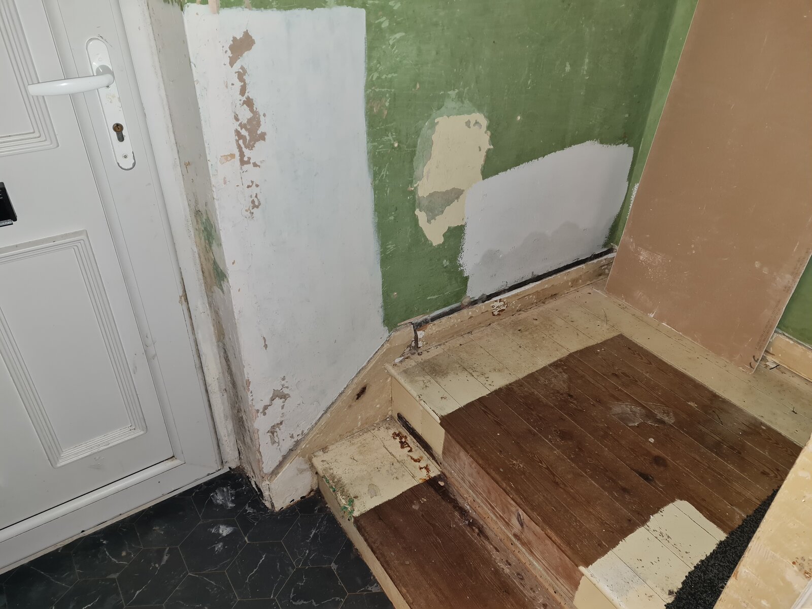

Also there is a damp patch on the wall beside the door but unsure whether they are connected...
Thanks for looking
richm81,
Whats in the room above the wet upper floor joists?

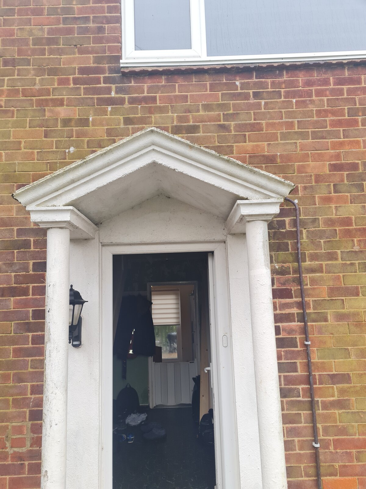

Where is the front door in the first pic?
Whats on the other side of the wall the wet joists go into?
Can you post pics showing outside the front door?
so so much looks like a bath or shower against the wall leaking around a wall seal above
rather than outside to inside as out to in would tend to be reverse angle where greater spread to bottom edge off joist rather than diminishing from above towards joist bottom edge
you can see where the water is coming down from the floor above...then running along....that water from above, not from the wall ingress
The door is the white bit at the bottom of the first picture...

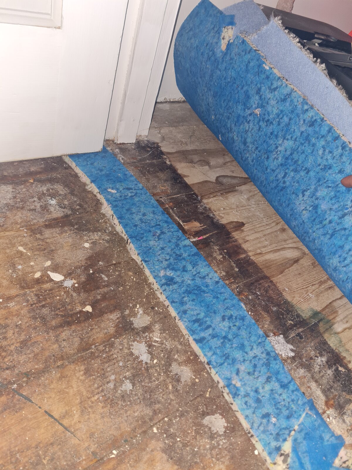

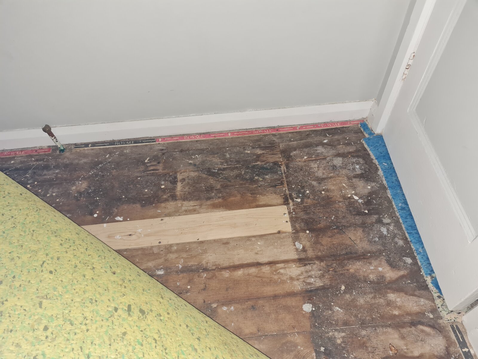

I am attaching the outside of the door and the second picture in this reply is the upstairs bedroom above the door (door is basically where the red carpet gripper is

Thanks for the pics - what I was also looking for on the front elevation view was a pic at ground level that might show info ref the low level interior damp.
However, the elevation brickwork pic shows greenish staining that could have resulted from your blown CWI becoming wet from the leak? Damp could also have moved down the cavity to present on the plaster near the bottom stair steps?
There are bricks above the wet first floor level that also look stained so my explanation ref damp CWI might be wrong.
Wet pipes could be seen in your first pic perhaps the leaks are weeping from the sketchy looking soldering?
Or carpet grippers might be suspicious? Lift them & check nail lengths.
Lift the strip of carpet & note the length of nails used to fix it.
Use a torch & a mirror to look at the pipes .under the door threshold.
