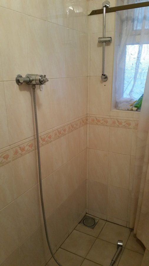

Which wall is the shower valve on could it be a shower feed pipe in the wall, or waste pipe leak, need pictures really always better with something to look at.
Andy.
Shower is on same wall. The mixer tap was fitted in January. The plumber who fitted the shower mixer has been back to find the leak and did not suspect the shower.
Is there a void that pipes run down behind the tiles or do they touch the walls.
Could it leak from an olive on the shower, down the pipe without touching a wall (and so not affect the tiles) and drip down where the pipe bends to go into the kitchen.
Would a leak from the shower install drip down the front of the tiles or down the pipe
I would suspect the pipes to the shower valve do you se what was behind the valve when it was put in does the wall sound hollow, water would run down the pipes to the floor if the tiles and grout look ok i think that's what your problem could be.

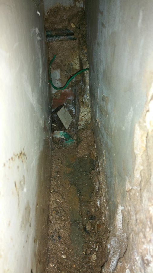

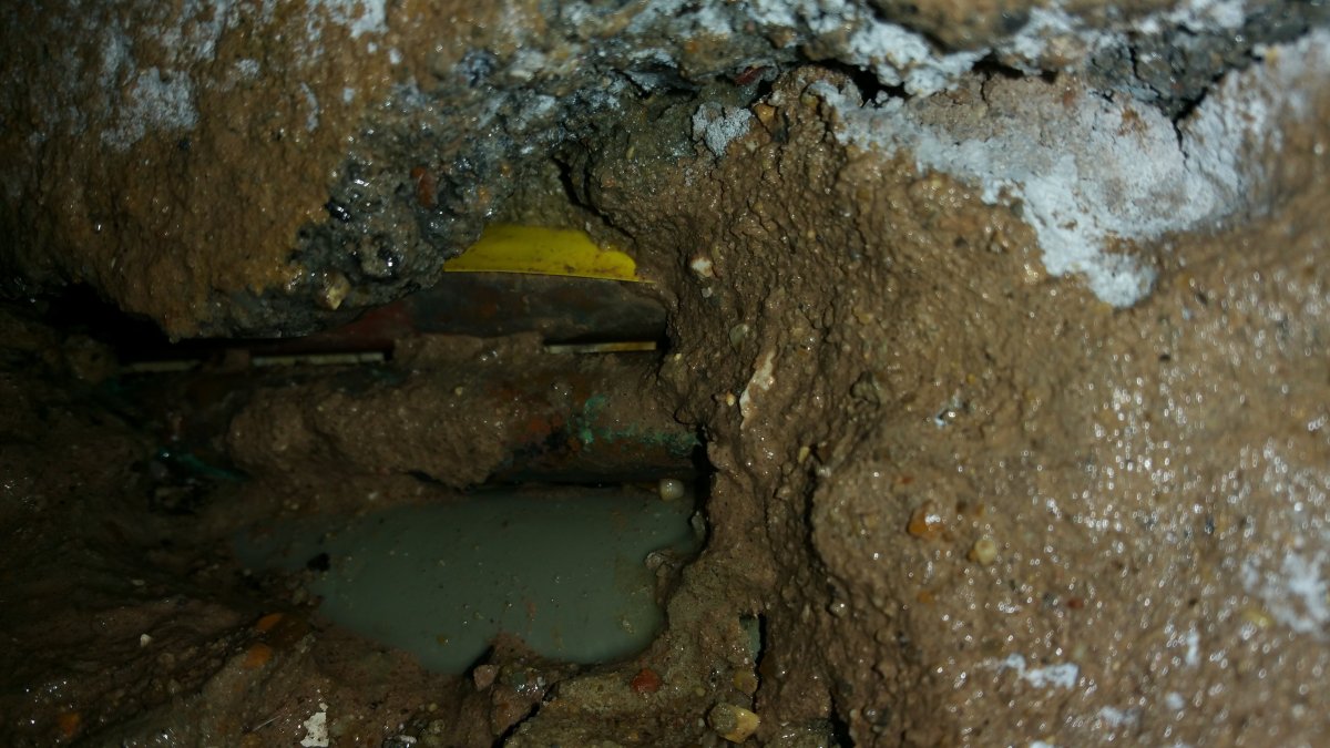

I have been around again.
When the mains water is on I can see water coming into the gap behind the cabinet from the floor and a drip from the wall above the hole in the wall. This stops when the water is turned off.
The pics show behind the kitchen cabinet where the water is pooling, the hole in the wall, dont know what it is for but I can see some pipes there and a pic of the shower which is on the other side of the wall to the cabinet.
At least I know it is not the grout.

Yes as Steve says the pipes in the void don't look to good I would be checking those
