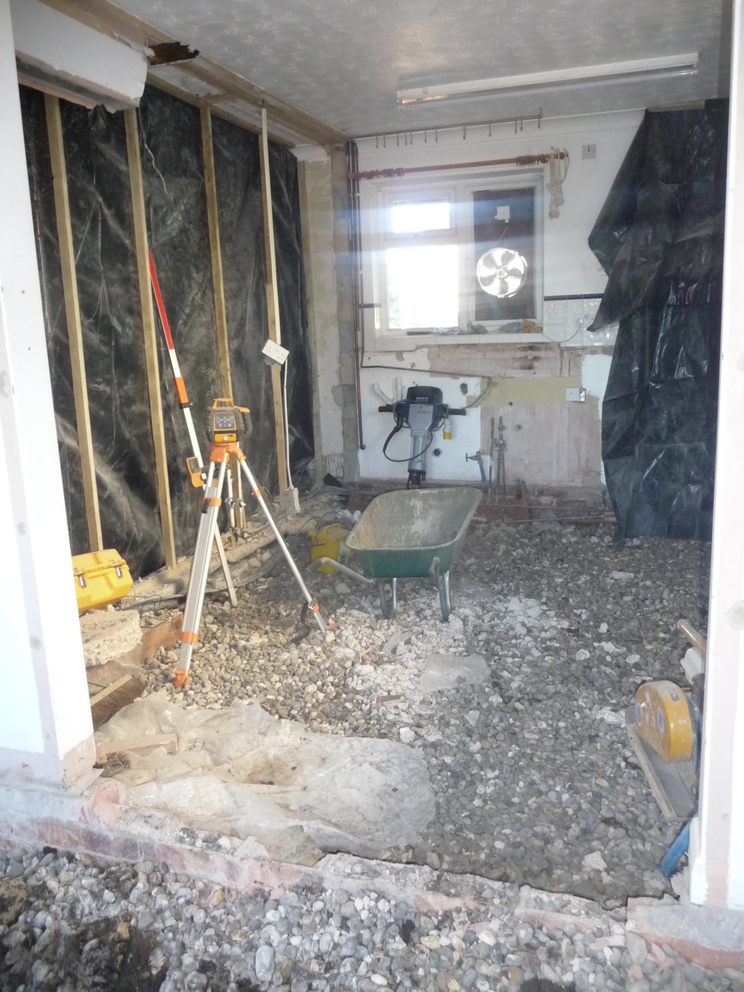

    Insulation is all about trapping air and preventing it moving around. If it moves around, it is transporting heat with it. Thin insulation can't trap much air, and squashed insulation with no space for air is even worse, it's just foil against foil with a bit of plastic in between. Foil is metal - A conductor.
    I had Wet UFH put in at my place. It involves digging up the concrete floor, digging down through the hardcore, relaying a harcore then concrete with enough space for celotex, ufh pipe and 50mm Screed. The deeper you dig, the thicker the insulation you can use.
    Was it worth it? Hell yes.
    Would I do the digging and floor laying myself? Hell no!
    Nozzle

  17. Nozzle
    Nozzle
    Joined:
    23 Dec 2012
    Messages:
    2,087
    Thanks Received:
    267
    Location:
    Suffolk
    Country:
    [​IMG]
    UFH Work
