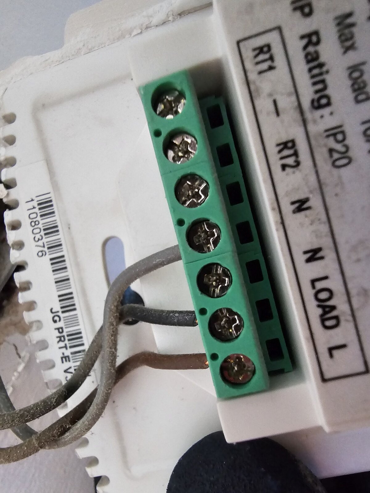

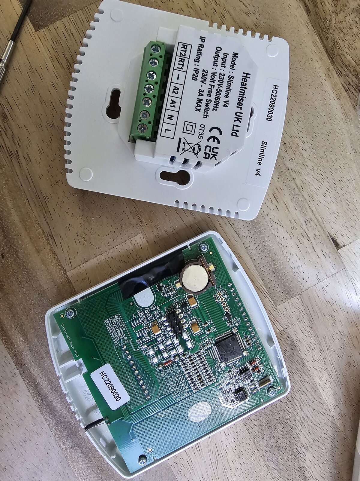

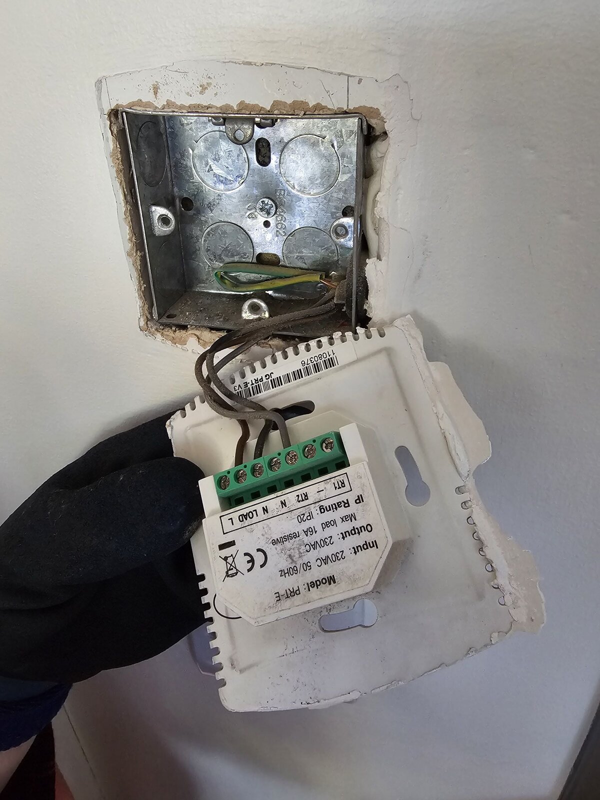

We have wet underfloor heating on the ground floor and one of the old underfloor heating thermostats (from about 2012) blanked out after a power cut. Basically, the screen never came back to life (it had blanked out previously when being programmed but then recovered). While looking for a replacement we were advised by Heatmiser that the direct replacement would be their Slimline V4 model (photo attached). Thinking it is a straight swap we opened the box and found out that we seem to have an electric underfloor heating thermostat - a PRT-E (photos attached).
Called Heatmiser back to ask what to do - they told us that they have no idea why an electric thermostat should have been installed on a wet underfloor system and that we should still use the Slimline V4 rather than the Slimline-E V3, their electric variant (in that case I have no idea where the black wire would go that is currently going into the Load terminal...).
Would anyone have an idea about why the installers might have used an electric thermostat on a wet underfloor system and what the issue would be with replacing it with the Slimline-E V3 version again? Taking into account that:

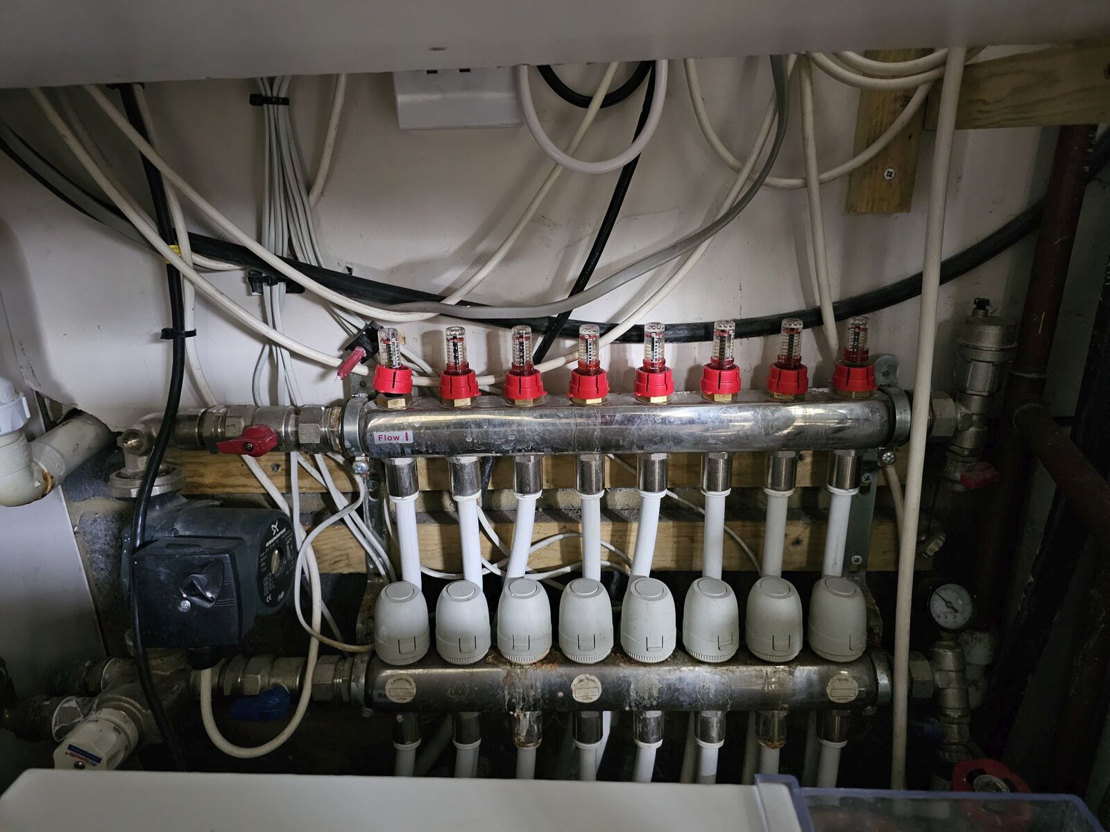

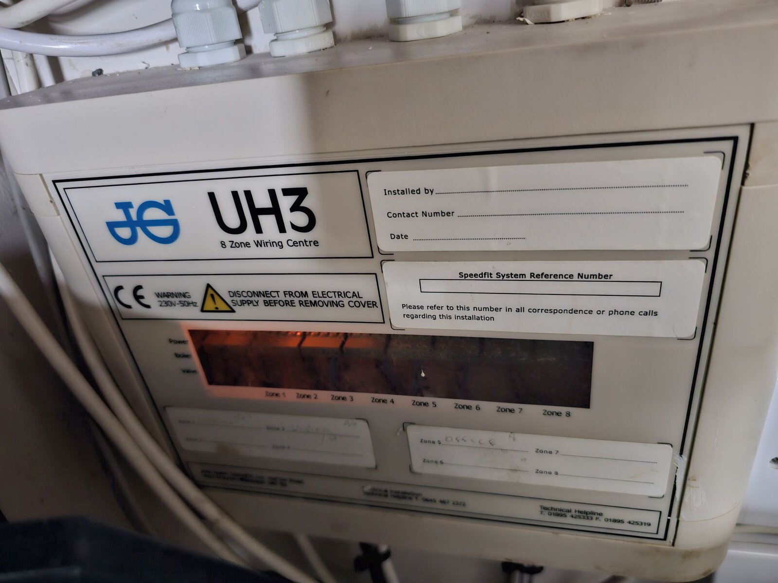

- We definitely have wet underfloor heating with a system boiler (hot water tank) - photos attached
- The house was built at the same time the thermostats were installed (2012) and although we've only been here for a couple of years, we haven't noticed any issues (the last check of the electrics was in 2022).

Thank you both. My main question is why there might be a UFH thermostat for electric floors installed at my house even though I have wet/water UFH heating. Heatmiser told me that wouldn't work but clearly it has worked for 12 years. I will need to replace the thermostat ASAP, so I'd like to understand whether there is any reason NOT to install a thermostat for electric floors again (which would be easier for me as an inexperienced DIYer).
The PRT-E was being used simply as a room (air) temperature thermostat. That was one of its functions. If the user had wanted they could use it with electric underfloor heating so that it could ensure that the floor itself didn't get too hot.
Feature 08 – Sensor Selection: On this thermostat, you can select which sensor
should be used. You can select between air temperature only, floor temperature,
or both.
It was perfectly OK not to have a floor sensor, and just use it as a room temperature controller.
So that is what the replacement thermostat should be set up to do.
The one you bought was really intended for electric UFH with a probe. The instructions seem to suggest, though, that you can use it as just an air temperature controller using the built-in sensor. See the settings instruction to achieve this.
