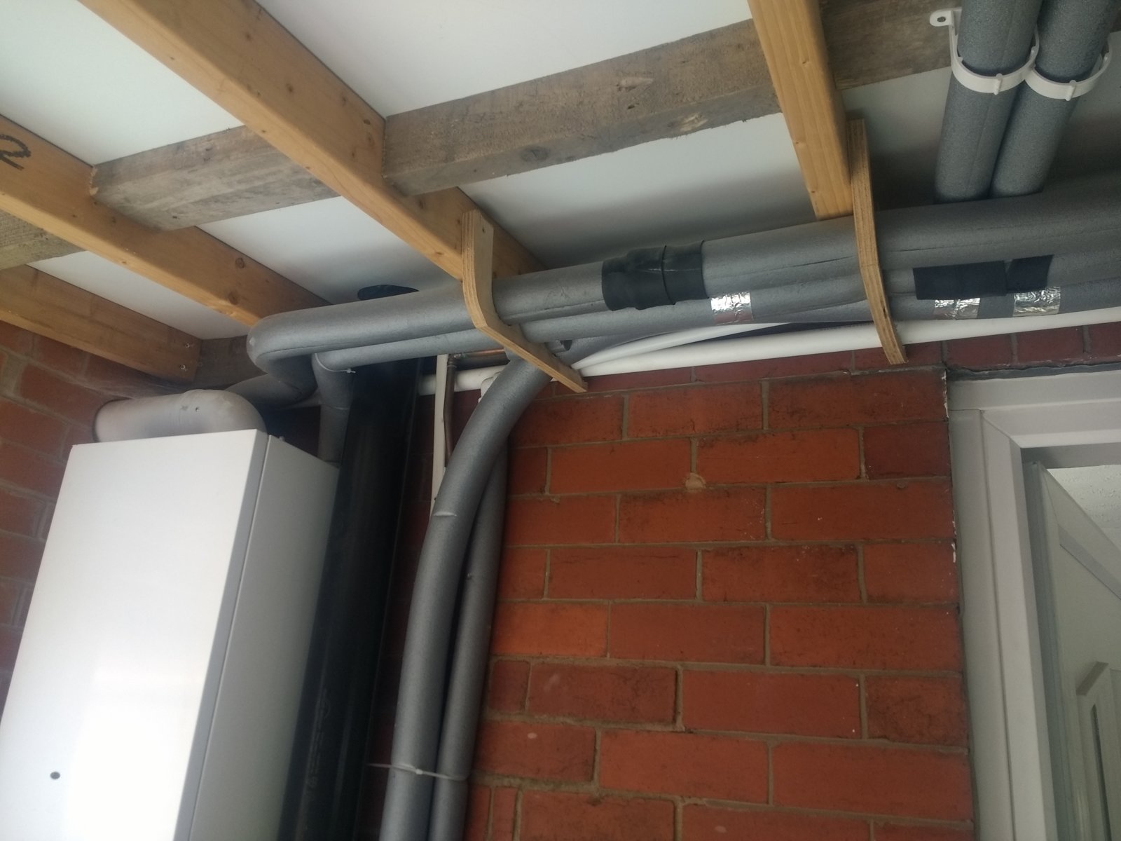

    I got the independent Vaillant approved installer to supply and fit it in the end. £1,640 all in. Was planned to be done over 6 weeks ago but I gave him the option to call it off and he did - in the heatwave we had, my loft was literally like a sauna. I couldn’t stay up there for 5 minutes without losing a pint of sweat - the temperature was 38°C so there was no way I could expect the bloke to work up there in that. We had a couple of holidays to go on so he said to call him when I was back and the temperature was a bit cooler. Two of them here this morning, took them about 3 hours in all. Made a nice tidy job of it - managed to use the existing flue hole, no scaffolding required and he was up his ladder for all of 15 minutes. Condensate pipe all inside the loft and entering the soil pipe in the soffit void so nothing actually outside the house. I can’t believe how quiet it is compared to the old one!

    About a foot. Feel free to kick a man when he's down and tell me what’s wrong here then. :unsure:

    Don't people lag pipes any more. Mine's in my garage with a fair run before entering the house but I feel a bit stupid now for doing it!

    They were lagged. I temporarily removed it as I thought it was preventing heat loss when the bypass was running.

    It's going to be a bu99er to get the condensate trap out of the bottom to clean it on a service, and I'd have lagged the condensate to prevent freezing. A Spirovent on the flow above the boiler would have been good too, to remove dissolved air and further reduce the risk of system corrosion
