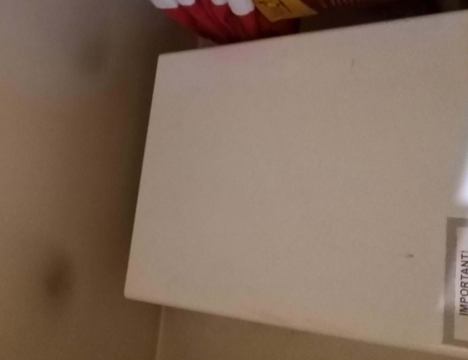

Hi all, I need some advice if you're able please. I've just had my boiler serviced...it's a Baxi boiler only. Not a combi. It's 15+ years old. The readings were sky high and after replacing gaskets to no effect I've been advised to replace it.
My gas man has quoted me £1400 for an 18Kw Baxi(not combi)(basically a straight swap) with flue, system chemically flushed, a magnetic filter added ,inhibitor added into rads and condensate will run to an outside drain.
I'm curious as to whether you believe this to be a fair price and also your opinion on if there's any merit in paying more to go for a combi boiler.
Any advice/opinion would be very much appreciated.

Not sure what he meant by the readings. Only that they were high and that he'd changed gaskets to no avail. There's black marks on the ceiling above the boiler that's caused by this he said.

Black marks could indicate a problem or they could simply be dust heat scorch marks ......fit a Co detectors and see if it goes off. Hard to comment without pics

@sircerebus666 @gasbanni All he said was that the readings were high and that the boiler was 'at risk'. I'm definitely going to get another opinion 'without giving the game away'. Good advice cheers. I'll get it serviced again by another engineer I've used in the past. It'll cost me £60 but potentially worth it. It's in my pantry with a closed door and a vent and I've ordered a CO detector for the meantime while I get it sorted. Thanks for the feedback as well. Really appreciate thanks. I'm trying to post an image but it's saying image is to large. As soon as I figure it out i'll throw one up. Thanks again.
I've managed to upload. Hope this is helpful cheers
