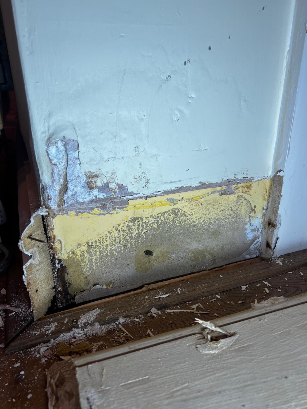

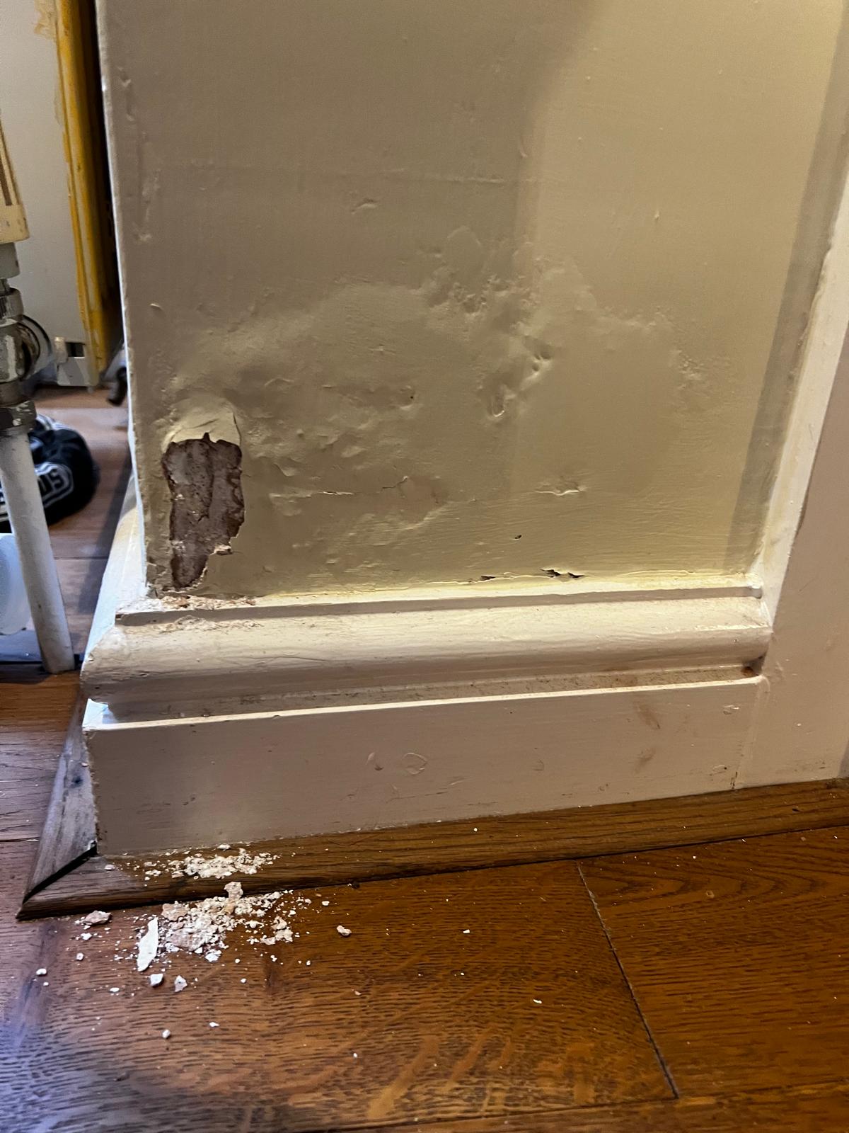

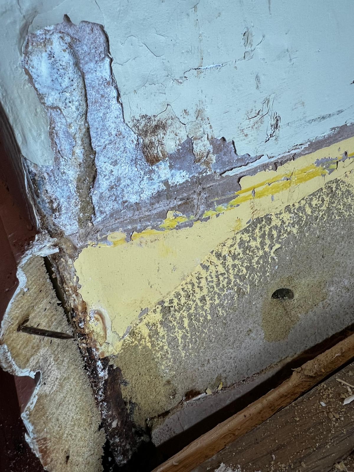

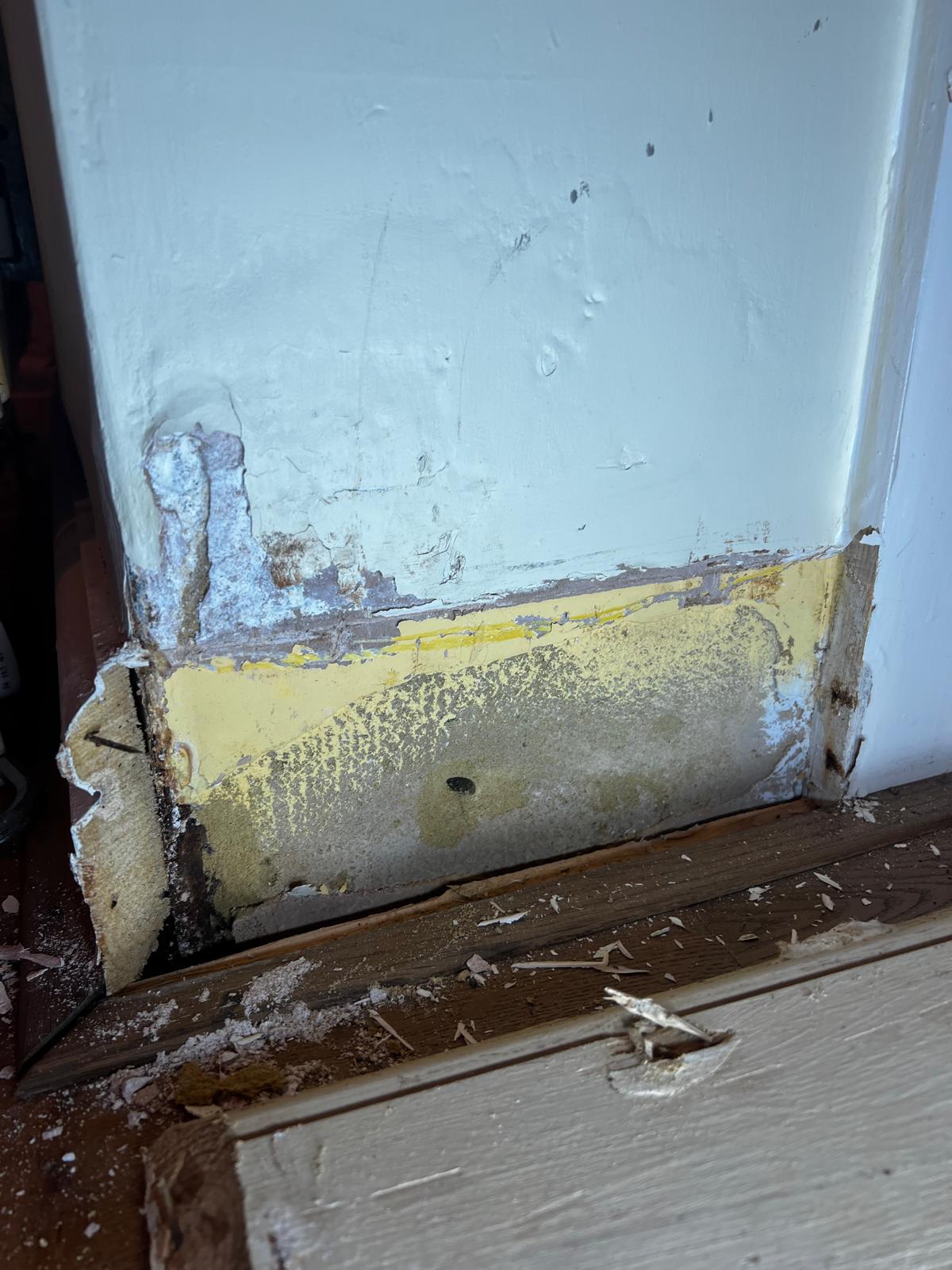

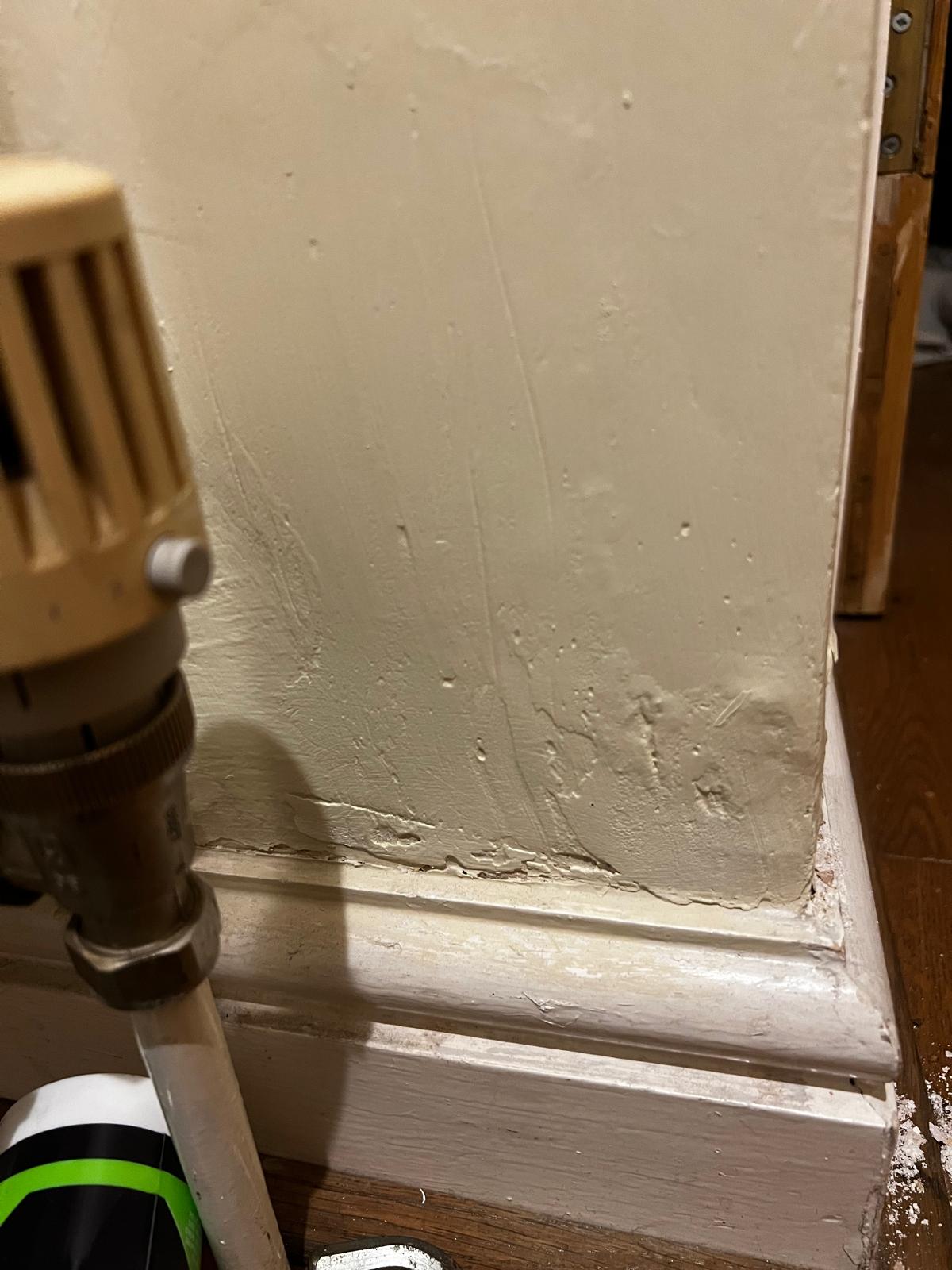

I'm going to decorate the hallway. The hallway was a bolt on to the main house. The main house is made from timber frame and lime render. The hallway is brick. The wall in the pictures is solid and about 1ft thick.
What am I looking at? rising damp? Dry rot?
What can i do to resolve it? dig it out and plaster?
What about refilling it? should i use lime plaster or can i use gypsum?

OP,
Before anything else, will you post a pic showing the wall surface the other side of the outside corner?
You have rising damp.
1. First you remove the skirting in pic 1 - Use a knife to cut the mitre & sealants. Examine the back of the skirting for rot.
2. Next remove all the plaster that we can see in pic1 - hack it back to bare brick.
3. Hacksaw cut the angle bead up to the same height - and replace it with a piece of plastic angle bead.
4. You may have to work on further damage around the corner after posting a pic?
5. Is the floor solid or suspended?
6. There are signs of previous work - a bit of skim over a damp area.

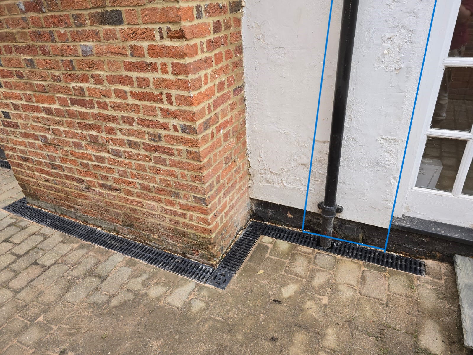

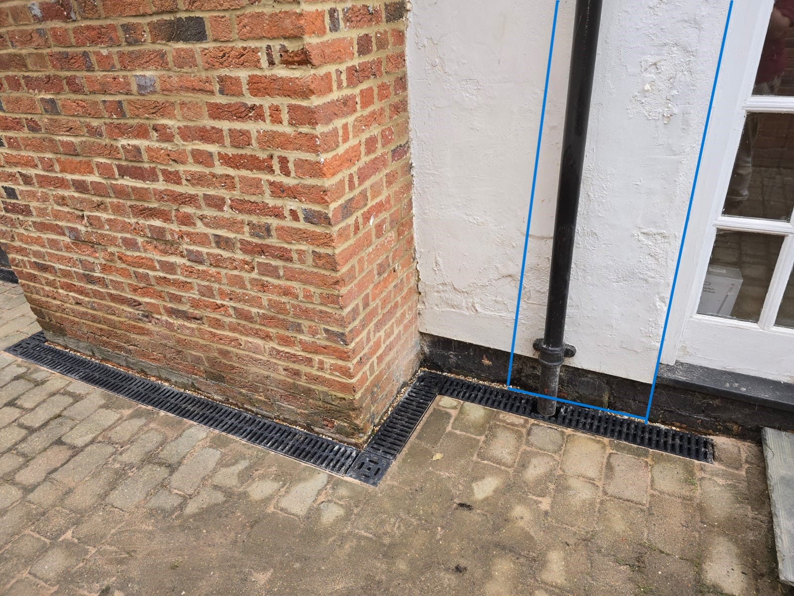

Could be rising damp from standing water externally. I moved in 3 months ago and along the outside wall to where this is, i've added a ditch outside, with ACO channelling to ensure there wont be any standing water along that face of the wall anymore. Attached is the ACO picture and blue line sort of denotes the internal wall.

Penetrating damp , maybe blocked gutters then running down outside of down pipe splashing wall , or damaged down pipe .Could also be penetration around door frame .
After fixing any problems it will take months before internal area is fit for redecoration.

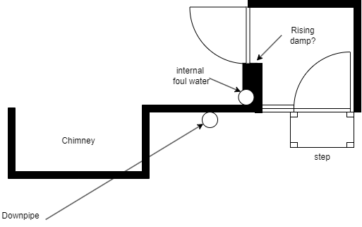

but if you look at my plan view diagram, the arrow pointing to "rising damp" is about 4ft from the outside wall. I think the wall is made up of aerated concrete blocks, which are quite moisture absorbent.
also i've added the ACO channel (see outside pics) along the wall so hopefully will stop any further damage

Yes rain can track across many metres as it falls via line of least resistants. Foul water pipe may also be a source of leak .
Your external pic shows damage all the way up the down pipe area .

yeah, someone has put gypsum plaster and/or plastic paint on the face of my timber framed house (c1725). This has caused moisture to be trapped.

The new pic defects need to be treated just like the original advice in Item#2.
You would be best removing the rad & skirting to do a proper job.
When you remove the short piece of skirting it will show if a membrane (a DPM) has been used under the concrete & if the membrane flops up the wall behind the skirting as it should?
On the outside its a case of all the render needs removing back to whatever the background is.
The Aco grids may need lifting for cleaning the Aco gutter - can you take pics showing how the downpipe discharges, & an Aco gutter section connection?
Does the ground slope towards your house?
A pic showing the chimney breast & fireplace might also possibly show something?
When interior plaster, & exterior render are removed then a DPC might be revealed
Firstly i think i need to qualify this and say i move into the property about 3 months ago. I added the Aco channel about a month ago as i was advised that there was damp inside the house around the fireplace area and walls (albeit you cant see it except for this post). The downpipe has been cut and drops into the pipe that discharges the rainwater from the channel.

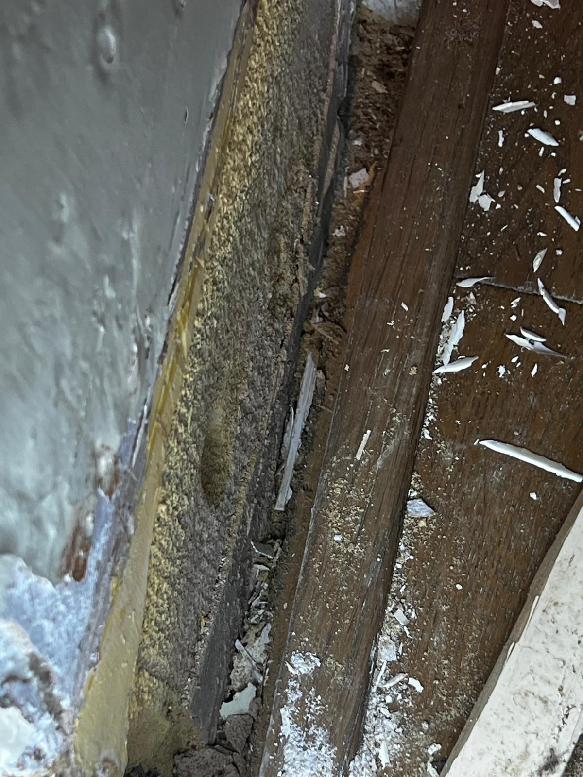

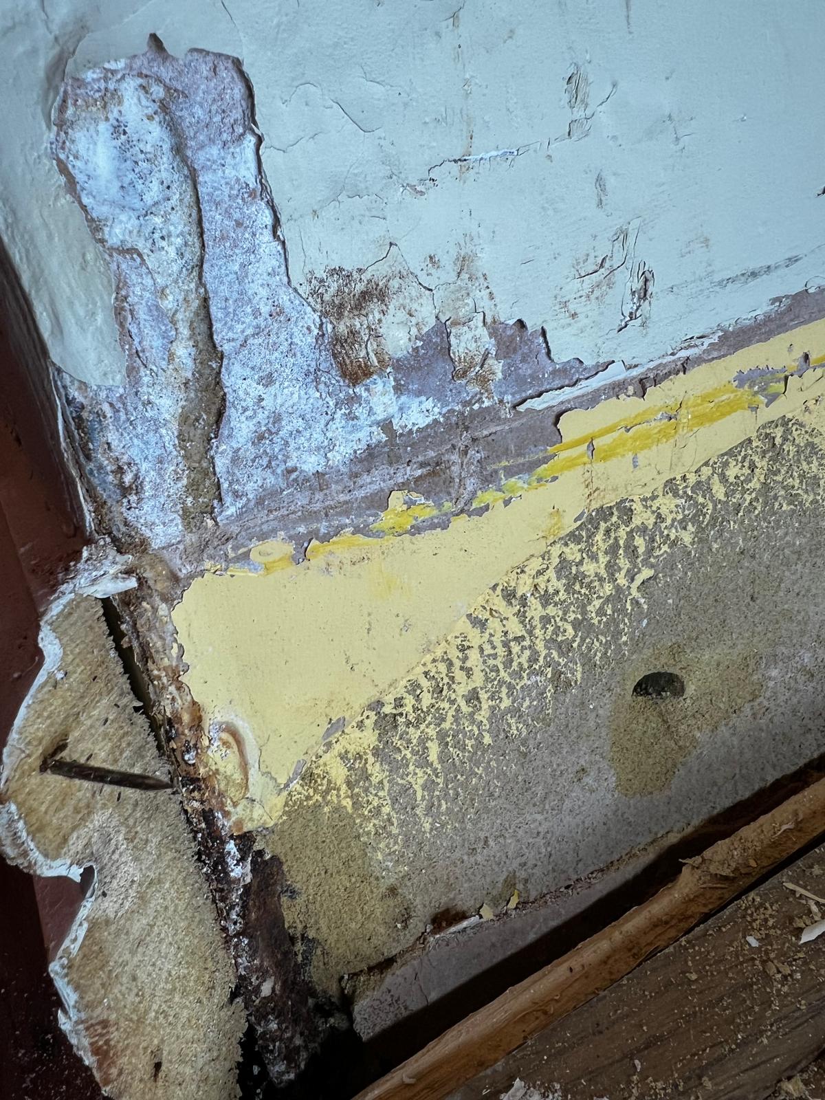

I will remove the skirting and remove all the plaster as per your advice. I'll check the situation. I assume the DPM will be made of some sort of plastic sheet? I'll take a picture and post regardless.
I'm going to remove the rad since i need to paint behind it. I'm considering replacing the rad with something newer anyway.

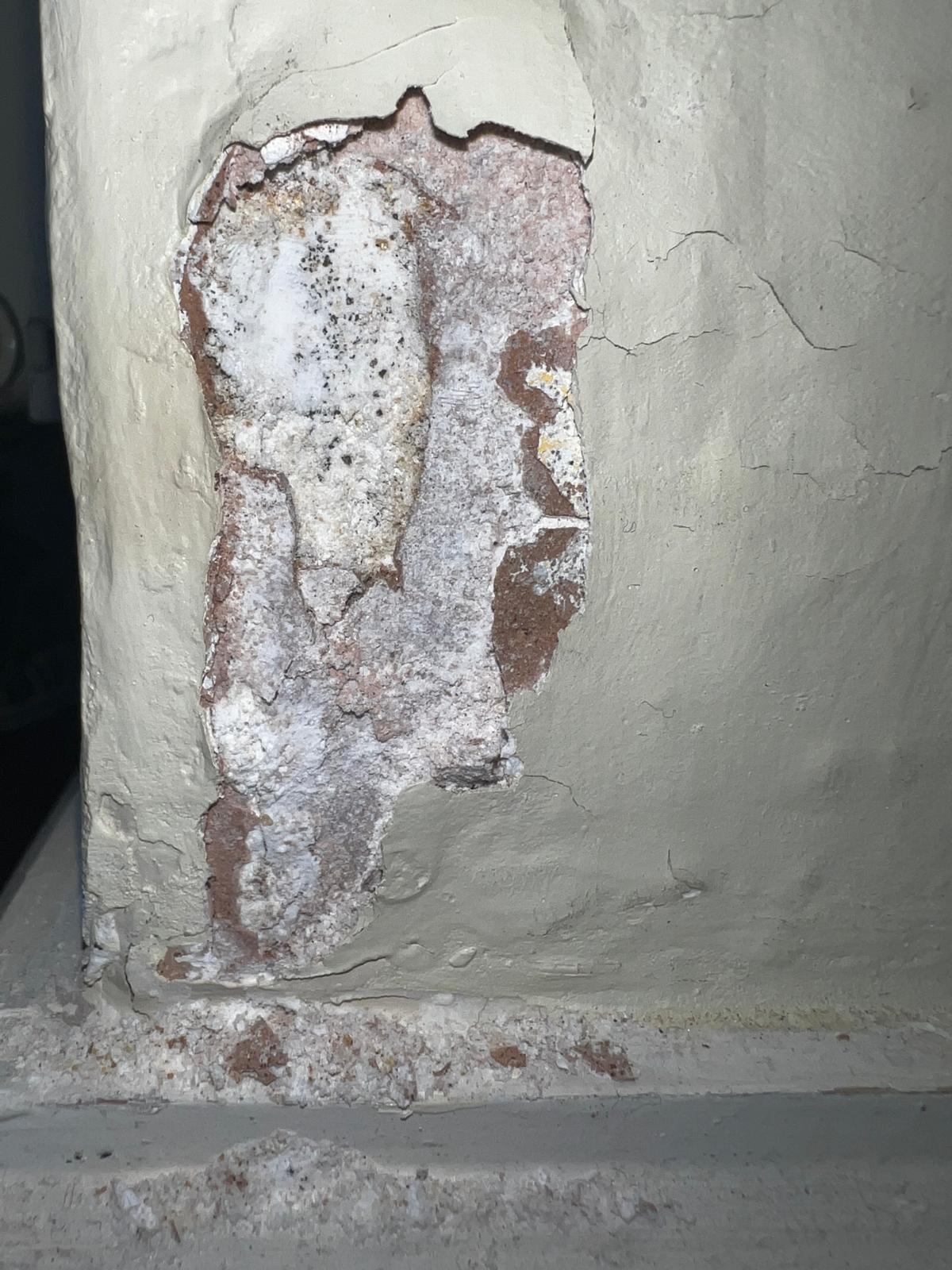

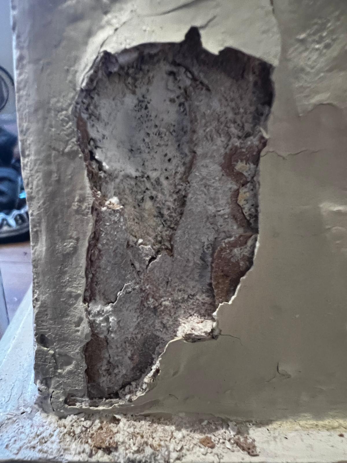

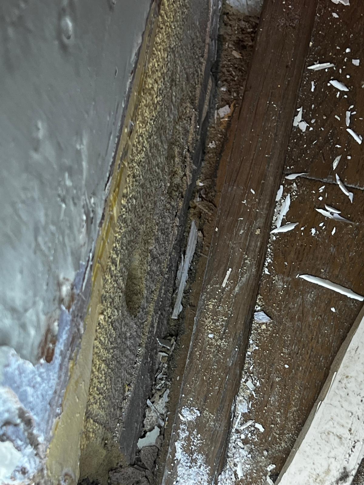

No rot behind skirt, that looks like gypsum plaster (it's pink), however that metal angle bead is rusted to hell. I think the bead has wicked moisture up and that's what has blown the plaster.
The material (where that hole is) is like sand-stone texture. is that aerated concrete blocks? I shone a light down the hole, it goes about an 20mm deep but still just same material so it's not render.
