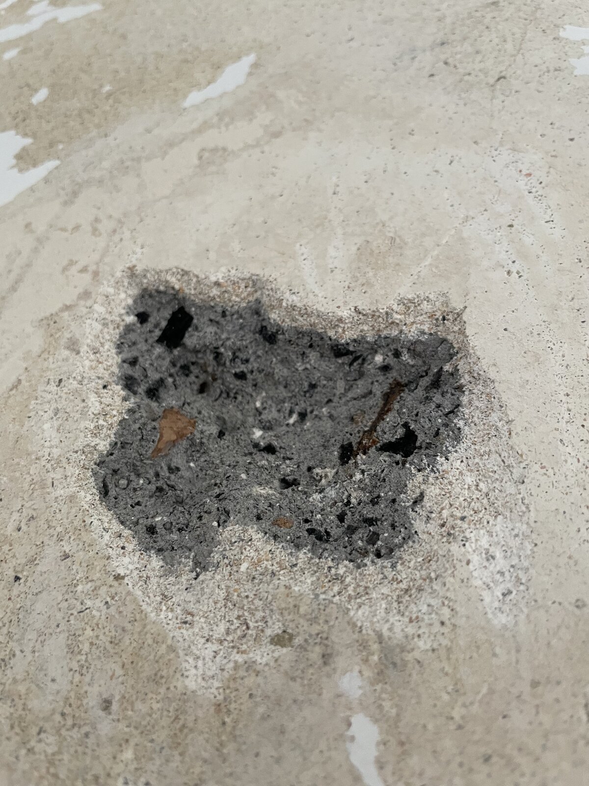

Been lurking here for a bit getting some great ideas about our damp chimney. So I’ve taken the plunge and started stripping it back - and I’ve fallen at the first hurdle :)
what am I looking at here?
Top layer is plaster, but what is the grey stuff with stones / pebbles? Some kind of lime based render?
For context, it’s a Victorian house - upper floor chimney breast.
Sorry for the newbie question! Thanks in advance :)
Looks like thermalite block.
Ahhh of course it does! The fireplace IS blocked up - but this patch is way up at the top (3m+ ceiling height) - I had expected to find the original brick chimney up there?

its not thermal block. that’s old mortar consisting of ash coal crushed stone and lime.
dont get it in your eye , it’s sharp and a nightmare to get out.
Oh interesting, that would make more sense given the location on the wall - so would that have been used as a render/plaster do you think?
