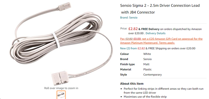

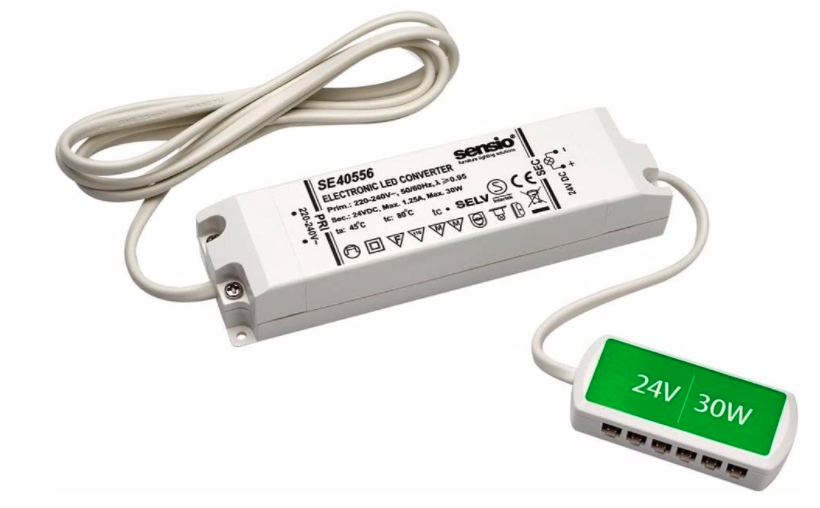

Indeed - here's one with 12 JB4 ports (6 on each side) ..
Like you, I have so far found no plugs, but there are a few leads around , such as ...
Kind Regards, John
Them drivers are proberly sold to be paired with the fittings they sell, theres many drivers with just basic terminals for you to wire in yourself.

If thats the case you can get the Toolstation sensio ones and cut the JB4 box off
