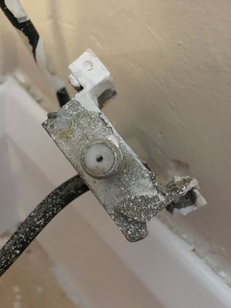

I had a quick look before I left this morning & there's a thick cable coming from the roof so I guess that would be the aerial. This goes in through the wall itself.
Then there's a thinner cable running in through the air brick which is in line with all that. I'd guess that was from the sky dish but I didn't have the time to start tracing cables as I was up a little late.
For Freeview you need WF100 cable run to where the aerial will be (ideally roof). For satellite you need twin WF100 or twin WF65 to where the dish will be (outside on a south east facing position).

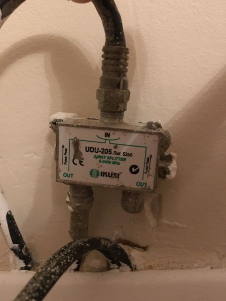

That rectangular thing looks like some sort of splitter to me. If I remember right when we bought the house the paperwork said their TV was with orange.

It is a splitter, it says so on it. I've not heard of TV with Orange in this country (in France, yes) but if so it would (probably) be streamed down a phone line. You need to trace the cable coming in to the top of the splitter.

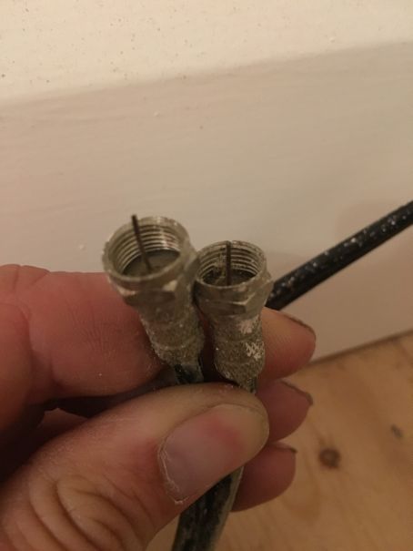

Is there anything that'll give you a better clue as to what that cable is?
Such as if I unscrew it & photo the end?

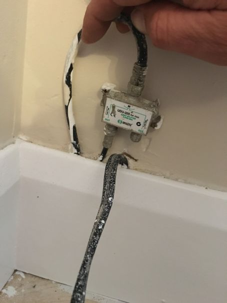

I'm just guessing here (as my lack of knowledge should be pretty evident by now) but is there a cable that could have 1 end that plugs in to that cable there (going in to top of splitter) with the other end being the aerial connection part that plugs in to the TV? A sort of extension cable if you will.
I know it'd be a bit slapdash but I don't really fancy ripping the skirting off. Would be helpful if I could get that end connected to a TV to see if it is the aerial cable.
We are all guessing. That cable going to the top of the splitter looks like a cable TV (Virgin) feed, but it could be a feed from an aerial. As I said you need to trace it.
Well hopefully you'll be wiser on the back of this because i think i've figured out at the very least what goes where & from where.

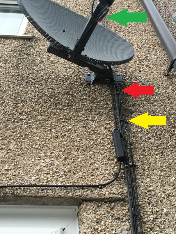

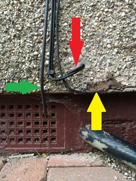

* There is a cable running from the roof all the way down the face of the house & in through an air brick. This is the thickest cable of the lot (not counting the double cable because that's cheating! It's the thickest single cable). I've marked this with a green arrow. The only thing up there on the roof is the TV aerial.
* There is a cable (thinner than the previous) which runs from the master bedroom to just at the side of the air brick at the bottom of the house which goes in through some brown silicone splodge (nice choice of colour!) at both sections. I've marked this with a yellow arrow.
* Then there's a double cable. Now if i remember right, Sky+ needs 2 cables for the recording feature. At least this is what i'm sure Sky told me about 5-6 years or so ago. Without getting a ladder to see precisely where it terminates, it stops at the Sky dish at any rate. Also enters the living room between the 2 other cables. I've marked this with a red arrow.

* The thick cable (from the roof) is the one i'm holding in that image which goes direct to the top of the splitter
* The thin cable runs in to the bottom of the splitter. Bear in mind the thin cable seems to run from bedroom to this splitter .... and we get TV signal perfectly fine in the bedroom. For now we only watch freeview but it works perfectly fine.
* The twin cable (from the Sky dish) does not connect to the splitter at all, but is the cable i showed you in the second image in this thread - the 2 ends.
Now casting my mind back (because this entire living room has been ripped apart, literally (new floor, new joists, new everything) the original telephone master socket was just above this on the windowledge. The previous owners also had the TV in the opposite corner .... which is where this cabling was trailed.
Now i can't remember if there's been an additional cable or connectors that i have maybe thrown out while all the work was going on. But anyway, that is what there is, that is where it is coming from & going to.
I hope that helps shine a light on the matter?
I have a feeling that the thin cable going in to the bottom of the splitter (whatever that cable is called?) I need another one of those coming out of the other side & running that in to the back of the TV?

EDIT: Sorry, the 2nd photo there looks like the green arrow is indicating a cable at the Sky dish. It's not. I was simply trying to show that the thick cable runs well up the wall towards the roof. Way beyond the Sky dish.
Twin cable goes from satellite dish to a Sky recorder box [as you say, two cables is the normal connection method for Sky's recording feature]
Thick single cable goes (most likely) from the roof-mounted aerial in to the two way splitter. The outputs from the splitter: one to the master bedroom in the room above [via the thin cable], and the other not connected. So long as the aerial is (a) working and (b) doesn't have a masthead amplifier which would require power, then then connecting a cable to the RHS socket and plugging the other end in to your TV's aerial input then that TV should then receive Freeview after the telly is properly tuned. Note: Do a 'First Time Install' which wipes the TV tuner memory and searches from fresh to find all the available channels.
If there's a TV in the master bedroom then connect the aerial lead coming in from outside and try the TV tuning. Given (a) and (b) both being okay then you should receive some Freeview channels. If not then here's the most likely causes and what to do to fix them...
(1) The TV coax plug at the bedroom TV has come loose and is shorting out the connection. Solution: remake the plug connection and make sure that none of the fine braided screen wire is touching the centre core connection.
(2) The aerial mast is fitted with a box that amplifies the signal. This needs a power supply to work. No power supply = no signal. The fact that your little two-way splitter also has DC Power Pass would suggest to me that it was installed with a masthead amp in mind. The power supply is a block something like this (image) with two signal connections. It lives near/behind the main lounge TV aerial point. It connects 'in-line' between the wall socket and the TV aerial input. It sends power up the aerial cable to make the amplifier work. These are often mistakenly thought of as boosters and so the previous owner takes it with them when they move. That's no big deal. Solution: Replacements are available over the counter at most aerial shops, online and even Screwfix* (link). The only additional items required are a couple of pieces of decent coax cable (WF100) with the appropriate end connections. These are: wall to power supply = F plug to F plug. Power supply to TV: F plug to TV coax plug. Good aerial shops and online suppliers sell these cables made up for you from WF100 and the appropriate plugs. Have a look at the Satcure page here for the options.
Important tech info to stop you buying a lemon and to prevent interference issues in the future: Those pre-made coax leads with the moulded plugs, the ones you might pick up from the supermarket or DIY shed... they're garbage. They cause more issues with poor signal and interference than almost any other single item in an aerial system. The cable is thin and poorly shielded so it is prone to loss and much higher levels of interference than decent TV coax cable. Buy properly shielded coax cable (WF100) and save yourself a tonne of hassle.
Once you have installed the power supply and connected it correctly then there should be an aerial signal at the TV. Do a 'First time install' to wipe the tuner memory.
(3) The aerial is goosed. Solution: Get an aerial guy in to replace the aerial and check out the quality of the cable downlead too. If he tries to sell you RG6 aerial coax then find another installer. All-copper WF100 coax is relatively inexpensive; it will give better signal (less loss and much better noise rejection) plus last far longer long than cheaper but far inferior RG6 cable.

Lucid has said it all, but I'm puzzled as to why he thinks there is a masthead amplifier that needs powering as you said the bedroom TV works fine. If there was a masthead amplifier with no power you would get nothing.
So all you should need is an F to Belling Lee lead from the 2nd splitter outlet to the TV.
