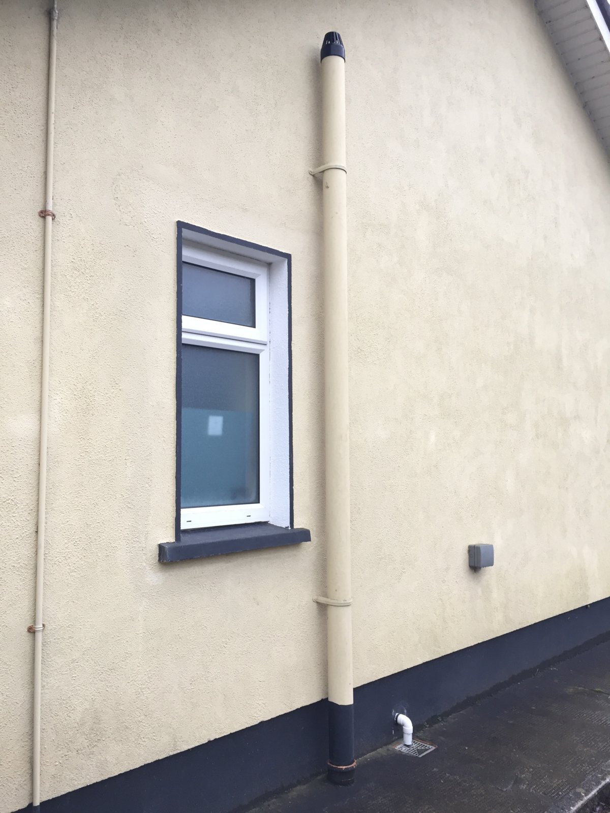

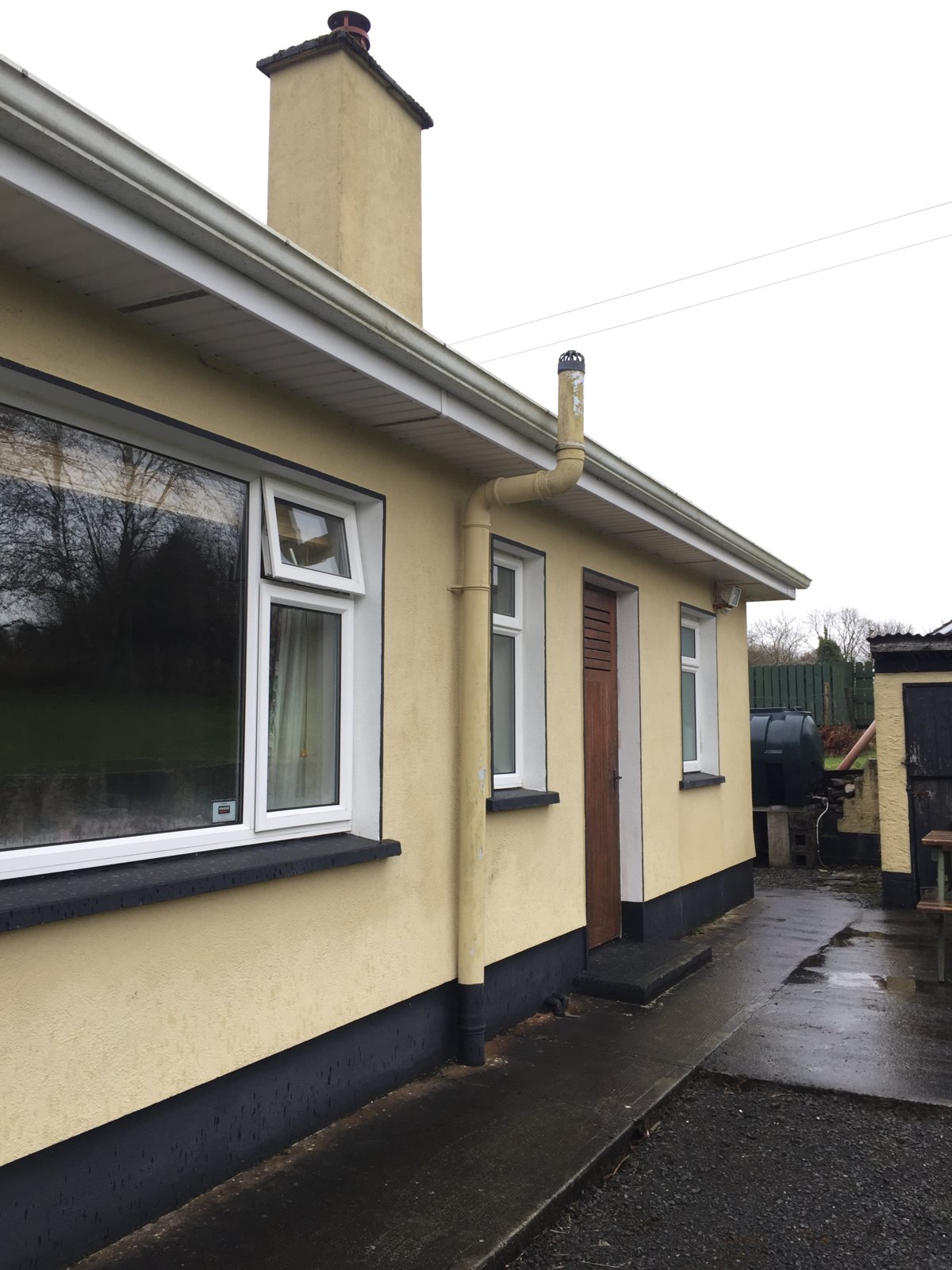

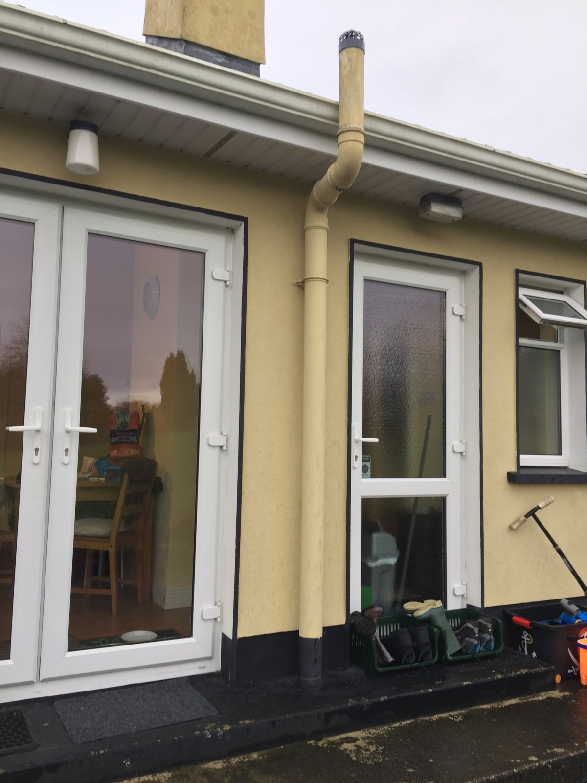

I’m wondering what these pipes are? We moved into a bungalow and there are two pipes that go from the ground outside to just above the roof, there’s one out the back and one round the side of the house. I’m wondering what they are? And could they be making a strange noise? I’ve heard a weird hum since we moved in! Thanks
Drain vent pipes - maybe the wind blowing across the top could make a noise. Could be wind round that chimney cowl too;)

I'd rule out the soil vent pipes by temporarily covering them just in case wind is causing them to resonate...google Helmholz resonator
Might be a stupid question but how would I cover up the vents? Any advice?
