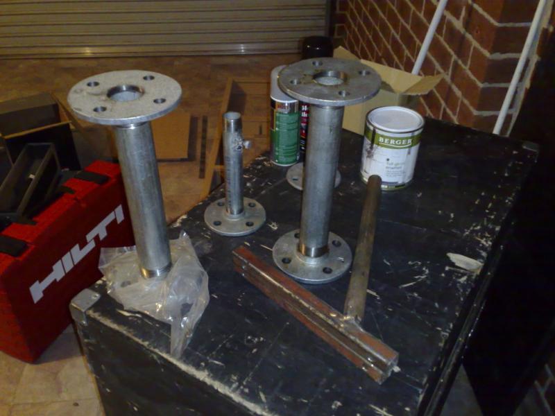

and where would I get them from?
I have searched online and the local DIY stores but I haven't been able to find out what these pipes and circular bracket ends are called (the two standing upright closest to the camera), or what type of seller I could buy them from?
I'm after a couple just like them pretty desperately. Could someone please put me out of my mild misery! :LOL:

they do look like plumbing to me, but i would say they have been custom made, it looks like a flange a pipe and a flange. or if you look at it from the other end, a flange a pipe and another flange.
what were they being used for?
if you want to make a slightly smaller one use 20mm conduit and a dome at each end

I was thinking they are probably a custom job. They were made for the purpose of attaching mid-sized speakers to a DJ desk.
They have to be very strong to withstand the weight and the vibrations of the speakers.

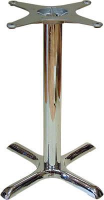

Hi, not a bad idea although I think I may struggle to find legs that are the right size. The speakers seat is only 25cm across and I think the diameter of those table leg tops will be quit a lot more. I'll have a look around tho!

eye - they're screwed flanges, available in galvanised (as per your pic) or black. Outside dia of flanges 3.75" up to 19.25", nominal bore size 1/2" up to monster 12" - and all sizes in between. Designed for heavy end plumbing and steam work. Use thick-walled steel tube (threaded ends to match & galvanised/black) and if appropriate malleable iron pipe fittings to knock-up frameworks. Bends - you'll have to buy or hire a hydraulic bender. We get our stuff from ParkerSteel and ParkerTools in Canterbury.
Find a decent plumber's merchant with a comprehensive range of stock locally, no chance in the sheds or a High Street plum merchant.
eye - Hitachimad's Key Clamps is a good way to go 'cos you don't have to thread. You still have the problem of standard tube lenghts, over 6m. So, see if the 'heavy' plumber's merchant will supply (cut) you shorter lengths as some do. Key Clamps obviously rely on the allen screw to hold the tube in position, but because of this this tackle can look a bit 'bulky' as opposed to the plain stuff.

Symptoms, that info is extremely helpful. I think Hitachimad's suggestion ticks all the boxes. Worst case scenario, I'll have to cut the pipe myself, but the local plumbers merchant is not far from my house so I reckon I can walk a lengthy of pipe home.

Its only bog standard steel tube, depending on what size fittings you choose scaffold pipe will do the job.
So will the table, I hope you have taken this into account. If you can lift the table by yourself then it's probably not up to the job. (I'm talking about vibes and sound, not the load bearing strength of the table)
Ideally speakers should not sway on their mounting. Bolting into a concrete slab is the ideal mounting for loudspeakers. If you can get like whats in the pic, but full length down to the floor, and with a heavy or bolt down base, then that would be spot on.
