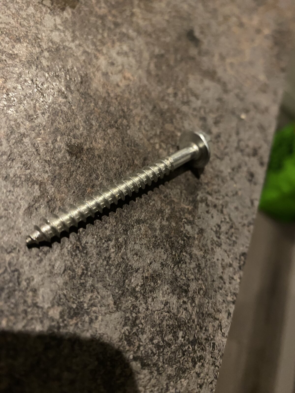

Hi, what are these screws called?
I am installing a very heavy column radiator using core fix plugs. The screws that come with the core fix don’t have flat heads, which I need to act as a washer effectively.
Does anyone know where I can find the screws below… 3mmx100mm or 3mm x 90mm ideally
Cheers
Are these what you're screwing into dotdab plasterboard as per your other thread ? Surely t f not !
I'd agree with this comment. The threads are not coarse enough for plasterboard and tbh, I wouldn't trust anything hanging off of plasterboard anyway. Anything heavy, kitchen cabinets etc and these rads that you suggest, I would drill through the board and direct-fix into the substrate behind, personally.
I have, he's got a dot and dab on masonry and he's made a hash of the holes, he just needs to fill the hole and carry on with the corefix.
