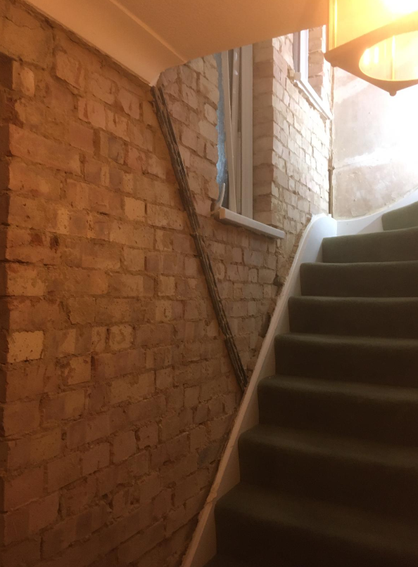

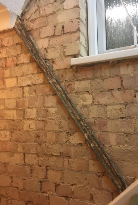

I have stripped the plaster off a 1930's London house and found these, my guess is old electrical cables. Please can someone confirm? I want to rip them out really I am guessing it would be safe to do so?

Metal conduit for electric cables.
In the old days they used to do things properly.
Could any of them be gas pipes?

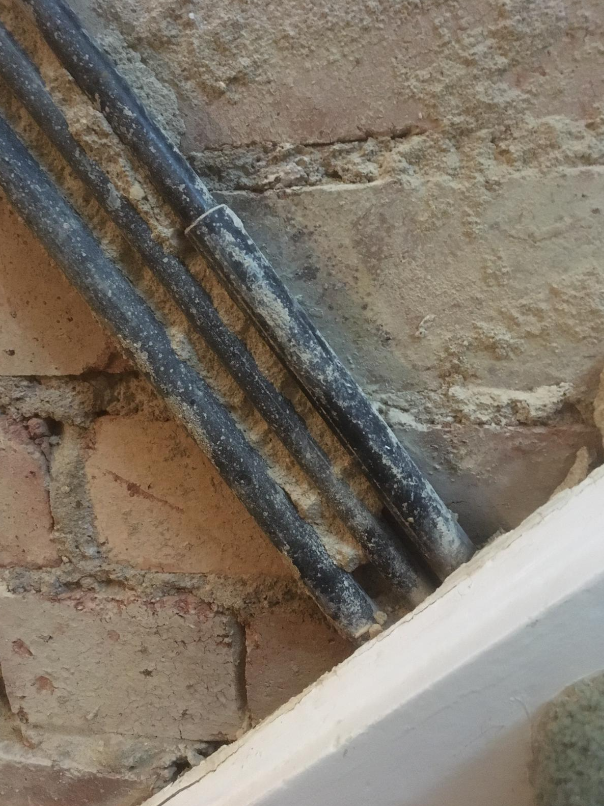

They appear to go from under the stairs, where the gas meter and electric meters were often located, upto the first floor, under floor. Unusual to run three, parallel gas pipes, but you just never know. They look like black painted conduit, which was common for electrics, back in the day, before twin and earth.
Could be two of one and one of another. Would they run three electricity supplies upstairs in the old days? May have been for gas wall lamps.

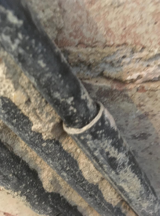

One is 20mm, the other two are 12mm and one has a join, it is just slipped in. They are behind the plaster to not that easy to follow. I cannot see any sign of them in the understairs cupboard or in the bedroom above.

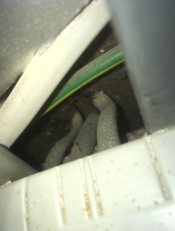

No in fact I can just see them behind the board, looks like they are still live! Maybe they pulled new cable through when they rewired in the (my guess) 1970's.
Not 3 supplies, 3 (or more) circuits. Could be one conduit for the sockets, one for downstairs lights, one for upstairs lights.
Our house is like that, particularly from the CU up to under the first floor, where one carries on to the socket above (one end of the upstairs RFC), and one carries on (I think) up to the attic for the upstairs lights). One thing I'm not too happy with is the lack of anything on the ends of the tubes - just the sheath direct on the cut edges.
