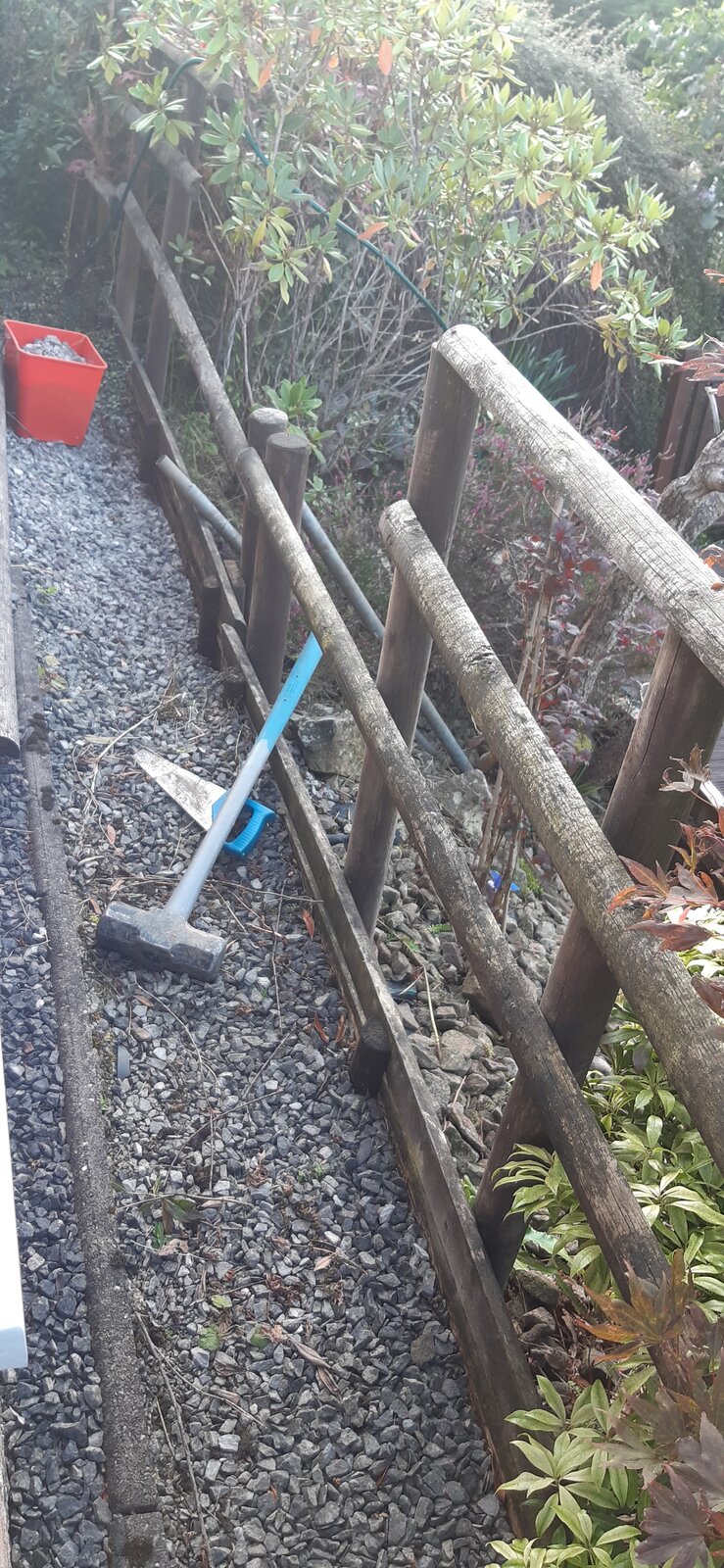

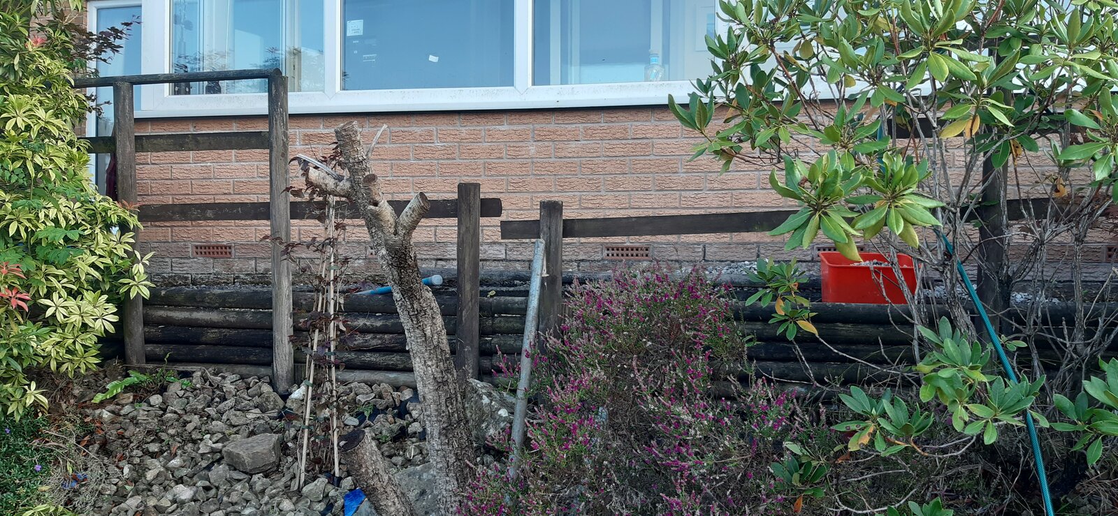

I have a small walkway on the edge of my steep garden which is stake posts and handrails, with soil and chippings in a kind of trough.
I have to replace them from time to time and I have also treated them regularly.
I also don't really like the look of them but don't want to spend a fortune.
Any suggestions as to what I can replace them with please?
I wondered about adding some sand and cement to stabilise the trough part so that the stakes wouldn't bear all the load?

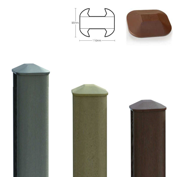

Composite posts are available, but they start to get pricey...
Shouldn't be too hard to work out, how many times you'd need to replace the timber post before a composite one would pay for itself.
