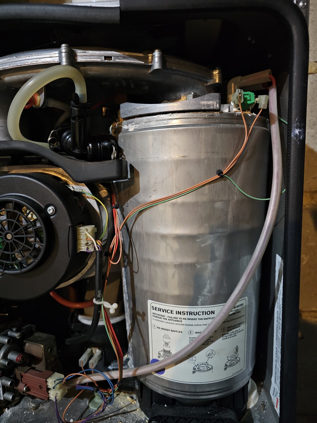

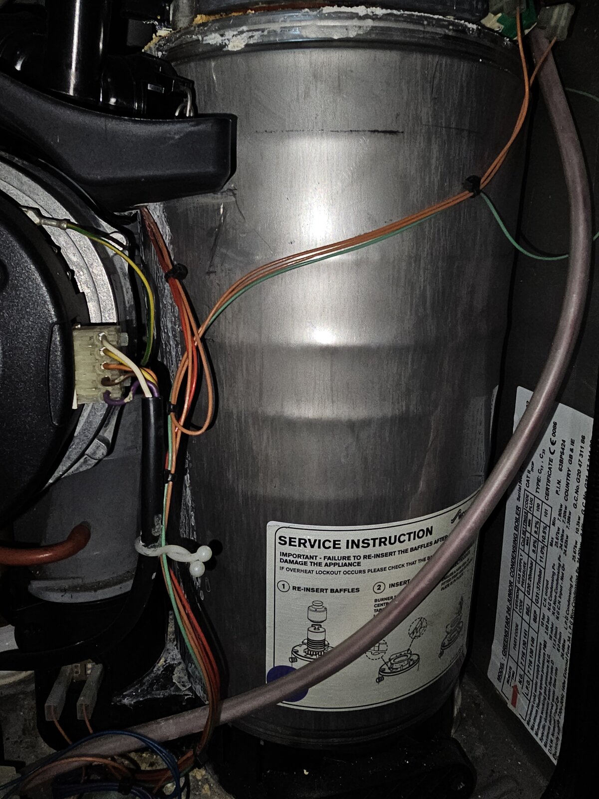

What do you think? New boiler required?

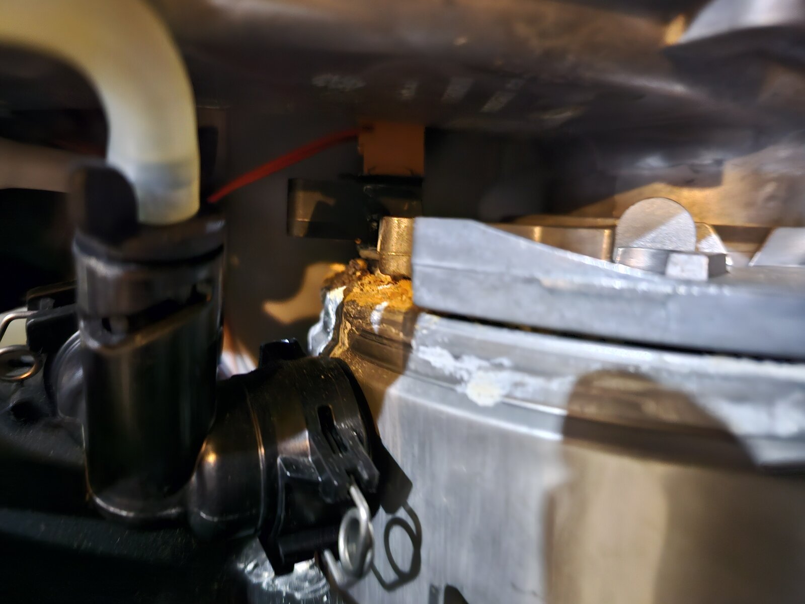

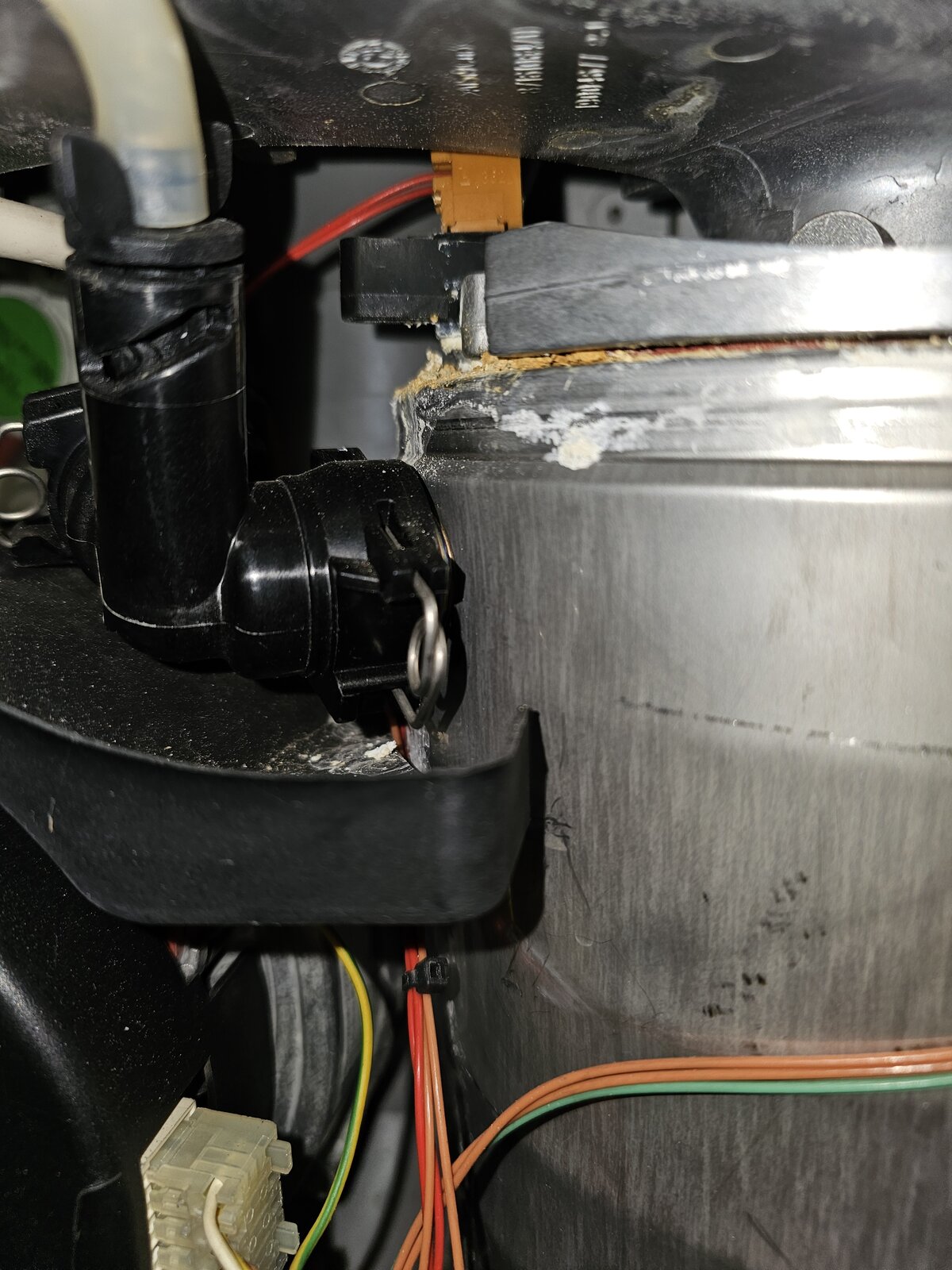

We recently got our Worcester Greenstar boiler, which was working fine, looked at as it was time for it to be serviced as it hadn't been looked at for several years. The boiler chap after taking off the cover took one look at the main heat exchanger and said it's gone and it wasn't worth replacing, at least he wouldn't do it and said we would need a new boiler. His justification was the boiler is old and said it would cost £1000 (£600 for the primary heat exchanger and £400 for the work) and because of it's age (18 years old) other bits may begin to fail and at the end of the day we'd be better off getting a new boiler which would give us a 10 year warranty. This was fair enough and I can see where he was coming from. He said he wouldn't issue a gas safety certificate based on what he could see. I've attached some photos and am wondering what other people think. We're hoping to sell next year hence why now an outlay of over £3000 is not something we were expecting.
My partner thinks we should go down the route of a new boiler as she feels it would add to the house's saleability and reassure buyers. I'm not so sure.

The HE is ribbed, many I see are the same

One of the worst I've seen there, if it's not already leaking (and it looks like it has been) then it will be soon. If you replace it with something cheap but decent like a Vokera Vibe Max with a 7 year warranty you should get change from £2k

There is no such thing as a reconditioned primary heat exchanger for this model....the o ring (the seal that has leaked on yours) is not accessible.
Any 2nd hand/reconditioned part could fail in exactly the same way within a short time. Furthermore you can't recondition aluminium alloy that has corroded away after years of use.
Most "reconditioned" boiler parts are nothing of the sort...just cleaned up parts ready for mugs to buy.

That model has been around since 2005 with very little design changes over the years...it's up to you but if the lower end is ok then I'd get it fixed for the likely price of £400 to £500.

The ribbing is caused by the aluminum spiral formed on the outside of the casting expanding to the point that it stretches the stainless steel jacket.
It's not that unusual but suggests the boiler is running a little too hot...plenty of boilers have it with little issue.
However, overheating will no doubt reduce the life of the seals which are the weak point on these.
My own heat exchanger suffered the same fate after 2 years....it only runs at a max of 70 degrees and feeds an unvented cylinder (1 hour max usage per day). Just another modern boiler design flaw.
