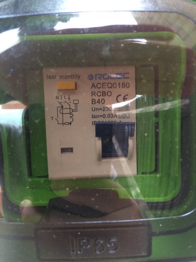

Hows this?
The other quotes that were offered were for different units, some were rent only, some had conditions that meant you had to pay for servicing or other issues which discounted them. As for cost they ranged £150 - £700. The two I chose were because the units supplied were rated the best.

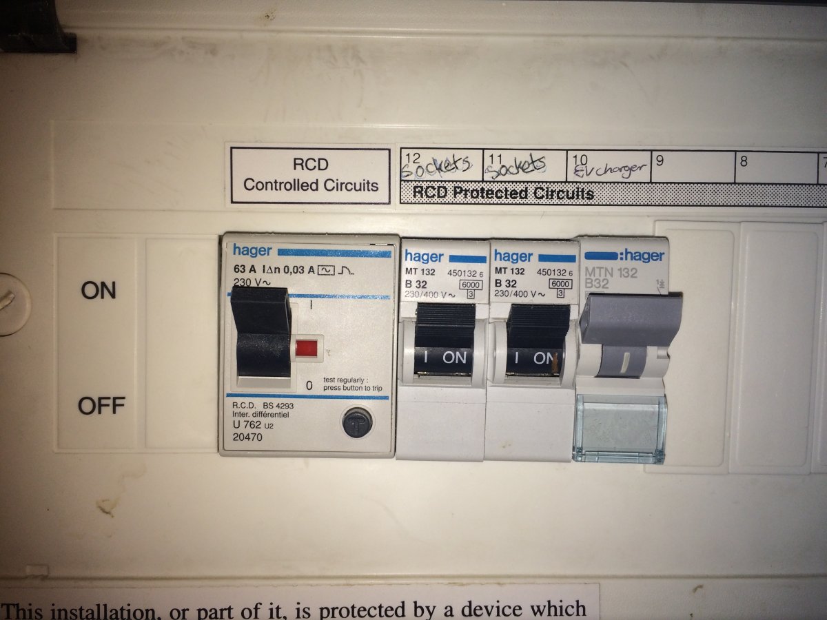

EV charging circuits should have a Type A RCD, which detects DC. Yours is Type AC, which does not.
If there is a Type A RCD incorporated in or adjacent to the charging unit, then this is what they probably meant by compounded RCD's.
Namely that there is a possibility the non Type A RCD could trip instead of the Type A one, thus omitting the DC detection ability.

Is there another RCD in the circuit?
Either way (EV charging circuit installed using Type AC RCD or EV charging circuit installed using Type AC RCD and Type A RCD downstream) it is not installed in accordance with the regs.

Not really. It does not comply with regs as there are two RCD's in the circuit and the board's RCD trips may trip in preference to the EV unit's RCD. If this happens, that RCD does not have the capability to detect pulsating DC currents.
Assuming, of course, the EV charger's RCD IS Type A....

That is a Type A 40A DP RCBO.
So as well as having two ELCB's in circuit, you have a 40A RCBO fed from a 32A MCB.
Be interesting to see the test sheets to see how he managed to test both devices.
If the AC RCD had tripped, the circuit is already disconnected and there would be no current of any kind for the type A to detect.

The RCD in the EV charger in the photograph is type A.
Thought that has just occurred me is that even if you have a type A local to the charger and that will be covering the charger, you could have an issue with the type AC device which is covering the supply to the charger and other circuits... If the charger is pulling current with a distorted waveform and this has the ability to 'lock' an AC RCD by saturating the core (this effect was used in a particular made of loop tester). Then it would be possible if the charger was in use and this locking of the RCD was occurring, for the RCD at the origin to fail to trip on a fault occurring elsewhere in the installation.
