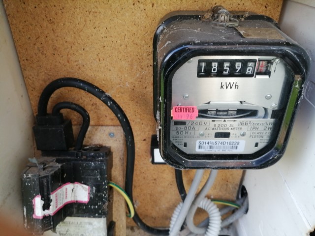

It answers several points and raises a few more. For example the size of the main fuse and tails. Mine in unmarked. Could be 60a, could be 100a, I don't know. It was fitted in 1996, that's all I know.
The tails measure 12mm across. Hopefully that's enough to identify the size.

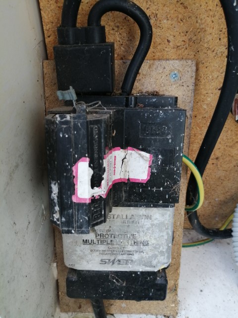

OK, let me clear that one up. It's something that has been mentioned many times on this forum. The printed plate on the side of the cutout fuse carrier ( as opposed to the additional label stuck on the front in the video) does not indicate the rating of the fuse fitted, only the maximum rating for the fuseholder.
In the absence of any additional information (such as the stuck on label) the only way to know for certain what rating of fuse is fitted is to remove it and have a look - not something the homeowner should be doing! A site visit by the electrician prior to quoting is the correct way for the electrician to obtain all the info needed to produce an accurate quote. It's part of the cost of doing business.
(Yes, I know that an electrician should not be opening the cutout, but as we all know.........)
If the electrician is not willing to do that, the customer will have to get the DNO out to confirm the fuse rating - in fact the best bet would probably be to get them out to confirm/uprate the fuse regardless, as they won't know what is fitted without opening the cutout themselves.
Right you are then - I (we) now know what the glaring error on the video was. Not exactly heinous but does explain why I couldn't find the value on the side of the fuse housing.
I may well ring South Western Power in the week and ask then if they'll send someone to check.
But before I do that I would ask if it's thought that to do so is putting my head in the lion's mouth and risking a Spanish Inquisition. Are they likely to come equipped with a lorry load of testing apparatus and strict instructions to nit pick the installation and discover that this or that needs updating in order to comply with the latest ruling?

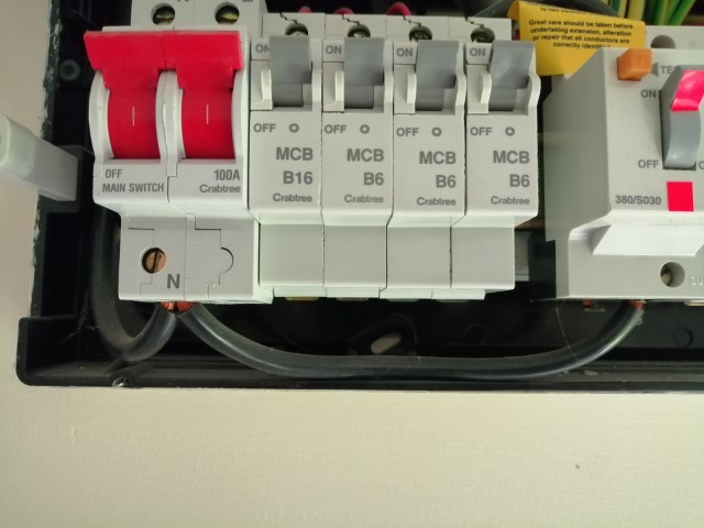

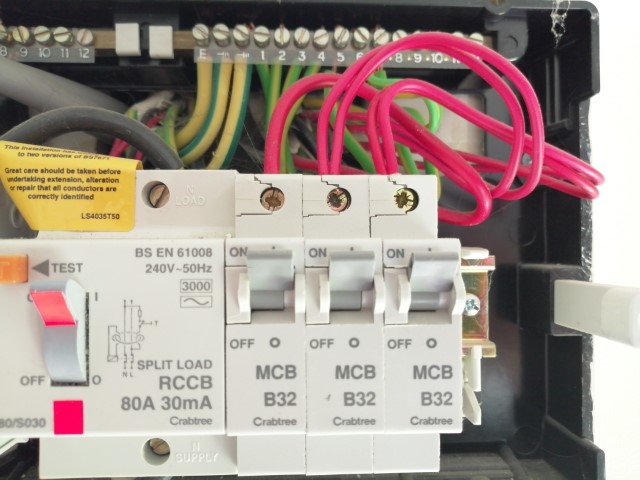

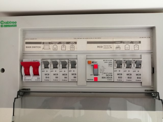

1. Post a pic of your consumer unit, so we can give you grief before an electrician does. :LOL: Southern west won’t give you any grief though. Only an electrican. I guess it will be that some circuits are not rcd protected and the case is plastic, will be typical concerns. The bonding cables to mains pipes many need to be thicker these days?

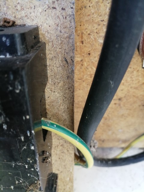

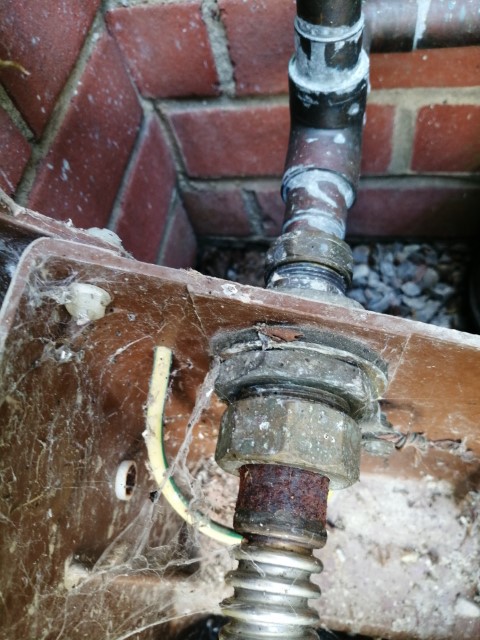

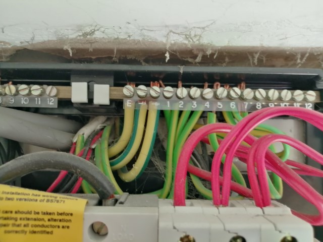

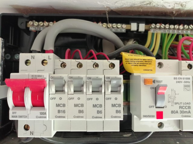

IMG_20210822_130107 (Small).jpg IMG_20210822_130126 (Small).jpg IMG_20210822_130438 (Small).jpg IMG_20210822_130448 (Small).jpg IMG_20210822_130459 (Small).jpg IMG_20210822_130539 (Small).jpg IMG_20210822_125926 (Small).jpg IMG_20210821_113405 (Small) (1).jpg IMG_20210821_113343 (Small) (1).jpg IMG_20210822_130539 (Small).jpg
Very grateful for the two previous replies which are great.
And, yes, the CU is plastic. Fitted in 1996.
Theoretically possible to add a non-RCD circuit to that, which could be used for an EV point provided the circuit was done in armoured cable throughout and the EV point contained all of the required protection devices.
