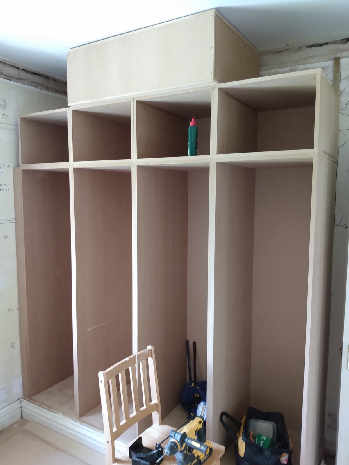

Hi all
Mid-way through floor-to-ceiling walk in wardrobe build (two rows of stacked units, built on a ladder frame, and battened to the walls).
Wondering what to have at the top of the wardrobe, bearing in mind I'll eventually be attaching LED coving to the front (so I can have integrated wrap-around coving across the whole room).
Currently (as you can see) I was thinking of a few sturdy boxes running along the top, attached to both the units below, the back wall, and perhaps the ceiling, creating a sturdy front panel I can attach the coving onto.
Is this over-engineered, and is there a better solution, perhaps?
Thanks in advance

Does it need to be boxed in like that at the unfinished part? You could build a door/doors at the front, hinged from the top, "seal" the back and sides with scribing pieces where they meet the wall, giving you storage for larger items.

It does, because I need the space to install the coving. The coving is 10cm in height, and needs about a 14cm gap from ceiling to project the light.
Additional storage as you described was one option, but I like the idea of wraparound coving lighting
Have the doors below the coving etc. you dont need them to be full size - your wasting a lot of space there.
One day you will regret that, probably when trying to find a hole for the Xmas decs.
Design/appearance over function on this one!
The panel could be bottom hinged - dropping down complete with coving - but if you're content to lose the space, a simple board and batten should secure the coving.
