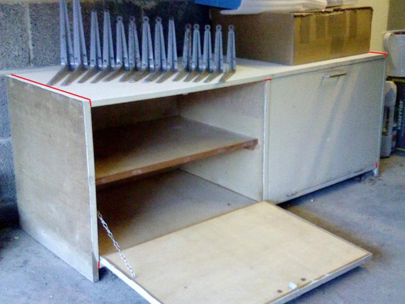

I hope you can see the pictures.

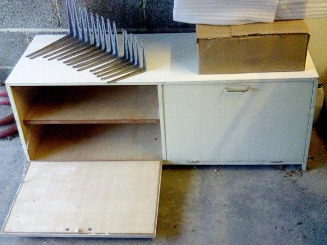

I need to fix this to a garage wall, but it's very heavy and am not sure if the brackets I have are sufficient and what wall fixings I need.
The blocks are at least 35 years old, so I presume they're proper breezeblocks.
The cupboard is about 140 cm x 50 cm x 50 cm and mostly solid wood or something pretty heavy.
The brackets are very old but in good condition (bit of rust on some of them) and are true as I've measured them with a set square.

The back is flush, but its very thin board - 4 - 5mm I think:

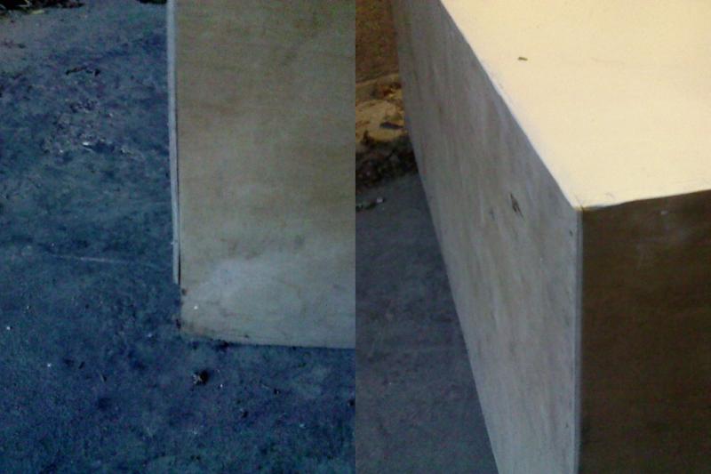

and this is the base:
It has to be raised a few feet from the floor. You don't think brackets would be best? I'm worried it could come down if I just secured it by one top internal baton, with the whole cupboard sitting on top of another baton on the wall.

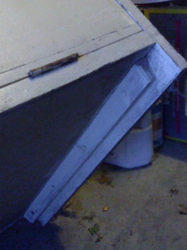

It was originally on the floor and probably made for the floor, but I want to put it on the wall and free up some garage space.
All the sides look to be solid wood or at least some dense plywood, but the back is pretty thin.
I think the back board has just been nailed onto the back edges of the four sides.
I can't tell how the top, bottom and sides have been attached to each other, as they'll all painted, but I think it's pretty well put together. I don't fancy going to the garage right now in this weather to check :)

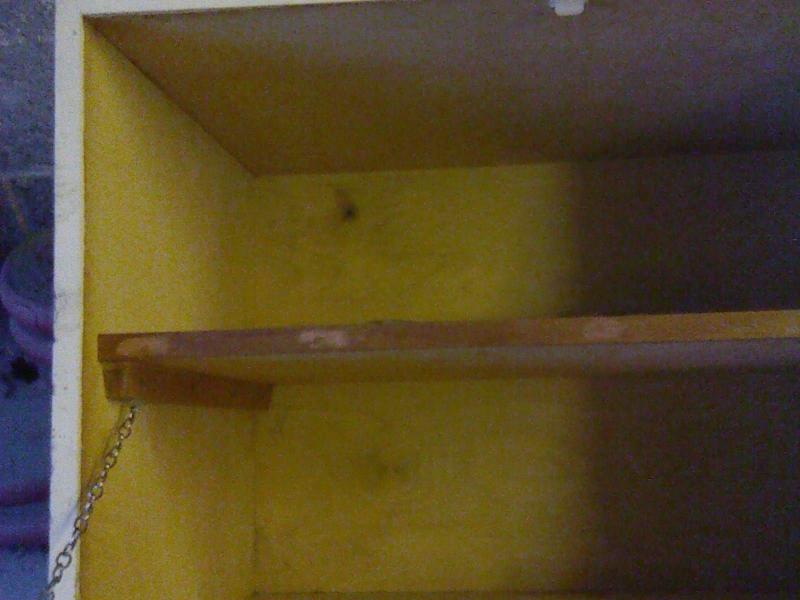

I've tapped all the sides all over and they seem solid, but can't see how it's been assembled. I've marked in the picture below where I think the joins must be:
The sides are 17mm/²/₃in thick. I think thin ply has been added to all the surfaces to conceal the joins and screws/nails and finishing strips added to the front ends and shelf edge, but however it's been done, it seems solid.

put a baton at the top inside then another baton from the shelve up to the baton each side inside 2 screws through the back into the wall and 2 or 3 through the side into the baton plus 1 into the top baton then i would be 100% happy it wont go anywhere as the side will now be fully supported in its own right into the wall
dont forget the baton under the bottom back edge underneath as well
it will now be as strong as it would be on the floor
i normally use brown plugs a 6mm drill[1mm small]
if you are using 20x44mm[2x1"] for your batons then 18mm+3mm+38mm in the plug so 60 or 70mm x5mm screws or 2 1/2"- 2 3/4" number 10s screws
drill the hole 1 3/4" or 45mm into the blocks
if any plug is loose knock in 1/4 or half off a brown plug into the middle or around the edge off the other plug
