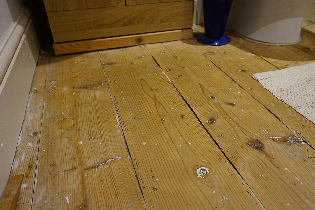

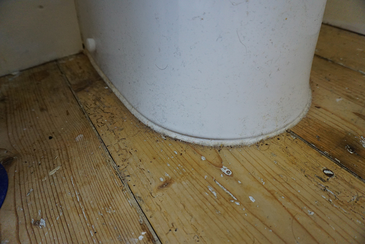

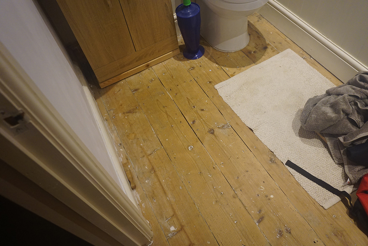

Hi guys
I spoke to a handyman last week about sanding/filling/varnishing my bathroom floor (its only about 3 x 2 metres).
He said that it may be faster - and look nicer - with vinyl/laminate flooring. He can cut it to fit around the toilet/sink etc...
A few questions:
- what would you do? sand/varnish the original floorboards, or lay down new flooring?
- should I ask him to put some sort of beading around the floor to hide the cuts that he'll be making from the vinyl? Or would you use decorators caulk or something?
- what flooring would you suggest? (I know I want wood-effect rather than tile-effect.) Would you choose vinyl, laminate or some other type? Are there specific types for bathrooms? Because the floor space is minimal, I dont mind spending a bit more per square foot to ensure its watertight. (sometimes getting out of the bath/shower there are inevitable puddles)

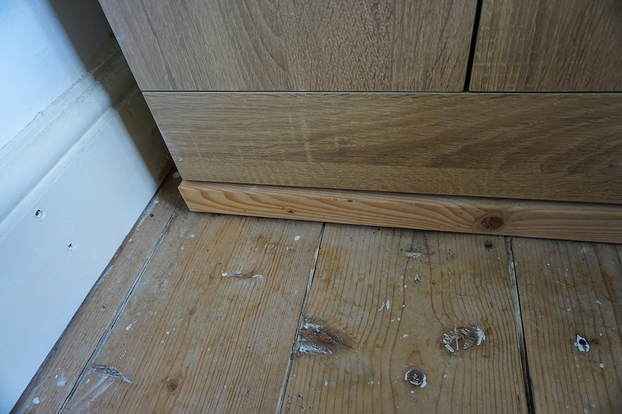

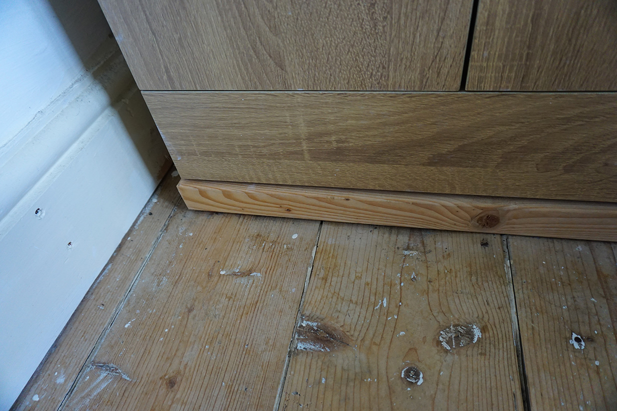

I cant see an obvious way to lift up the toilet/vanity unit?:

Just wondering, why is there so much paint on the floor?
View attachment 259572 View attachment 259573
It sounds like its pretty essential to fit the flooring underneath the toilet/vanity unit (expansion gap). I will tell him thats whats required.
Remove the plastic caps at the side of the toilet and you'll find 2 screws.
Remove them and your pan should be free.
Inspect the cistern, some are integrated and screwed to the wall.
Anyhow, that fixing system makes things even easier.
