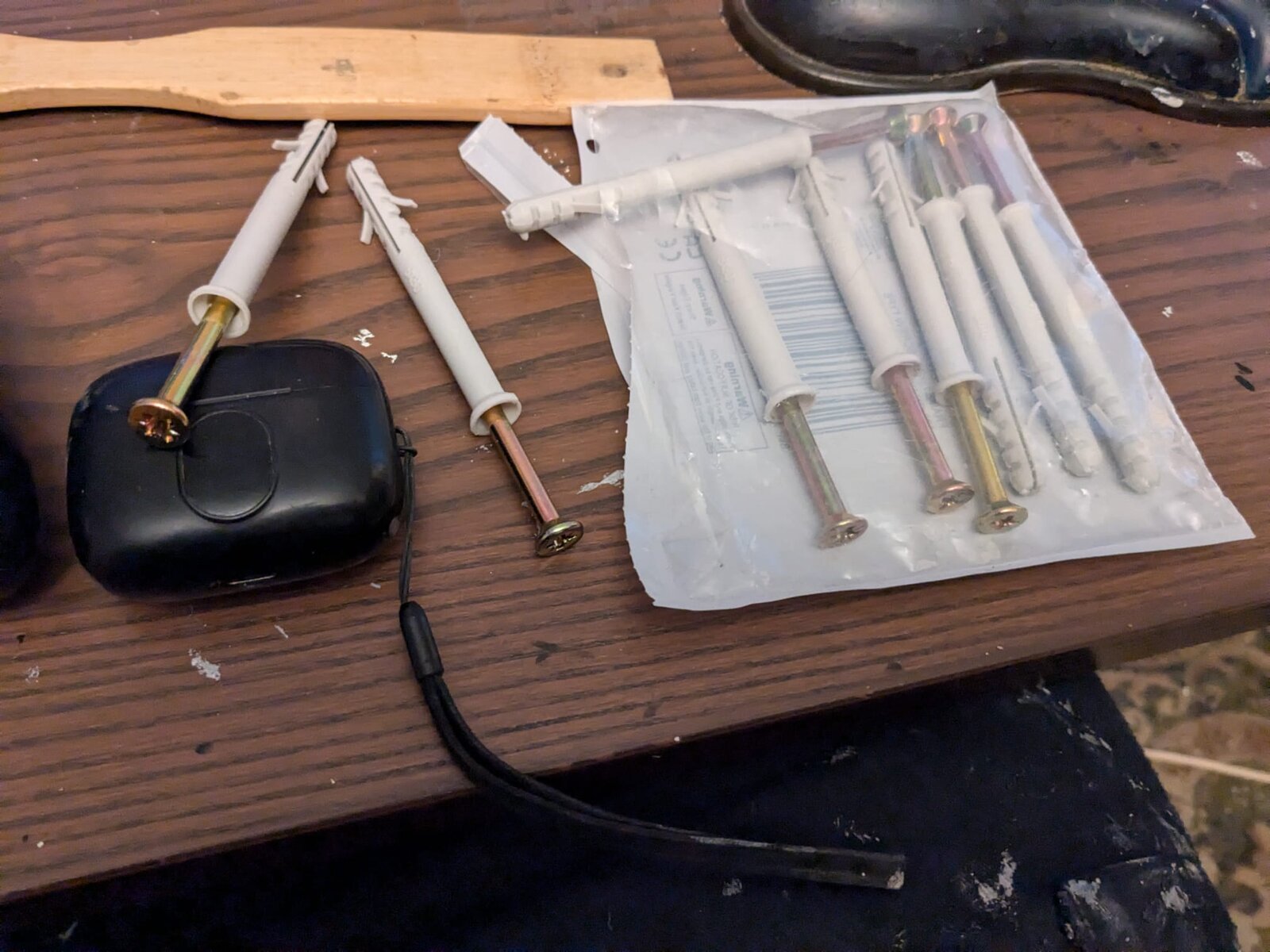

Since its clear that i've not been drilling deep enough, i have just taken delivery of a set of 8x80mm screws and plugs
They are CHUNKY, this might be too much. Is there such a thing as too much? Are there any downsides to drilling excessively deep

Show us pictures of what you have bought, fixings wise, and what you're aiming to fix to the wall

in this particular instance i was fixing a shelving unit on the ground, so these screws are just to stop it sliding away from the wall, not load bearing. But they have done the job admirably! These shelves are definitely not moving now
Someone mentioned above that screws should go 40mm into masonry, does that sound right?
I figured its better have more than less, and also there is the plaster thickness to consider, so i doubled that.
i only got 12 of these, i'm probably gonna use a few more of them for putting curtains up later this month
Are they excessive? If so, should i get some smaller ones?

Oh, no, they aren't 8mm screws - the screws will be more like 5mm and the plugs are 8mm (need an 8mm hole)
The general rule for screwing an item to a substrate is that the screw length should be at least 3 times the thickness of the item. In cases where you have some soft layer to get through first, you remove it from the equation..
So if you have a 20mm thing to fix to a hard wall, seek a 60mm screw, 40mm of which will be in the wall.
If the wall has a 30mm layer of soft plaster, use a 90mm screw: 20mm in the work item, 30mm to get past the plaster and 40mm gripping the brick inside the wall

My bad yeah the plugs are 8mm, thats the drill bit i used for them, no idea the size of the screws inside, but i guess that sounds right
