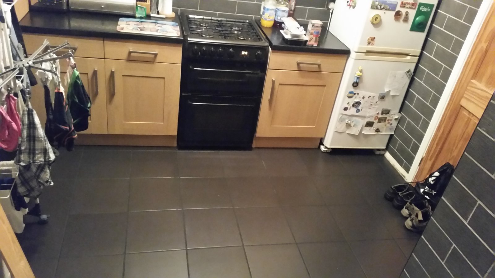

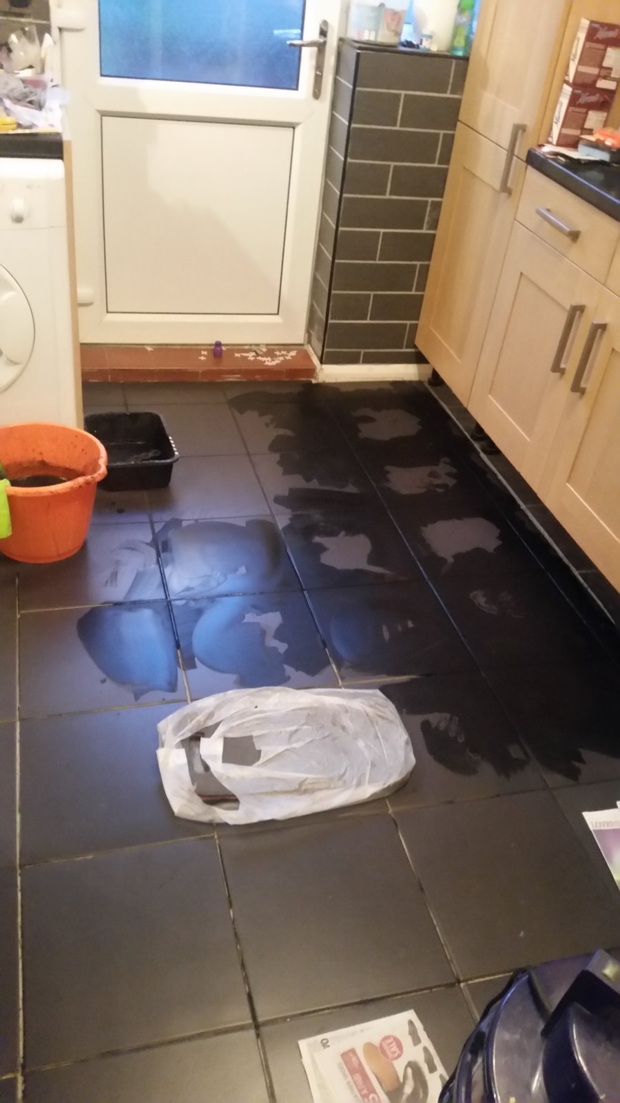

I got up to 20mm at some points in our kitchen. Used hand mix cement based tile adhesive (was a killer mixing it!).
Suppose you have to weigh up pros and cons but at 10mm I'd happily level with correct tile adhesive as well.
