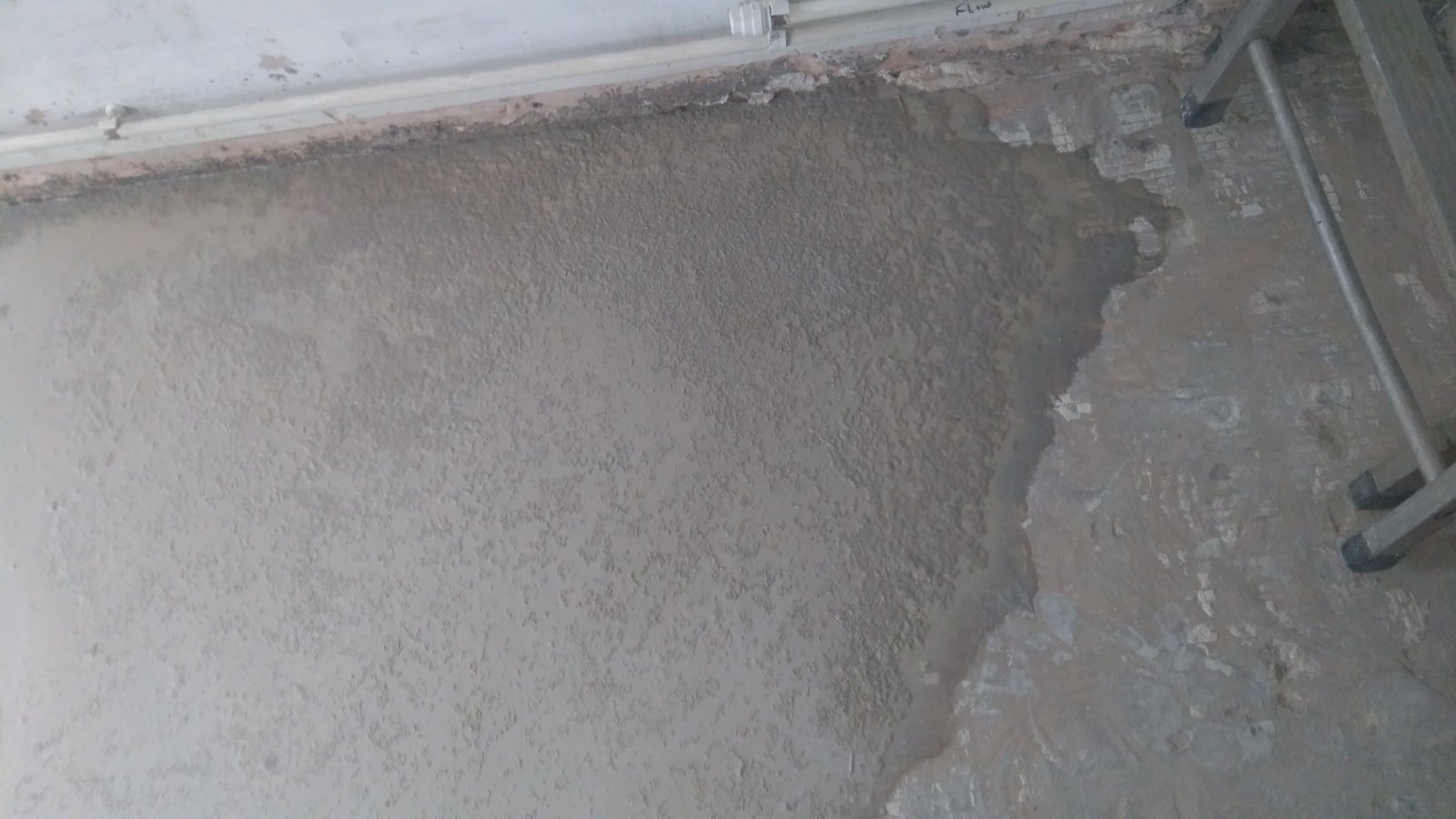

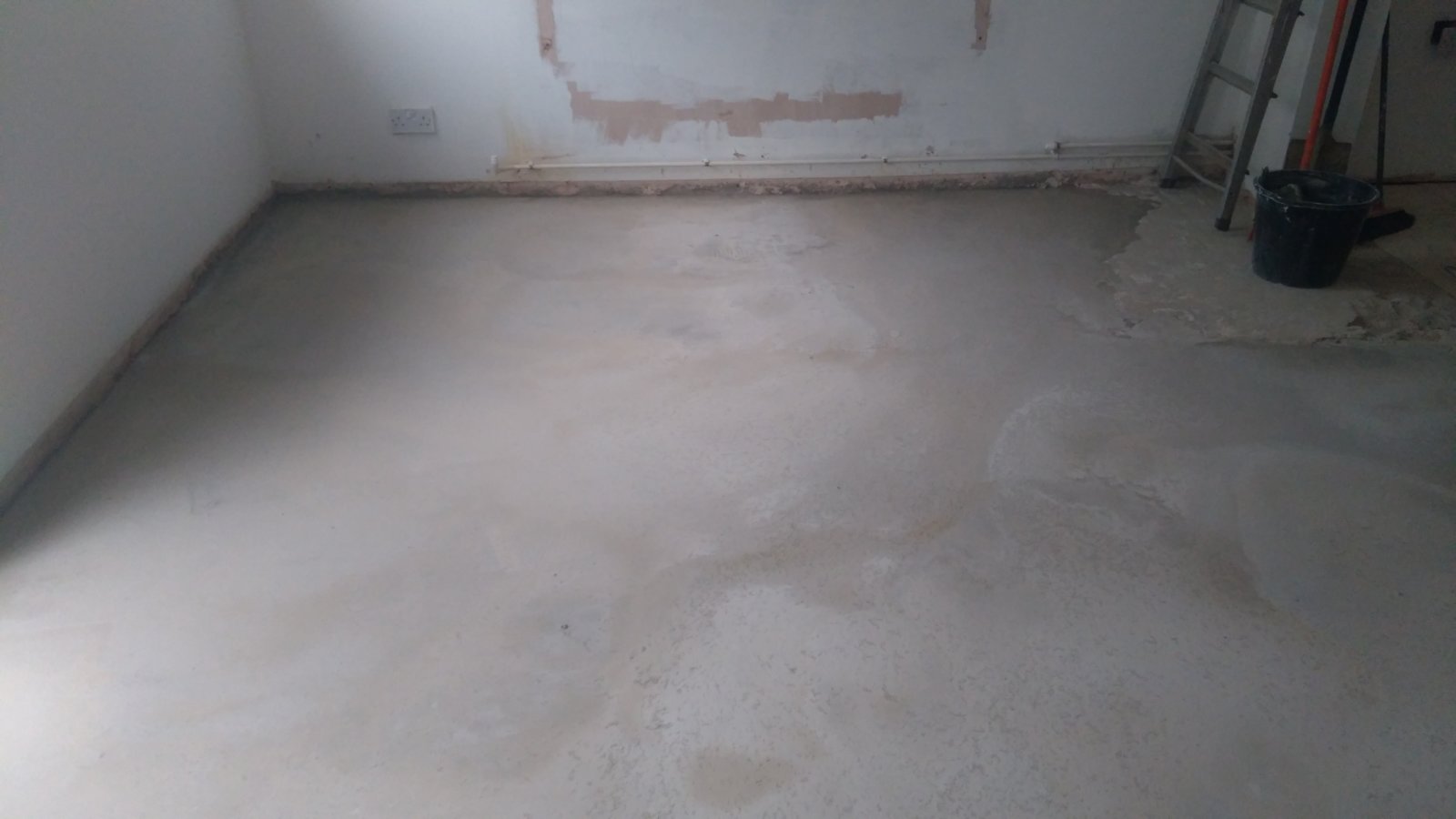

We are in the process of tiling our kitchen. The kitchen is half floor boards which have been overboarded with 6mm cement boards
The tiles are 120x20 rectified plank tiles
The other half is a concrete floor
Total area 3.35m width by 6.87m length
Electric underfloor heating is also being installed throughout.
We've noticed the tiler in some areas of the floor primarily on the concrete side has used up to 30mm of tile adhesive!
We questioned this and were advised it is due to the floor not being level hence why less adhesive has been used on the cement board section but more adhesive is required to bring it level on the concrete side
Is this acceptable? If not what would be the correct method to address an uneven floor?
Our concern is that given 30mm adhesive has been used will the underfloor heating still heat the floor?
The floor levels should have been sorted before any tiler was brought in or any ufh installed.
We've got another tiler in who has started to level the floor.

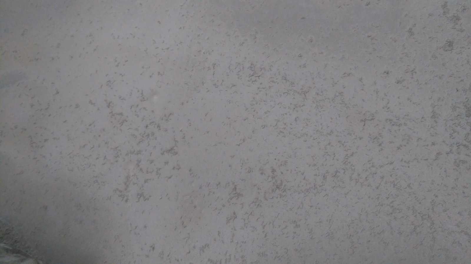

However we have some serious concerns with the appearance of the screend after 24 hours in some areas the floor has not dried and the fibres of the product have come up above the surface!
I have contacted Mapei and sent them over the pics attached who have advised it appears to that too much water has been added to the mix!
They cannot advise if this has compromised the integrity of the screed
The product used was mapei renovation screed 3240 Does the screed look ok or does it need to be removed and started again?

Self levelling looks ok to me.
Fibres showing is normal.
Never used mapei, i use bal which can go up to 80mm.
However, for unknown reasons some patches dry quicker than others.
I always leave 3 days before tiling, although I don't think it's necessary.

That's reassuring, what worried me was in some areas it has dried and also the fibres are not evenly spread across the floor
I sent the pictures to mapei who said it looks like too much water may have been used which worried me
Once this has dried, is it worth priming the floor?before putting down the underfloor heating and then followed by another layer of self leveller? Thats what the tiler is planning on doing
