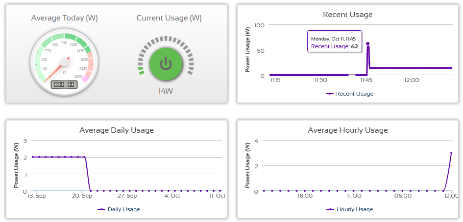

I noted last few times car moved it seemed a little sluggish to start, so decided prudent to put the Smart charger on the battery to top it up, since I can, I used the energy monitor on the Smart charger, and the charger showed 12.4 volt when connected, which does point to discharged battery.
The smart charger has 5 rates, 3.8A, 3A, 0.8A, 0.1A and zero, each stage is selected by battery voltage, 12.8, 14.1 and 14.4 volt, so 3.8A completed at 12.8 volt, 3A at 14.1, 0.8A at 14.4 and it will alternate between 12.8 which it if drops to that point will up charge rate, and 14.4 which once reached drops charge rate, there is a pulse charge from 7.5 volt to 10.5 volt and under 7.3 volt it assumes it is a 6 volt battery.
So quite simple really but it is called "Smart" as it is suitable for valve regulated lead acid, also called absorbed glass mat. The computer display shows charge rate
It shows the last time I charged a battery with Average Daily Usage, it shows charge rate now 14 watt current usage, and with the recent usage you can see how long it took me to transfer from spare battery to car battery, and the start charge rate of 62 watt and also with the program other dot shows 56 watt rate when dropped to 3 amp and then the 0.8 amp rated (14 watt).
When the charge rate drops to 0.1 amp I will consider the battery fully recharged, and I can see when this happens from my bedroom on my laptop, there is also a LCD display on the charger, but when the car charger with my wife's car (Jaguar XE) works out how long it has been standing for and does things like disable the stop/start if battery not tip top, can the simple Lidi charger really be called "Smart" when compared with charging system built into the car?
The Lidi charger does have 'Self-Monitoring, Analysis and Reporting Technology' when combined with the Energenie MiHome energy monitor, but which device is the "Smart" device?
