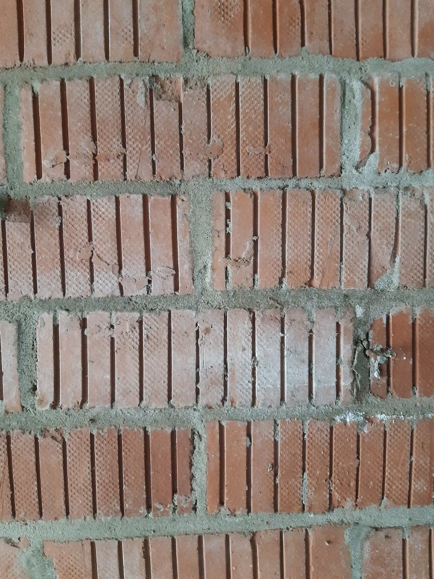

Thank you all for your replies. Taking photos on my old camera and trying to upload has been a nightmare, for me anyway.
I’ve had to wait until my son was here and he’s sorted these for me. Here’s the garage brick, inside and out, a single brick layer doubling up at the corners and halfway down the inside.

Forgot to ask - and might be useful to know with regards to us spending your money.
1) How many holes do you need in this wall (1, 5, 10, 50, >100)?
2) How often are you likely to use a drill again (never, yearly, monthly, weekly)?
3) What's you budget (skint, DIYer, Looking_to_get_into_trade, Want_Lots_of_tools)?

Or Lidl have a very capable battery version, complete with a set of bits, for £24.99. Hammer/no hammer, forward/reverse, variable speed, but single speed gearbox. You cannot hammer without rotation, which is sometimes useful. That comes without a battery, or charger, so another £20 / £25 for that. Manomano has the same drill only unit priced at £104.

I have a really big drill, had it many years, only used when it was bought, I got that out and tried but when I attach a bit and set it to hammer, the bit, shakes like crazy. I think this is an SDS drill. I’m useless with pictures so I’ll get the name from the box it’s in.
SDS drills have a spline arrangement to secure the bit into the chuck rather than the parallel shank plain round drill bit, where you may use a key to secure it.
SDS plus is a refinement of the original design, SDS Max is a big diameter version.

SDS drills and bits are unmistakable for any other type. The shanks of the bits are all the same (SDS+), with a groove in the shank to latch the bit in the SDS drill. The chuck is completely different too - An SDS chuck is pulled back to insert or remove the drill bit and the bit simply clicks into place. No chuck needing tightening.
SDS is the much larger, heavy duty size, SDS+ is the smaller most common size, but what most people use. When say SDS, they are usually referring to SDS+ size.
It's possible you have not locked the bit in. Can you pull it out?
