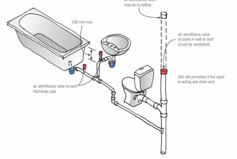

I think it may be time to open a few bits up just to get a better understanding of how you system is set up. It isn't bog standard as per modern standards if its using a secondary vent setup, so it would certainly be of benefit to understand how it's all run and joined together.
I should have said that it's "vital" to deal with the problem somehow. Tall buildings still often have a supplementary vent. But commentators are correct, self sealing traps, anti siphon traps, Durgo air admittance valves etc etc are usually used instead.
I've not seen a crazy web like that picture on a 3 storey bldg, but wanted to suggest the reason.

You would always want any AAV to be above the highest spillover level of the highest fixture it is connect to. Why I didn't suggest an Antivac bath trap.
If the AAV is placed anywhere other than close to the bath trap, then shallow bath trap seal could still be pulled if the bath empties quickly. All needs tested though.
