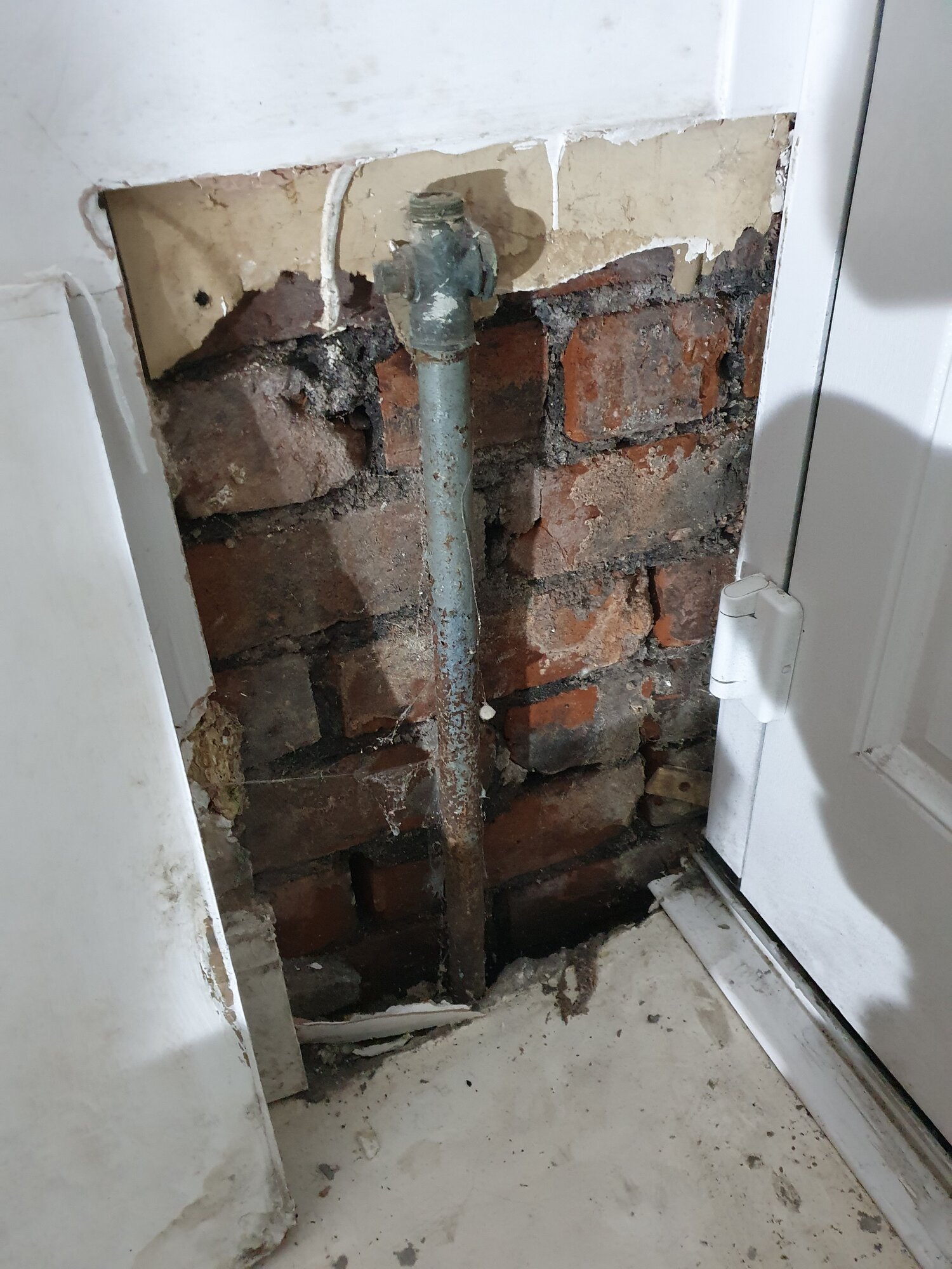

This is behind some boxing behind our front door. We're having someone come out to install a new floor for us and I would like rid of this prior! Is it an old gas pipe? If so would I get a gas safe engineer to cut it down and cap off below floor level? Thanks!
That looks to me like the incoming gas main with an Emergency Control Valve (ECV) on it, minus its handle. If so, unless it is a subsidiary ECV then:
1. It should never have been left like but should have been capped off (whether subsidiary or not).
2. It will require someone like Cadent to make it safe and remove it.
3. You will, I suspect, be looking at a large bill for this work, which can't be done by a gas safe engineer as it is on the board's side of the (missing) meter.
Oof, that's confused me! I'll leave it as it is if it's very expensive. I just wanted it lowered below the floor. It's inside the house on the left of the door. The gas meter is outside the house, on the right side of the door.
Yep, as per @oldbuffer, a disused incoming supply. I would say it could be just cut off. Might have to be Gas Transporter though. Don’t think it’ll be expensive, if any cost.
Sally, this pipe could be an old redundant gas pipe, a gas safe engineer be able to check for you.

It would be better if she asked the Gas Transporter, a gas safe engineer will only check via what would have been the handle, or if it’s open ended. If the Transporter is involved, they can advise on what to do next.

If you call the Transporter (Cadent?) they will visit to do a "dead test". I am 99% sure that this is free visit (ask to check) - especially if you tell them that t is an uncapped Emergency Control Valve (ECV). Supplying that detail may speed the call out response.
The number to call is 0800 111999

yep its an old service pipe to the house and cadent will do a live or dead check for free .phone the number fireman put . if you want them out within 1 hour you could say you think you can smell gas from it ;)
Thanks all. Wales and West coming out tomorrow to do a free dead test. Very efficient! Fingers crossed for dead and I can just rip it out
You will struggle to have it properly capped off below floor level. Technically, any old gas pipe should be capped, though. Ask the engineer who comes out whether it can be cut to floor level and filled with a sealant (maybe FJC). Whatever you do, do not cut and leave open. if it is open at "the other end", it would be an access route for vermin.

My cats would love that. Me, less so. I'm not wanting an old pipe sticking out of my floor, ideally, and the boxing in is awkward behind the door. If it's dead I can hack out that concrete (thin layer over brick) and hopefully cut it down lower. This are will be tiled, eventually. Good tip re filling in with something non-chewable! I'll keep you posted.
