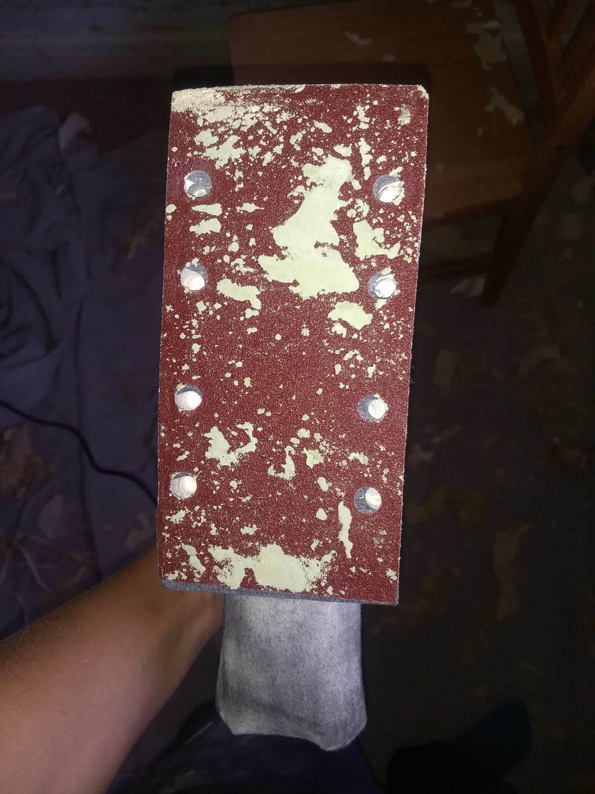

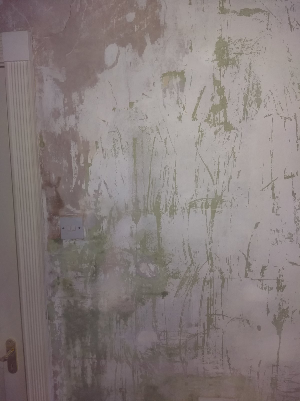

I stripped this wall, and I'm now sanding it.
But what is this green gunk that is sticking to my sander? Sticks to my fingers to, when I touch it (although washes off)?

I think I know.
Was your house built before 1940?
Distemper.
Can be washed off with hot water but not with cold.
Has a distinctive unpleasant smell because it is made from whiting and colour bound together with a glue made from boiled up hooves from dead horses.
Not noticed the smell (it's a tiny tiny patch), but having read your reply and googled it, I think you're right. I think it is pre-40's
Thanks; great info!
If you have a steamer ,you can steam the surface and sort of shave it off using a 4/6" blade scraper
