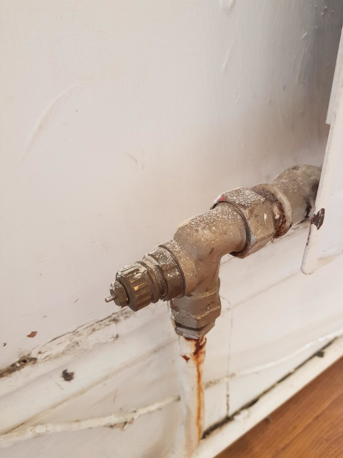

What is this on my radiator where the valve should be?
12 Apr 2020
466
All my radiators have either a thermostatic valve or manual valve, but this one I don't know whats going on. Can anyone explain?
Is it the same as other ones you have?
I have to other TRV radiators, but they are different and I havent taken off the heads as I wasn't sure how. So maybe tomorrow I should take them off and check if they are the same
Or just post a photo here and we can probably tell you
I posted a photo of the bit without the TRV head, but do you mean post a photo of the other ones? A guy above said Danfoss, which from googling seems like an old one
Yes, post a photo of one of the other ones

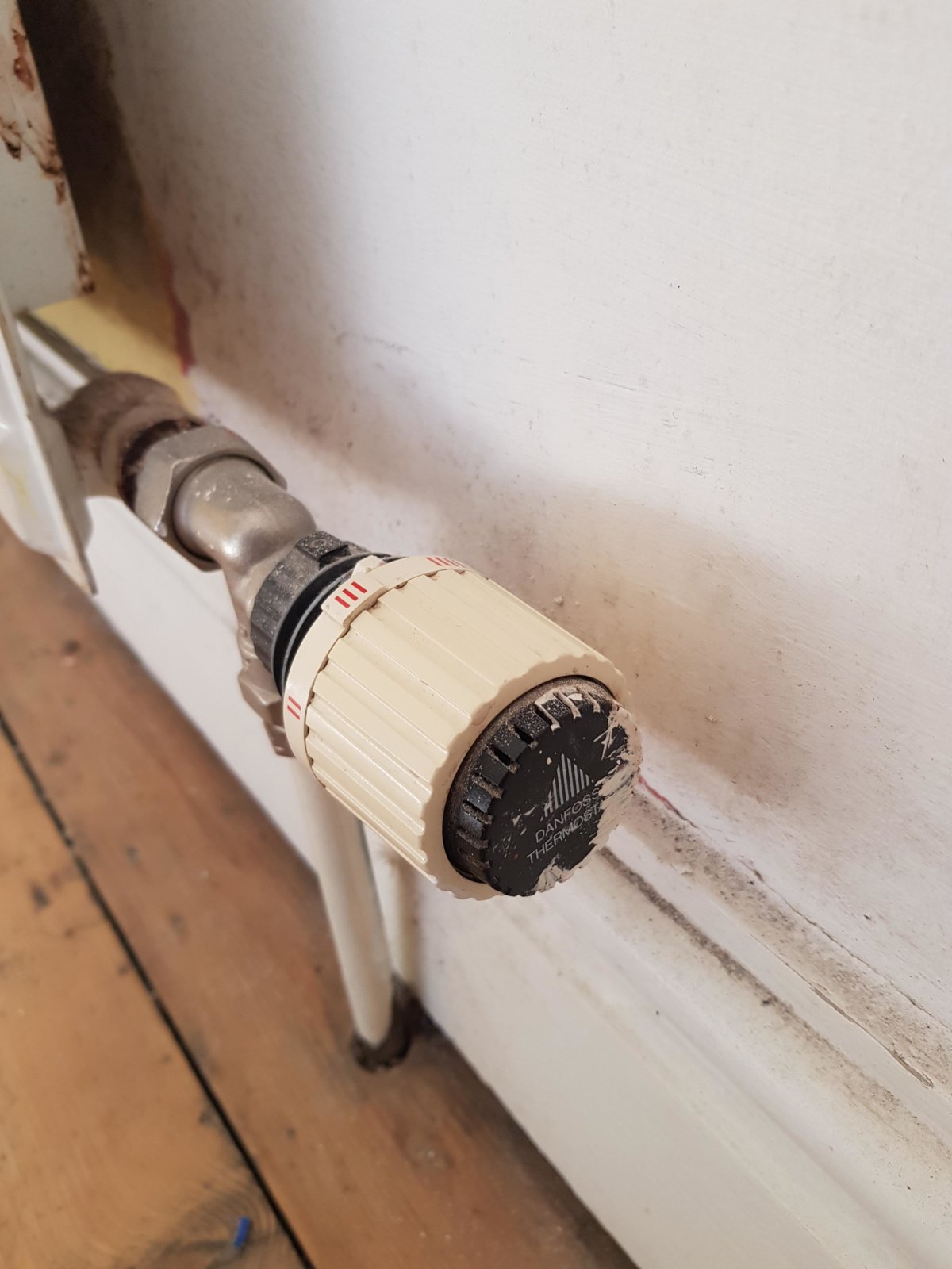

OK so it turns out the other two were the same, and are Danfoss as Vulcan said, photo attached! But any idea how I find a head that fits, as when I google it all kinds of Danfoss ones come up. thanks
Just send the photo to Danfoss and ask them... Its an old Danfoss Randall head but they may have newer types that will fit.
