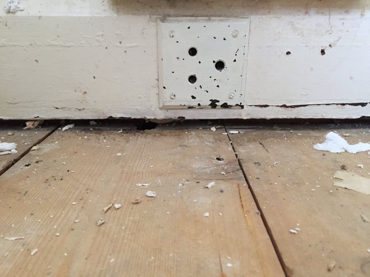

Hi All,
My Partner and I recently completed on a 1930's house which is in need of lots of work. We have come across these sockets on the skirting boards which we have no clue what they're for! Does anyone have any idea?
paste image host
They only seem to be in rooms with chimney breasts.
Possible they are sockets for ( flexible ) gas connections for gas fires that were not permanent fixtures.
Sockets for gas pokers? What leads into them ? Wires or pipes?
Thanks for the help.
It pipes

Cheers everyone I now need to find a way to make them look pretty as I think taking them out would be more hassle.
If the gas supply to them is still live then you will have to have the pipe work disconnected and capped off by a GasSafe technician before you do anything with them.
